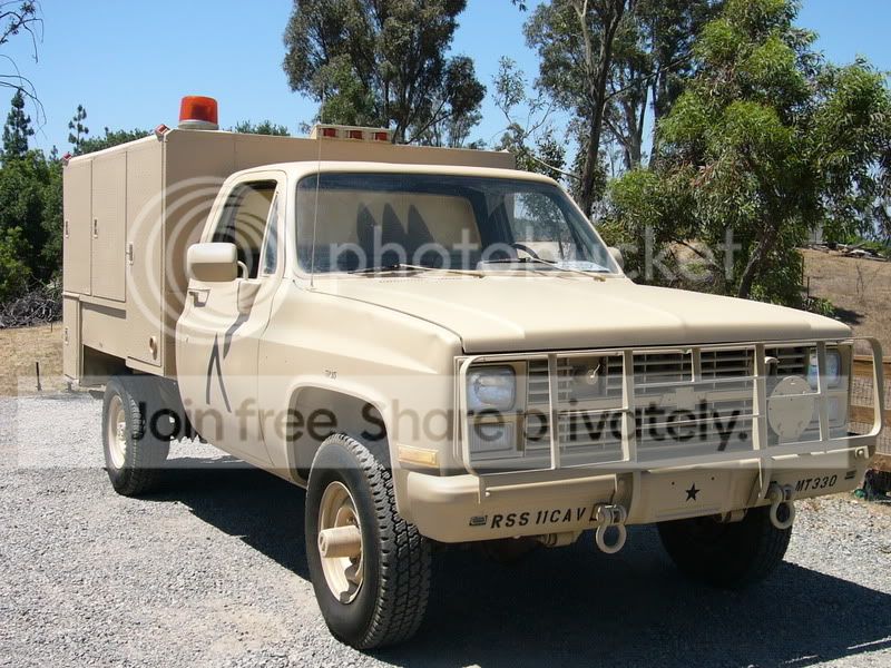

Been a while since I updated but its been busy around here! Got the truck running and driving, I had to break down and order the Advanced adapters bell housing and clutch kit to work with my NV4500. It was quite a bit more then I wanted to spend but the truck runs and shifts awesome! I have put about 5000mi on it in the last 4 months driving it almost everyday, it is a blast to drive. I have been tracking the mileage and city driving I have been getting about 10.5mpg which isn't bad all things considered... The current project is to pickup a Military Contact Maintenance Bed that I found and get it ready to install. Going to use it as a service bed for some of the side work I do but also want to start making it into a camper style bed. This is similar to what i'm starting with. (Image from Google) I'm also getting ready to re-gear my front axle and get a front driveshaft installed, that way it will actually be 4wd.

Pics of the "new" Contact Maintenance Bed that is waiting for installation. Not the ideal way to transport the bed but we took it slow and it wasn't a long drive.
Well over the weekend I was able to get the bed mounted with the help of my wife. It was a arse whooping but we got it done and for the most part everything is finished.

I am really happy with how ever thing looks and works, this bed weighs slightly more then the stock bed, I would say about 250lbs more. It dropped the rear of the truck about 1" from where it sat with the stock bed but it rides alot better! The bed does create a massive blind spot but I am working on a solution for that. The wheel wells are plenty big enough for my 37's and i dont see any reason 42's wont fit in there if/when I go to them.
