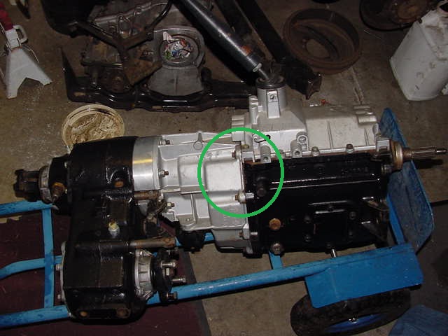

If you have a 4500 205 now what's your shifter configuration at the moment? Do you know if you can keep the 4500 in the same spot and put the cummins in and be ok?

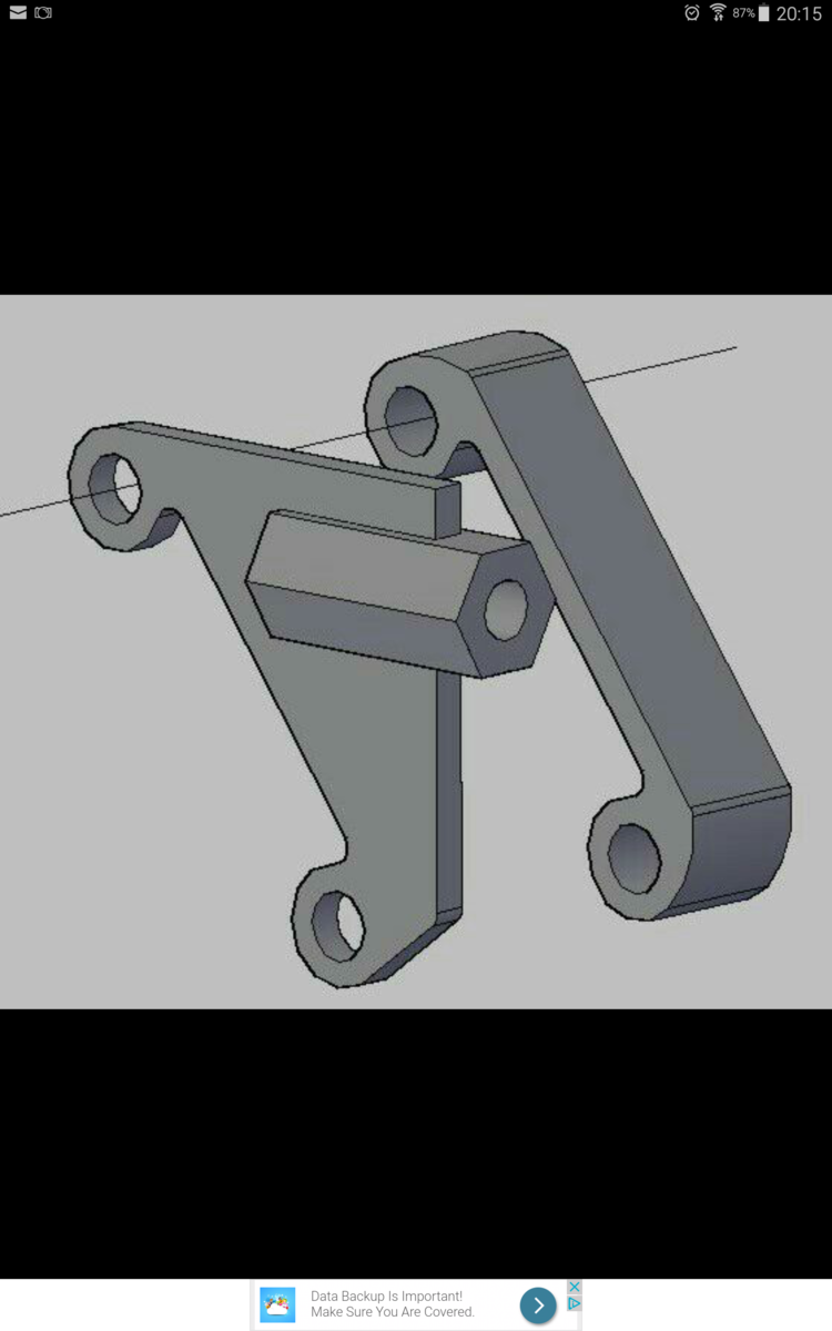

I built a mount that bolts to the front part of the transmission tail housing. I will try to find a photo of it. The mounting with the Cummins will depend on where I mount the engine, I can't go too far forward without hitting the radiator and I can't to too far back because of the firewall. From everything I have heard and seen it will probably move the transmission back about 2-3 inches. Hopefully not much more...
Here are the photos.
