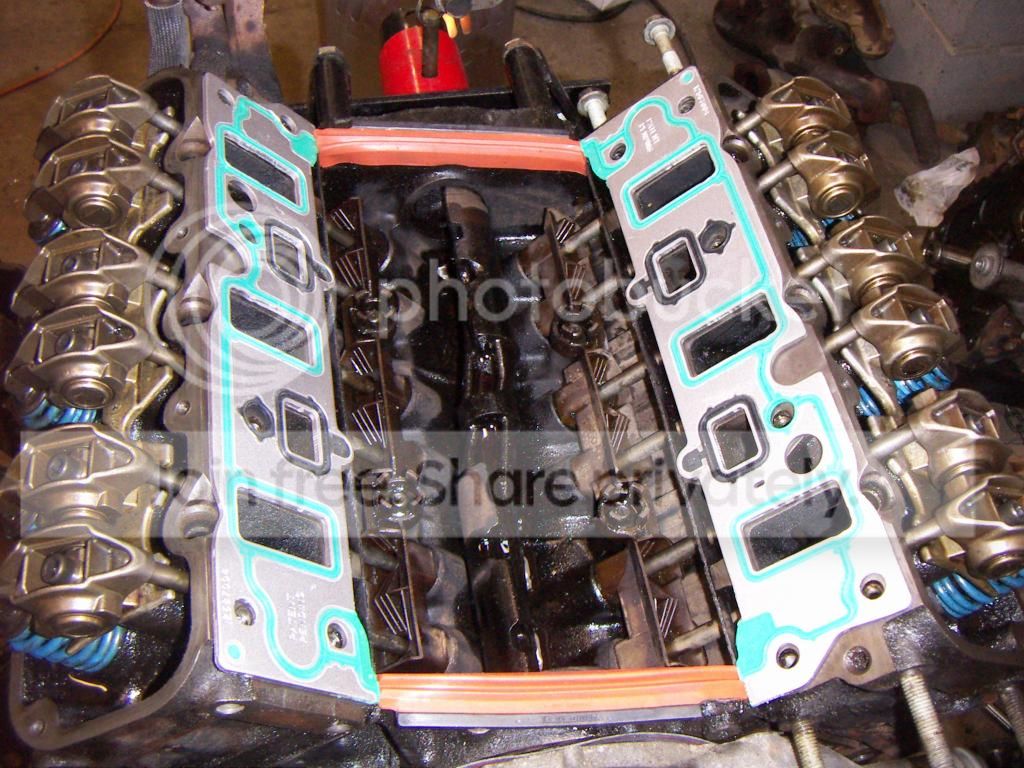

Here's the good lower intake gaskets from GM. The plastic ones always leak eventually.

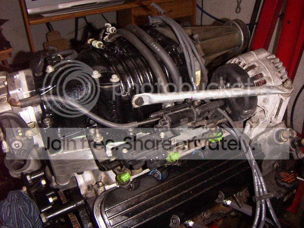

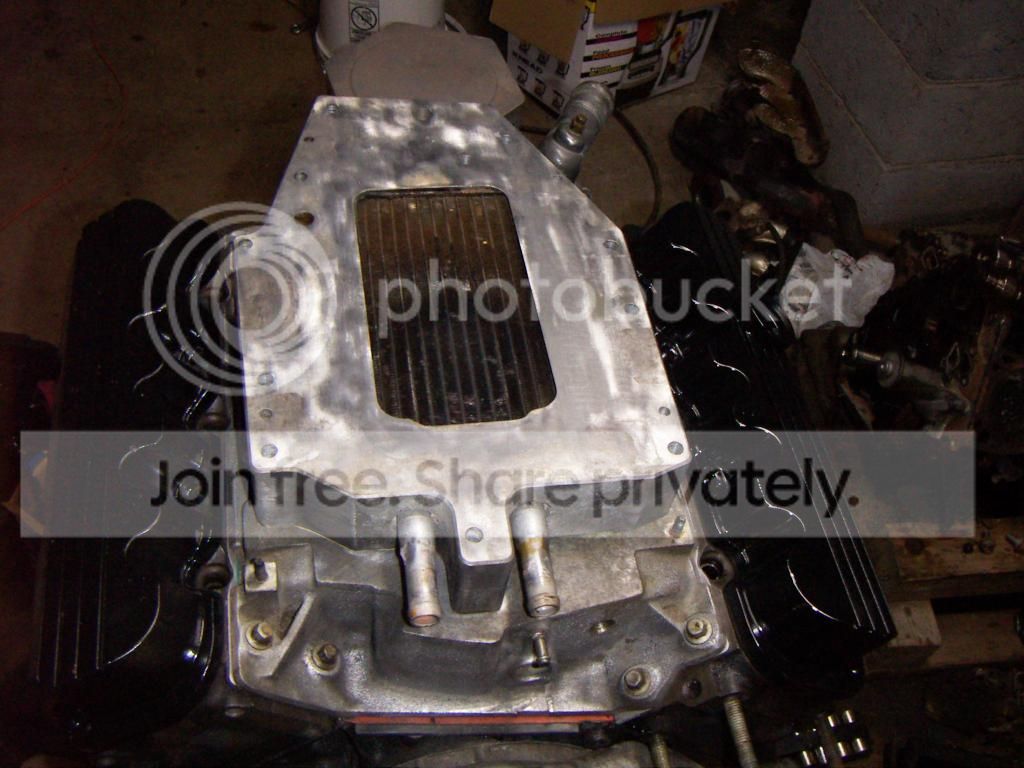

This is the machined intake manifold - the opening is enlarged to match the intercooler.
Now you see how the intercooler sits on the intake. I think the core is actually a heater core from some car.

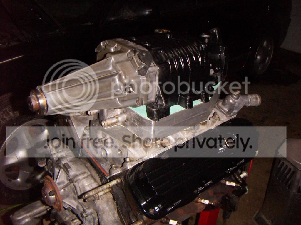

This is how the blower sits on top.
Very cool. The concept of them putting a roots style (I know its technically not but still) blower on a FWD car is still funny to me.

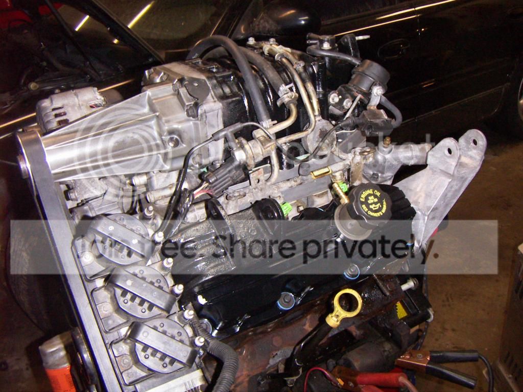

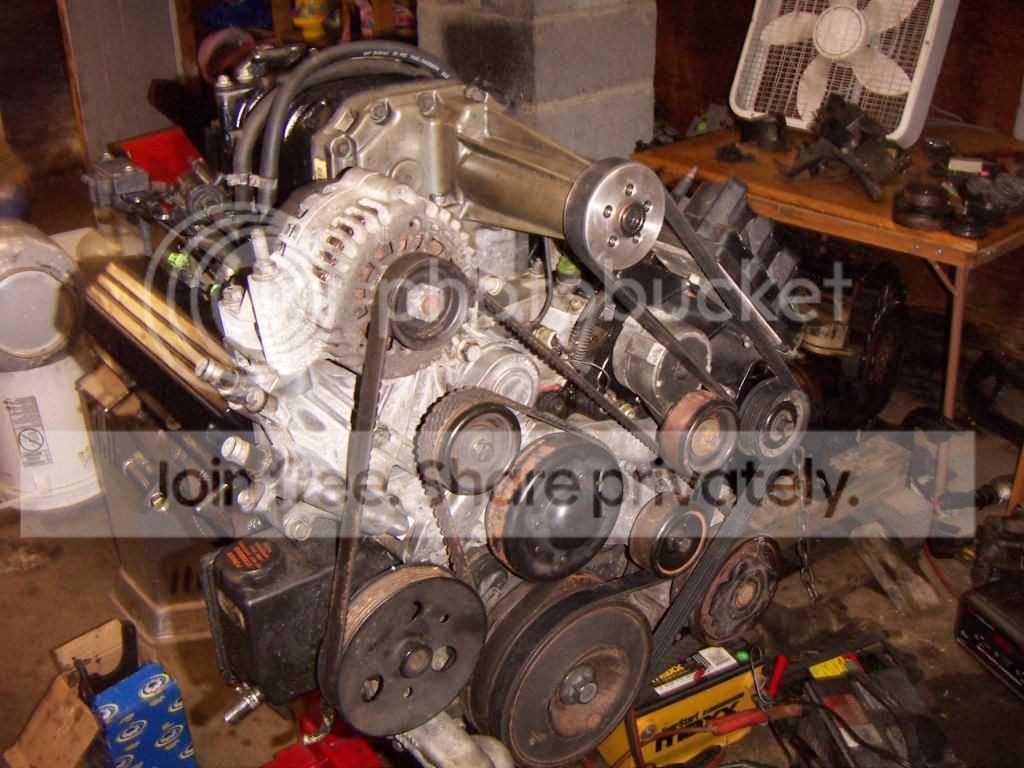

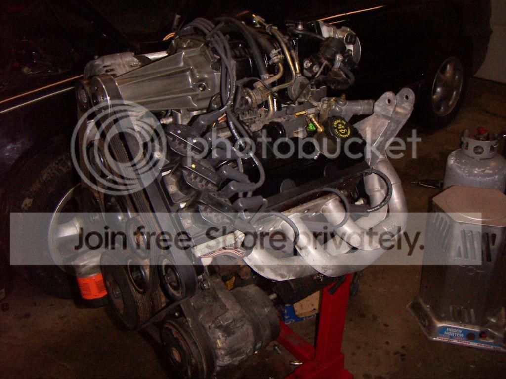

Made some progress today. The engine is basically assembled. I cheated on belts by putting on an undersize idler for the supercharger belt. When I get a longer belt I'll swap it back - this thing is super tight or I might just run it (the belt is for the 2.8" pulley and my new one is 3.1"). The A/C and PS systems in the car are sealed, with compressor and pump laying in the engine compartment, so this is just a mockup, but I need to get all the clearances right as the intercooler raises the supercharger almost 2.5". I had to mount the ignition module a little different to clear the belt, but easy peasey.

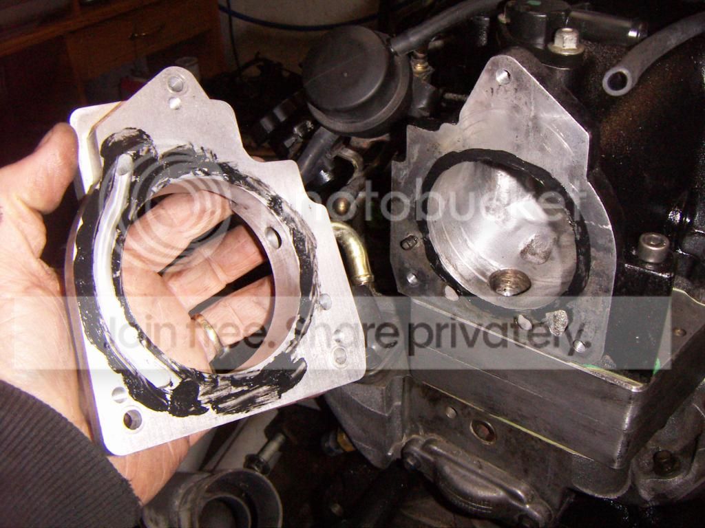

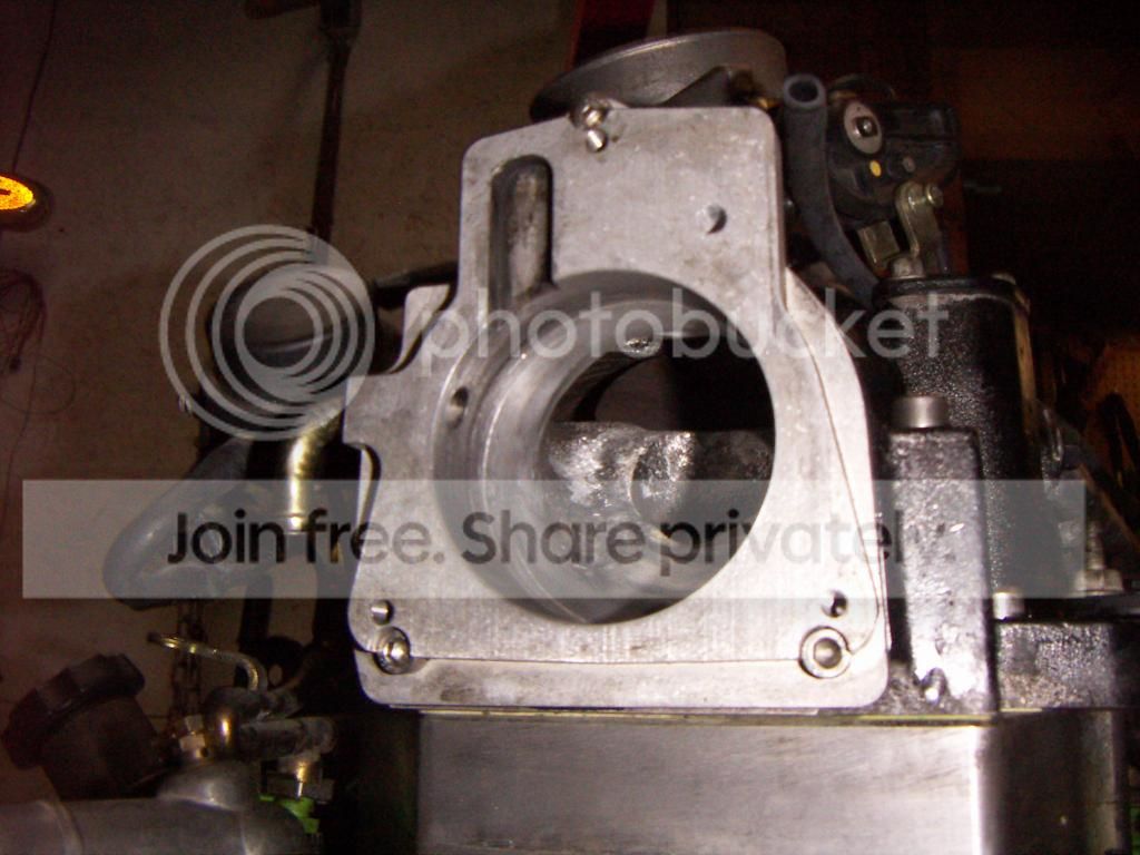

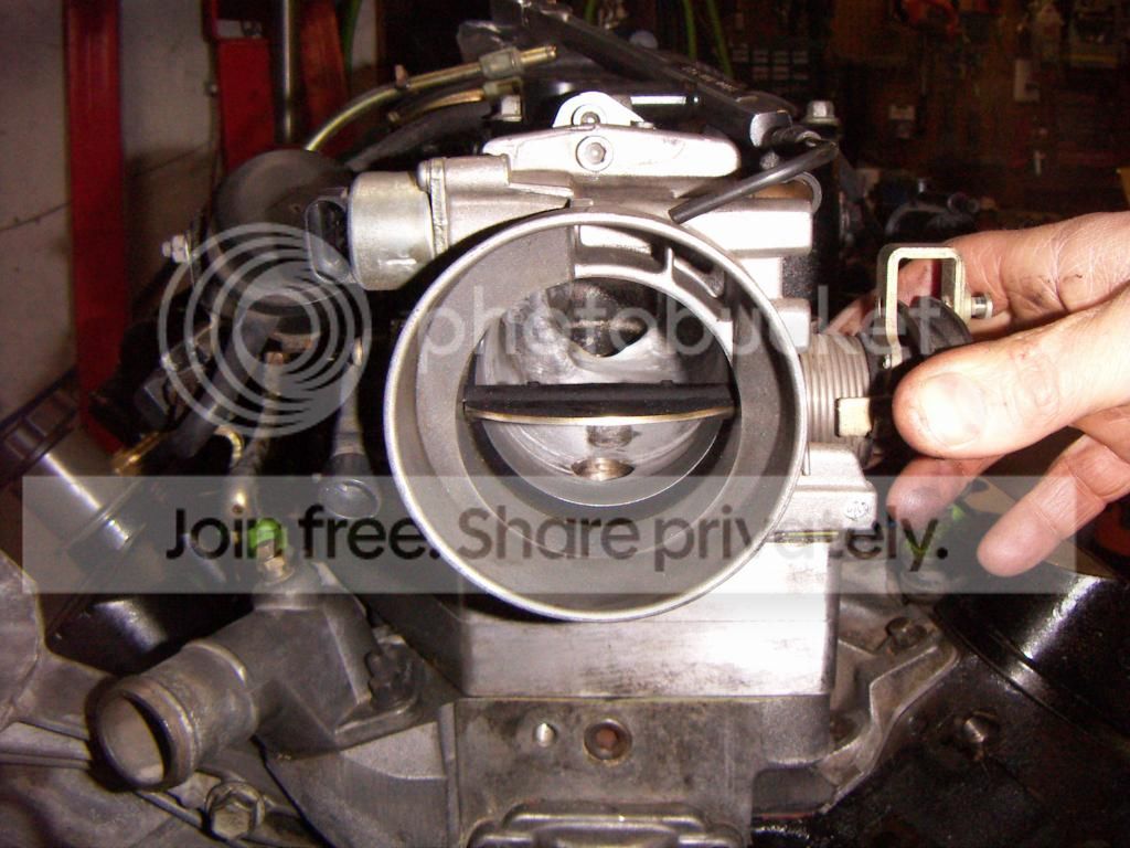

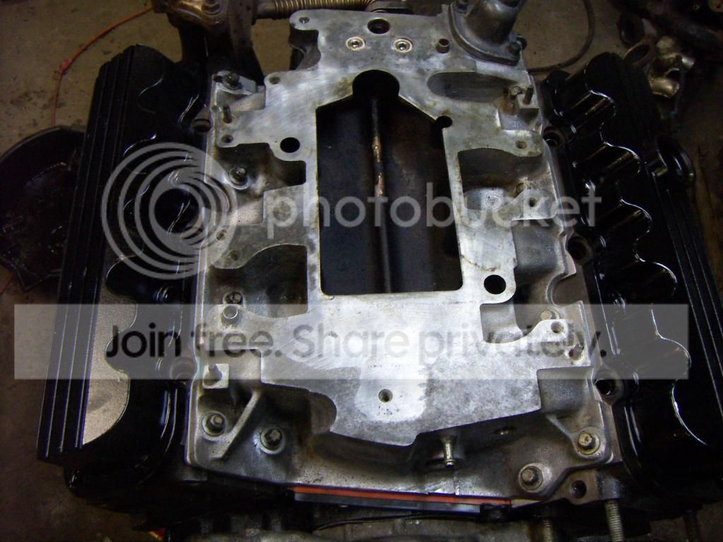

I got this adapter plate 2nd hand. It has both bolt patterns in it to let the Northstar throttle body bolt to the M90 (Gen 3) supercharger.
I opened up the inlet before I had the throttle body or the adapter, and fortunately everything lines up:

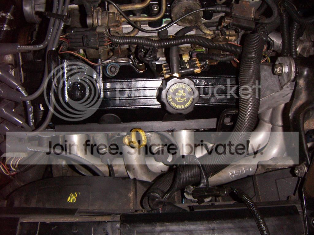

It seems a PO had discarded the alternator brace (since the intercooler changes the fit), so I am making a new one. You can also see how I mounted and connected the purge solenoid.

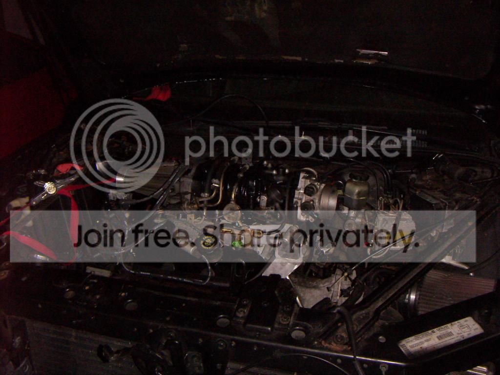

So it's almost ready to drop in:
I still need to come up with intake ducting, though.

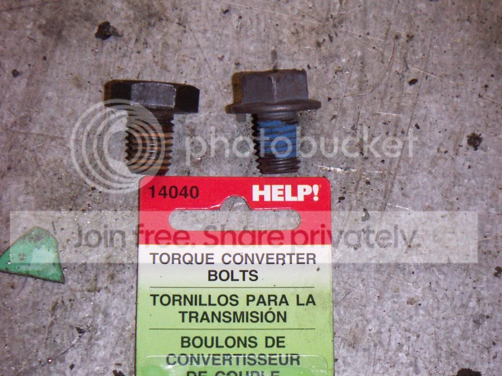

I only had 2 torque converter bolts, but found these at a local place. They do clear everything, but should I worry about the thicker bolt head based on TC expansion or anything?

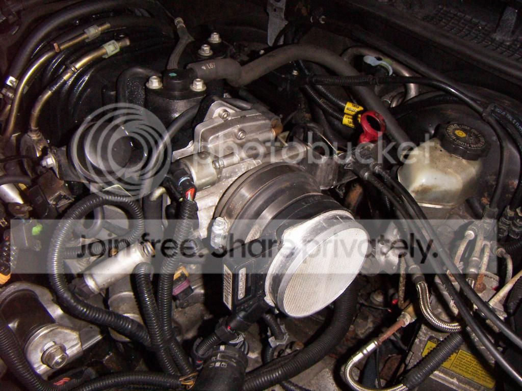

I managed to get the MAF mounted to the throttle body with parts on hand, but still need to build the rest of the air intake. Off the shelf intakes are like $200, but I think I can come up with something for much less. I may just block off an area underhood to force most of the air to come in through the fender hole. It's possible to put a filter inside the fender, but I don't know if it's worth the hassle. The car was running an "HAI", but I really want to come up with a "CAI". If intake temps don't matter, why am I running an intercooler anyway? Well, I guess if the intercooler was awesome enough the intake temp wouldn't matter - but why push my luck?

Got the front header installed. I'm certain the back will be much harder.

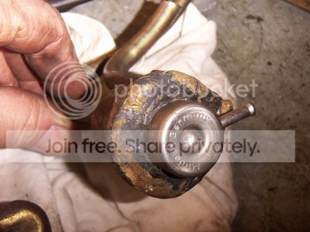

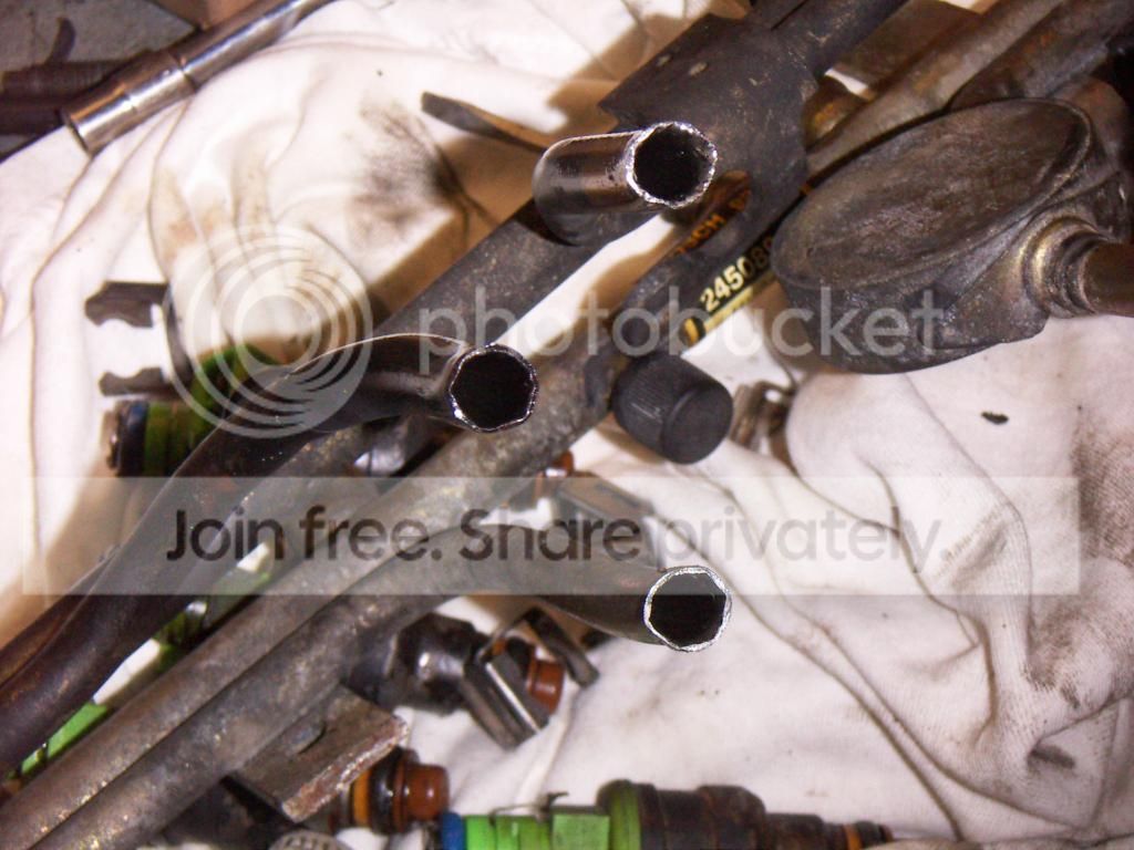

I never liked the looks of these cut fuel rails. I took them apart and have now decided to go a different direction for this.
Not dying is important. I should have pics tomorrow of a better plan.
