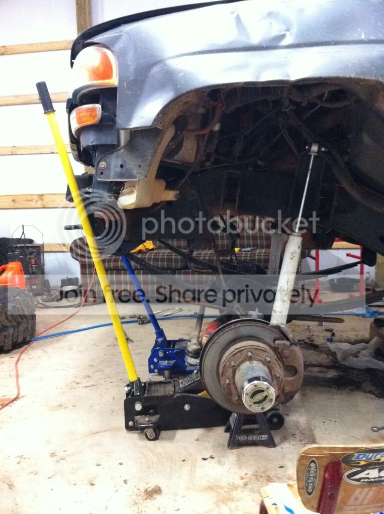

It looks to be about 19-20* on the C's. DIY's got a 10* shim that should get it closer. I'll probably use the shims to see how close it is and mill it if it needs more. I've got the axle unbolted and sitting on jack stands ready for the springs to come out. Thanks for the information!

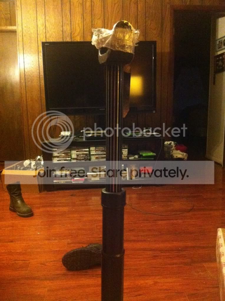

So I put an order in for the 10* shims from DIY last night. This good looking thing showed up today, too bad I cant put it in with the front end unbolted. Hopefully the rear shaft will be here soon.
The problem with downtravel is the axle is only 1" from the ground before it comes free of the leaf springs with my jackstands.
