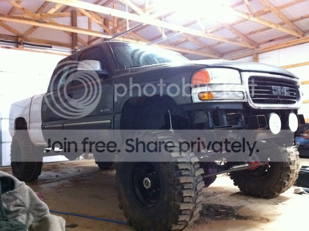

So this beautiful piece of metal showed up on the brown truck today.
Its a damn shame its going to go under the truck where no one can see it.
Excuse my dirty shop floor, I've been working instead of sweeping for a change.

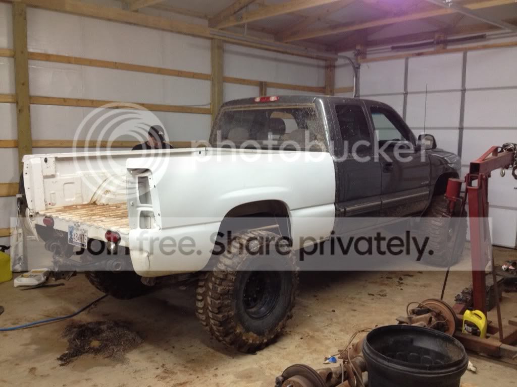

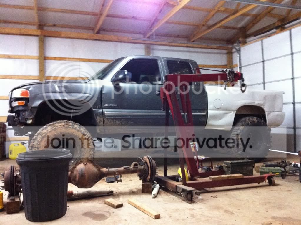

Well I got the carrier bearing mounted, driveshaft was too long. It was fully compressed in the yoke. Decided to cheat and add my zero rates in the rear and remove a spring while I was at it. Moved the rear end back an inch. Did the trick. Havent tested it at full compression, but it seems to have enough slip showing to handle the travel. The rear yoke was somewhat pointed at the carrier bearing, so hopefully the CV will be happy. The angle on the shaft looks good. Really hoping it will run nice and smooth. I was able to get the front part of the shaft within a few degrees of the powertrain as instructed by Jess, so that should be fine.
Used a borrowed cherry picker to check clearance. With the arm all the way in and the tire off. Got the rear up pretty high, ram bent. WTF. So now I get to buy a new ram for my buddy's cherry picker. Rear seems to flex more with a spring out of the pack. Flexed high enough to break the damn cherry picker anyway.

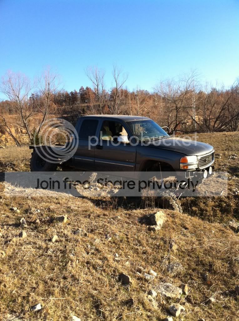

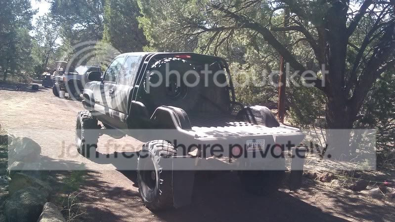

So I took it to a buddy's place Saturday and had a blast. Its like 600 acres and has two old rock quarries on it, a good size river and several creeks. I love going out there. Anyway, the truck gets around pretty good. I kept climbing ledges and different things trying to hang it up but it just kept going. It drags framerails but the belly is flat, so its not bad. I had the old 70 series put back on it, so its silent again. Not my style, but I did some trading with the muffler shop guy so it only cost 60 bucks to get the exhaust done.
I've still got a few small bugs to work out, but overall its great. I'm pretty proud of it, its been a fun experience building it. This is my first project that was more than bolt on and I've learned a lot.

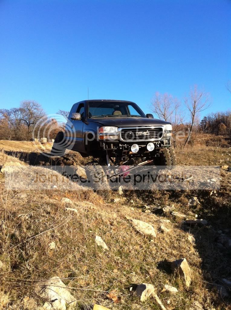

Anyway, here's a few pictures of it at the ranch. I had it in the river sand and climbed the bank a few times. No axle wrap like expected, but it likes to dig holes in a hurry. There was a hill that was about 5' tall and nearly vertical, went right up that too, didnt even spin a tire.

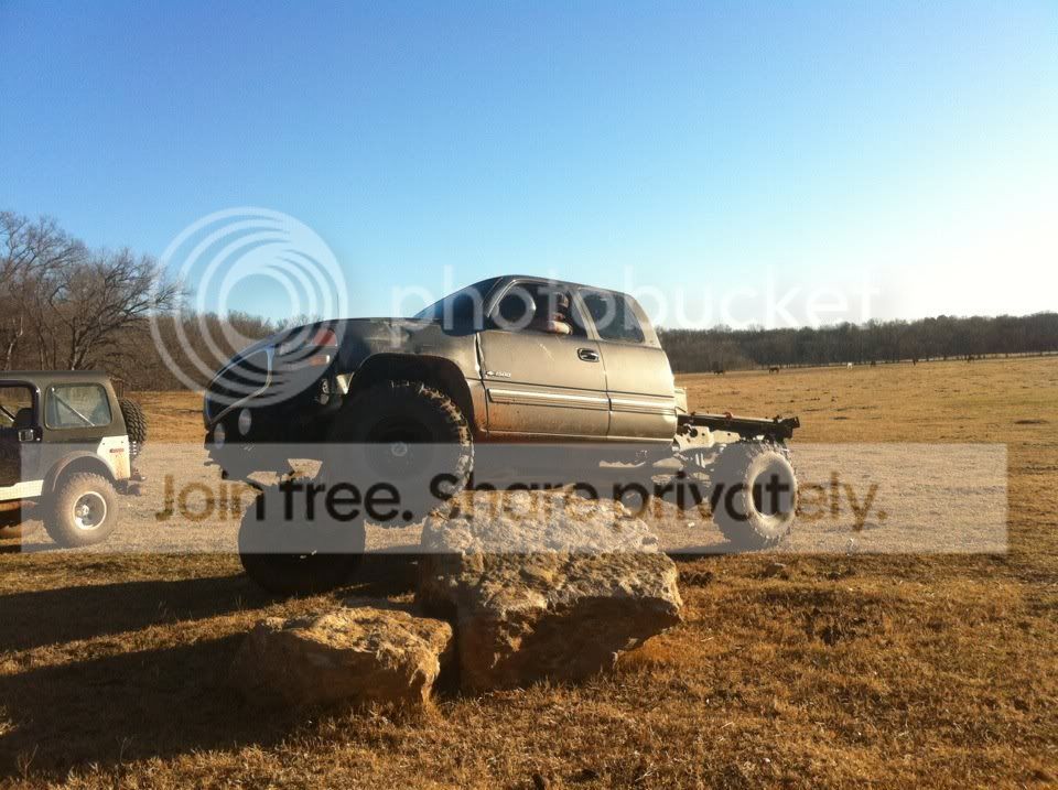

We found a rock. It found my rocker panel after this.

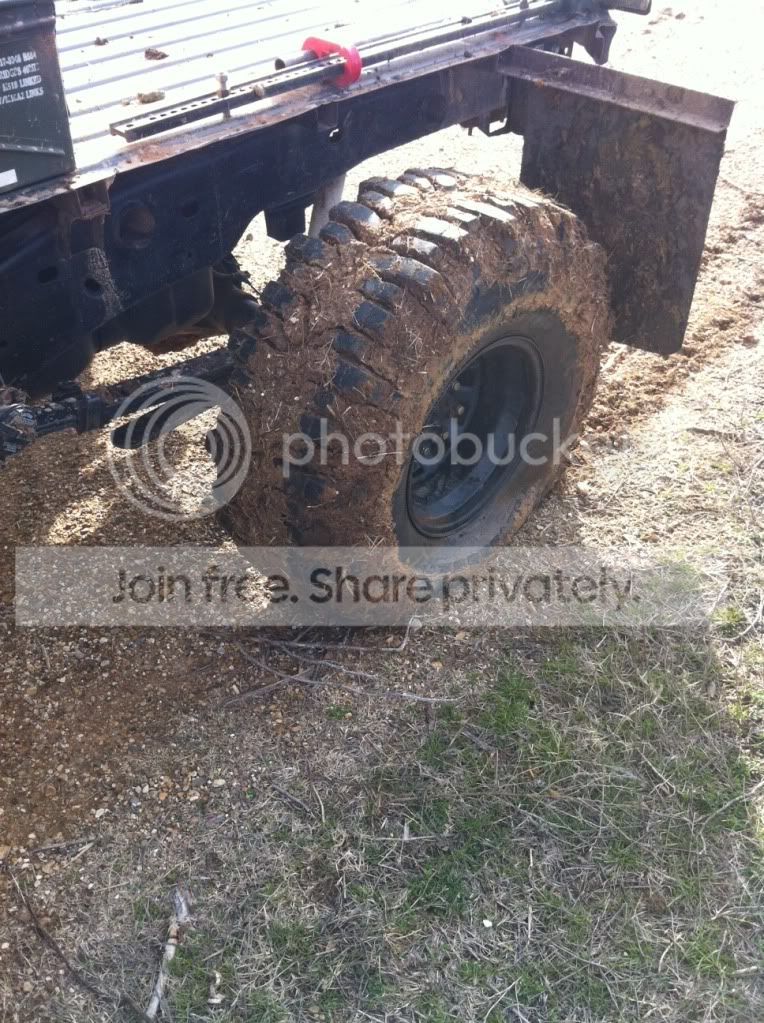

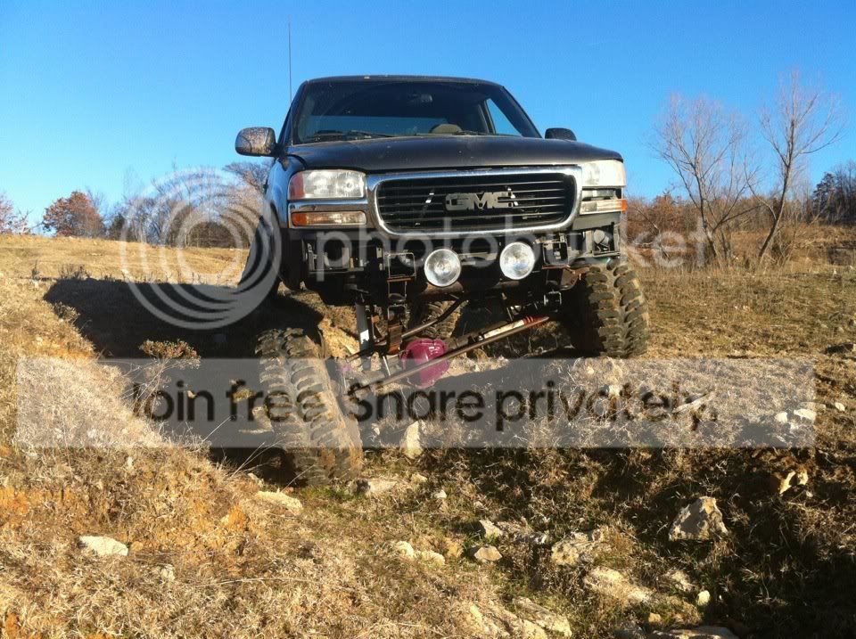

Found a spot that maxed out the travel. Two tires are barely off the ground here.

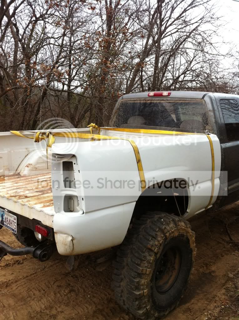

And on the way home this happened. I figured it was a matter of time, but on the first trip out? Bad luck.
I'm probably going to get a sheet of plexiglass or lexan to put in place until I can figure out what to do for fenders. Then replace it with glass.

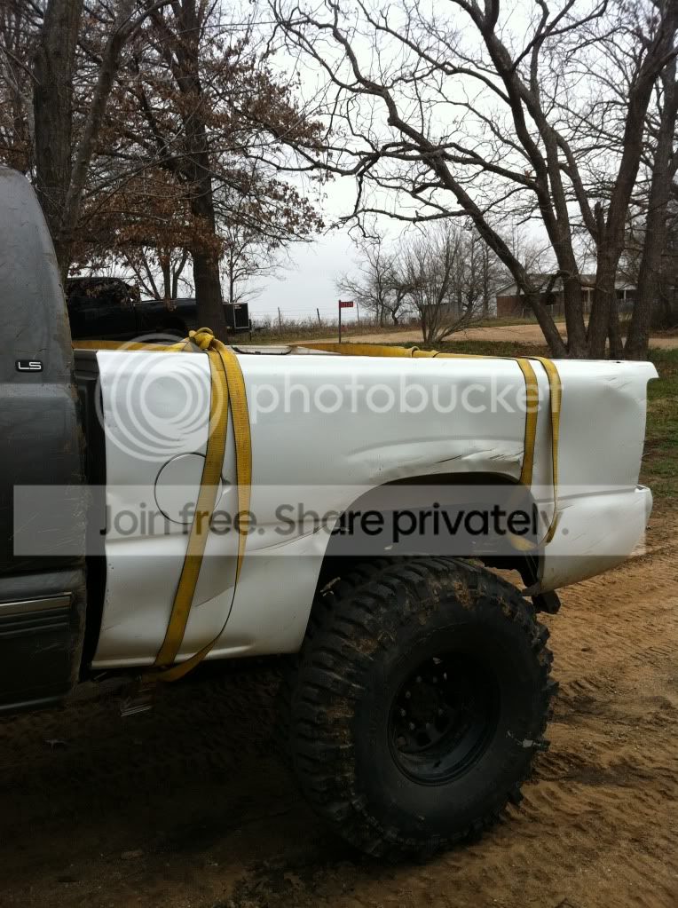

So after pricing trailer fenders that would be wide and thick enough for what I want I've decided to put a salvage yard bed on it until I build a flat bed in the future. They quoted me $150 for a bed with a tailgate and tail lights last time I was out there. Everything was a little beat up, but I think it'll match the truck nicely.

Every time it goes somewhere I end up with a flat. The first time it was a small stick, the second time a nail. This time I hit the bolt head of a lag bolt and tore the tire pretty good. Hopefully they can put a boot patch in it like the one in the front. I havent been impressed with the quality of these boggers. I wish someone else made something comparable, I'd buy it.

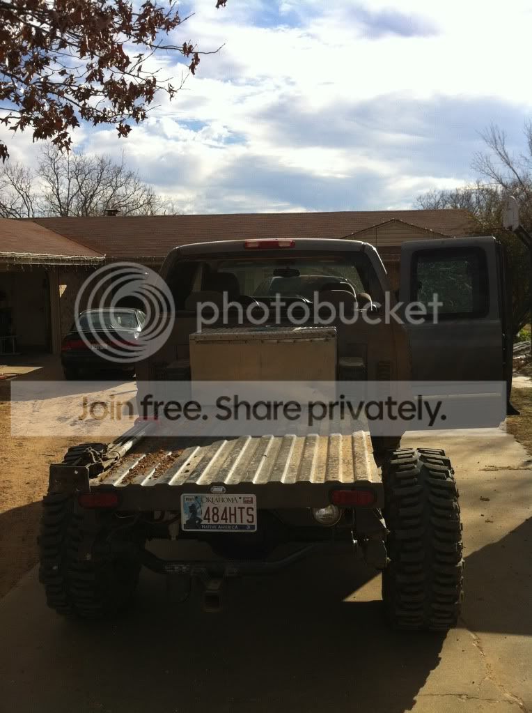

So for $100 I ended up with this fine specimen of a bed. No lights, but I'll get them in a few weeks. Kind of cash poor at the moment. A little trimming later and it fits. No rocks blasting the back of the cab, no mud hitting the windshield when the trucks in 2wd in the dirt. Got inner fenders in as well. Drove the truck to the salvage yard, about 30 miles round trip. Not a bad ride. Pictures.
The right side is decent, the left side is meh. The floor's in good shape, no rust either. The tailgate's in good shape, but missing some hardware. I'll probably just lynch pin it shut and call it good.
At least it matches with the dents and all :D
When I looked at it I couldn't help but laugh that the right side was straight and the left side was beat up. I guess I'll just keep taking pictures of the right side. That'll be the show side.
