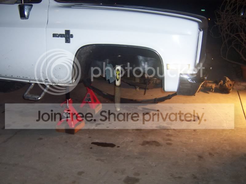

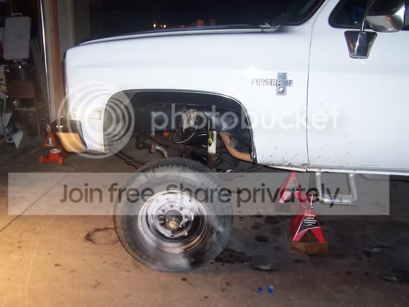

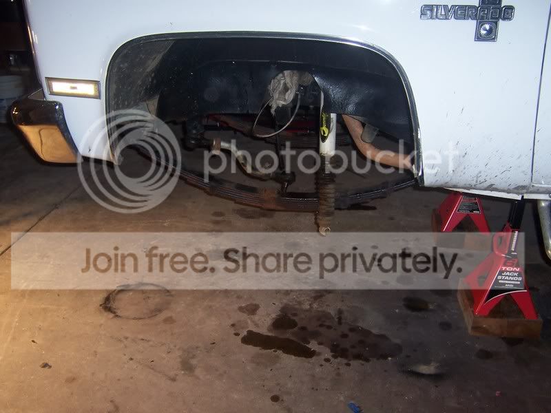

Ok everyone I've got good news and bad news...

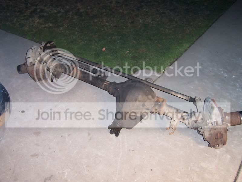

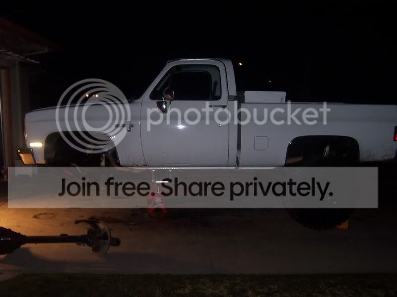

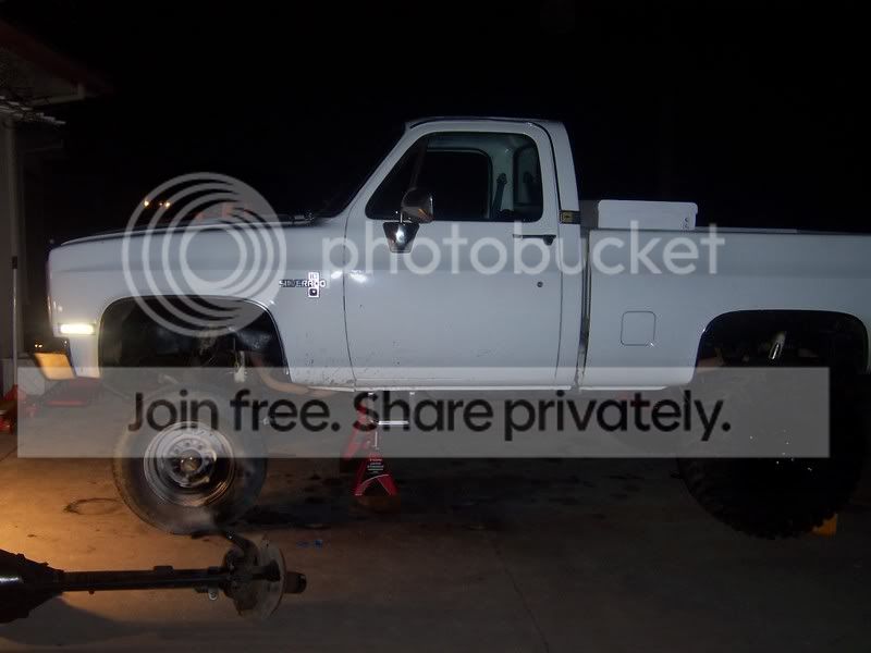

The good news is I got the old axle completely out and everything went pretty smooth...
and I got the new axle rolled under it and into place...
The bad news is that it looks like I'll be swapping steering arms tomorrow...it was getting too late to be running tools and such and it's cold so we called it a night...not bad progress but I'm not looking forward to swapping that arm...
The old one is raised about two inches or so and the one on the 3/4 ton 10b I'm putting in is not only flat but it drops about an inch...so we're talking about 3" or so worth of height difference.
I got things in place and checked but it's just too far for my drop pitman arm so it looks like I don't have a choice...I've read the horror stories of getting them off but I'm hoping I can just hit it with the chisle and see what happens...
