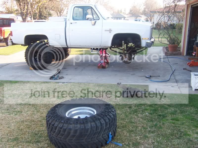

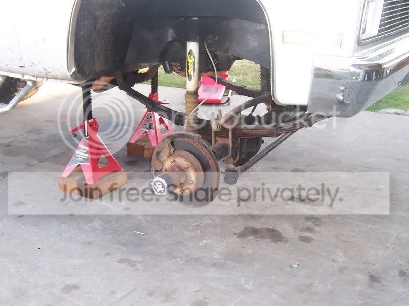

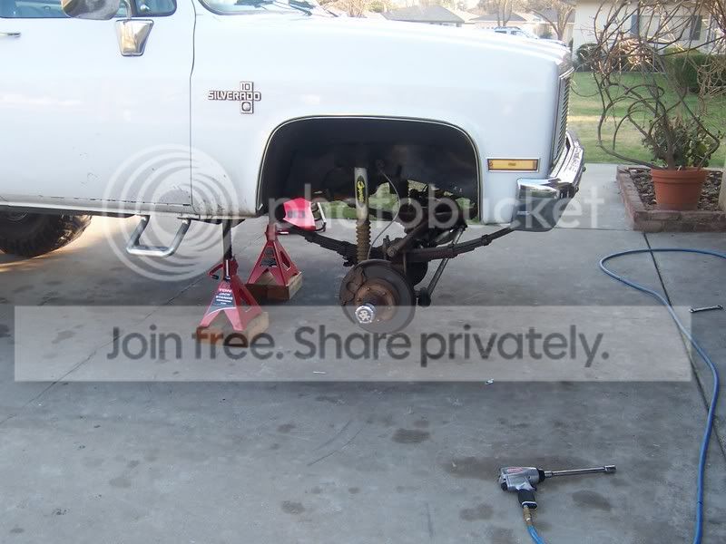

Ok guys...just for kicks here's an update from the last hour...

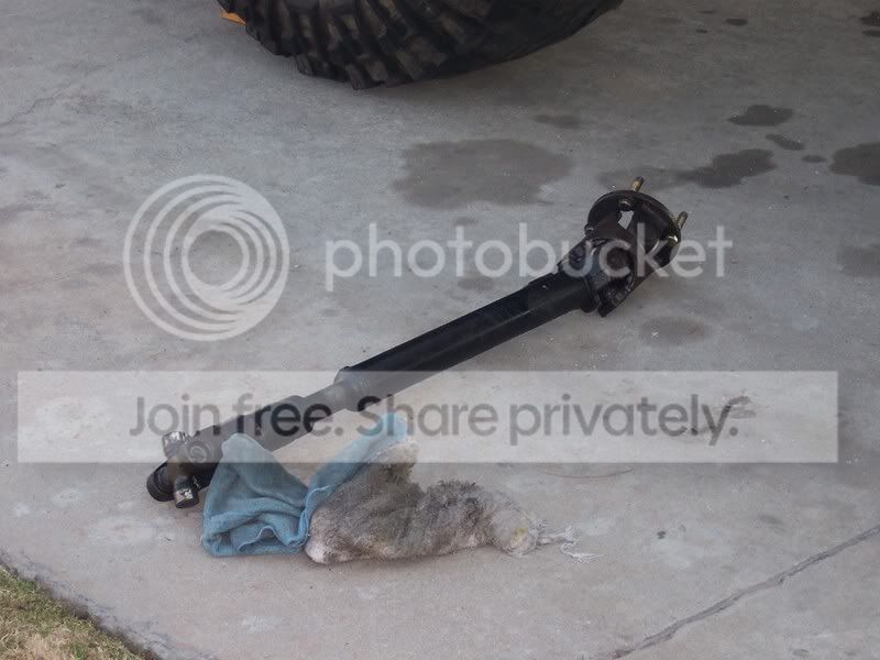

Got the front driveshaft out...

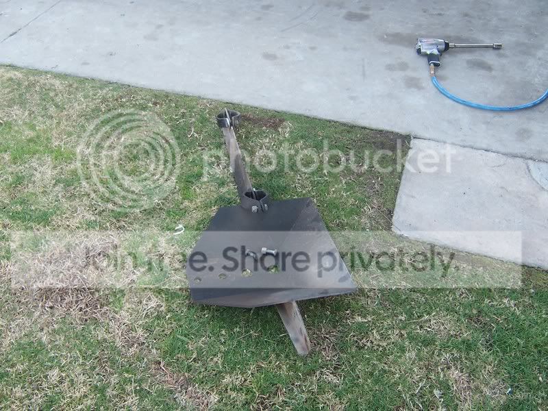

Then I got the front truss/skid off...stupid Rhino one...
Then started yanking stuff out...
I'll be back later with more pics...

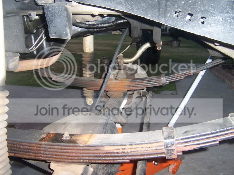

Ok guys I'm stuck...

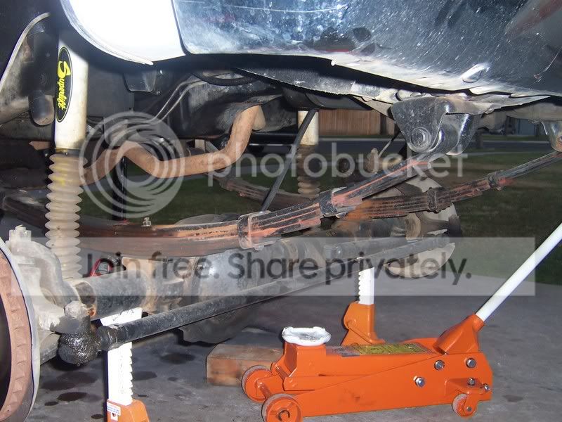

I got the sway bar out...

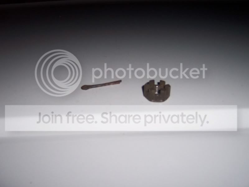

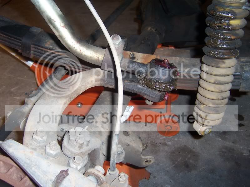

Then I took the pin out and took the nut off...
But now it won't come apart...it should just slide out but it's not budging...I tried to just lower the axle down but it didn't work so I jacked it back up...how do you get these apart?
I don't mean any disrespect but.....why do people make posts ask questions then don't listen????????????????????? Or argue with peoples replies????
put the castle nut back on partially (enough to not ruin the threads) and hit it with the hammer, it will come out

Oh...no no no...I wasn't arguing or disrespecing what he said...I was just saying that if the only way to get it off was to go buy a little wedged fork to slide in there I'll just go beat on it...
He answered my question.
Oh and thanks James...I'll go try it right now.
