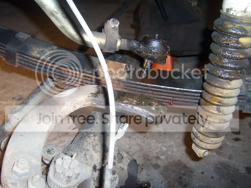

I'm only going to help you cause this thread is hilarious. hit the arm, not the Tie Rod End. the TRE is tapered and thats what holds it in the arm. do not hit up or down. hit the arm in a 90 degree angle to the TRE.
without pictures it's hard to explain. you should be swinging at it paralell to the ground. hit it really hard with a really BFH. it will pop out.

Dude incase you didnt know that drag link is tappred(sp?)Meaning perfectly wedged together fit. Combine that with a litle rust, and you got yourself a combe that is a bear o get off. I guarentee you can get that out tonight with no pickle fork. You want to know how? its a trick. I'll explain it if you want... but it is 100% efective.

ok i'll explain anyway mabey someone else could use the info as well... Ok heres what you do, Take a hammer(at least the sixe of a good framing hammer) and WHACK the steering arm itself right where the yellow arrow is. Do this reptedly(usually takes 5 or so whacks) and it WILL come out. I my self own a pickle fork and no longer use it after learning this meathod(unless this method cannot be applied ofcoars) TRY IT tell me if it works for you.

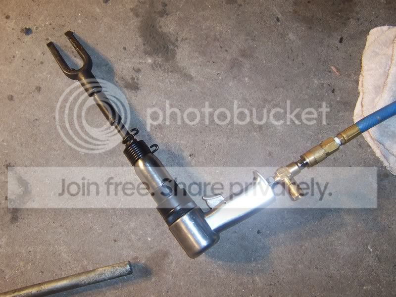

Ahhhhh I HAVE TO GET ME ONE OF THESE THINGS!!!!
This thing is so tight...it took all of about two seconds to get it off of there....which is nice because I just realized the new axle has the old arm still on it so I would have had two of these bitches to get off...

for future reference thats a air hammer/chisel. also great for seperating ball joints, also u can use cutting bits and use the air hammer as a chisel to pop rivet heads off, or cut sheetmetal. u just dont have that much control of the side to side movement though.
its a cheapie too. probably $20 an HF.
yet another instance where a good quality tool pays off.
