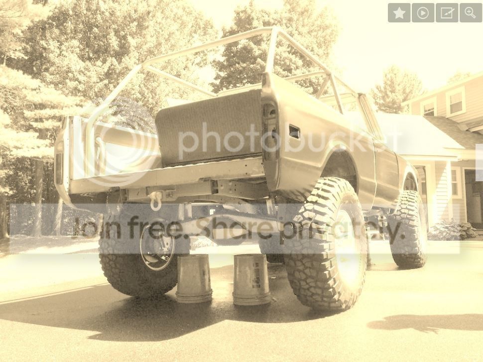

old picture, looks like a blazer and not a skeleton.
I think he just puts those 5 gallon buckets under there to show off.
Maybe paint em a brighter color Greg.
Jerk.
Ok I'm done throwing a fit LOL.
Greg I think that I would bring the tank further back. Taper it up at the end like the factory tank. I really think it could hang down 3 or 4 " and you would have zero issues
OK..... here you go. "Old Photo.....Less Offensive Buckets"
I'll play around with some more tank ideas over the weekend. 30 gallons seems like a lot, but even Eric thinks I'm too optimistic hoping for 10MPG....so which is it?? :haha:

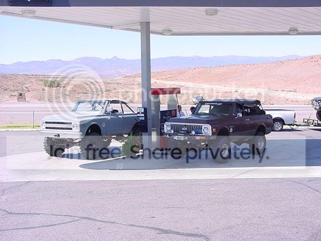

On the 2002 Trip to Moab from CA......we had to stop for fuel like every 2 hours because of my truck. It gave my ears a rest from the "Swamper Howl" of my tires.... but I think the rest of the group was getting annoyed with it.

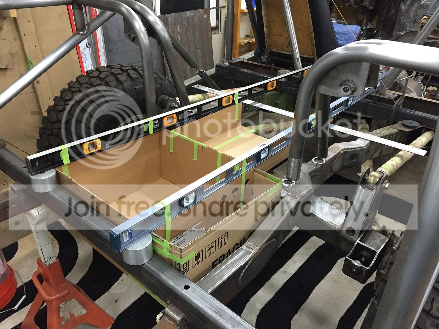

A little effort last night with some old cardboard boxes....
Started off with a 10" deep tank to get about 20 gallons in the large rear portion... Then brought the tank in substantially on both sides to make room for a 3" dual exhaust. If I run the tank the full 61" length it should still yield 35 gallons. :waytogo:

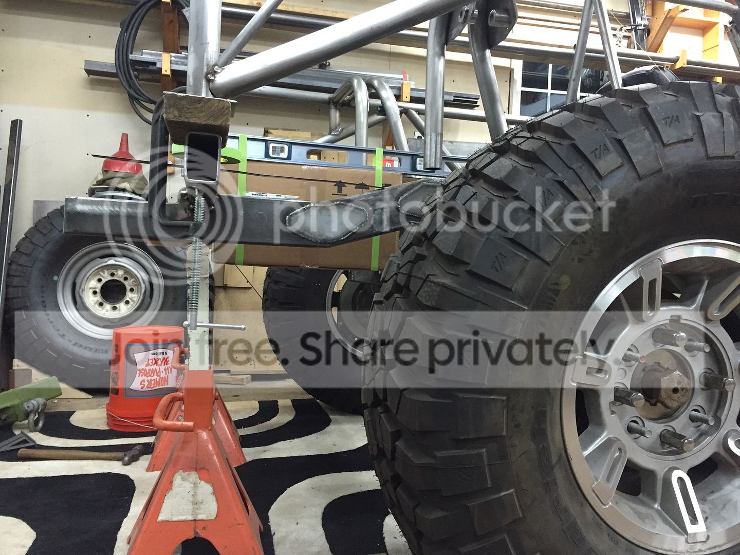

Here's the side view of the tank hanging down.... (2" below framerail)
Not terrible. It's a starting point anyway...

It gives plenty of room for a skidplate apparatus to protect said tank. Which I imagine will hang down another 1 to 2 inches.
That tank looks fairly simple to build it maintains capacity and room for exhaust has good clearance. Rock n roll man
Oh better figure out filler neck and all that other jazz now sometimes that screws everything up
