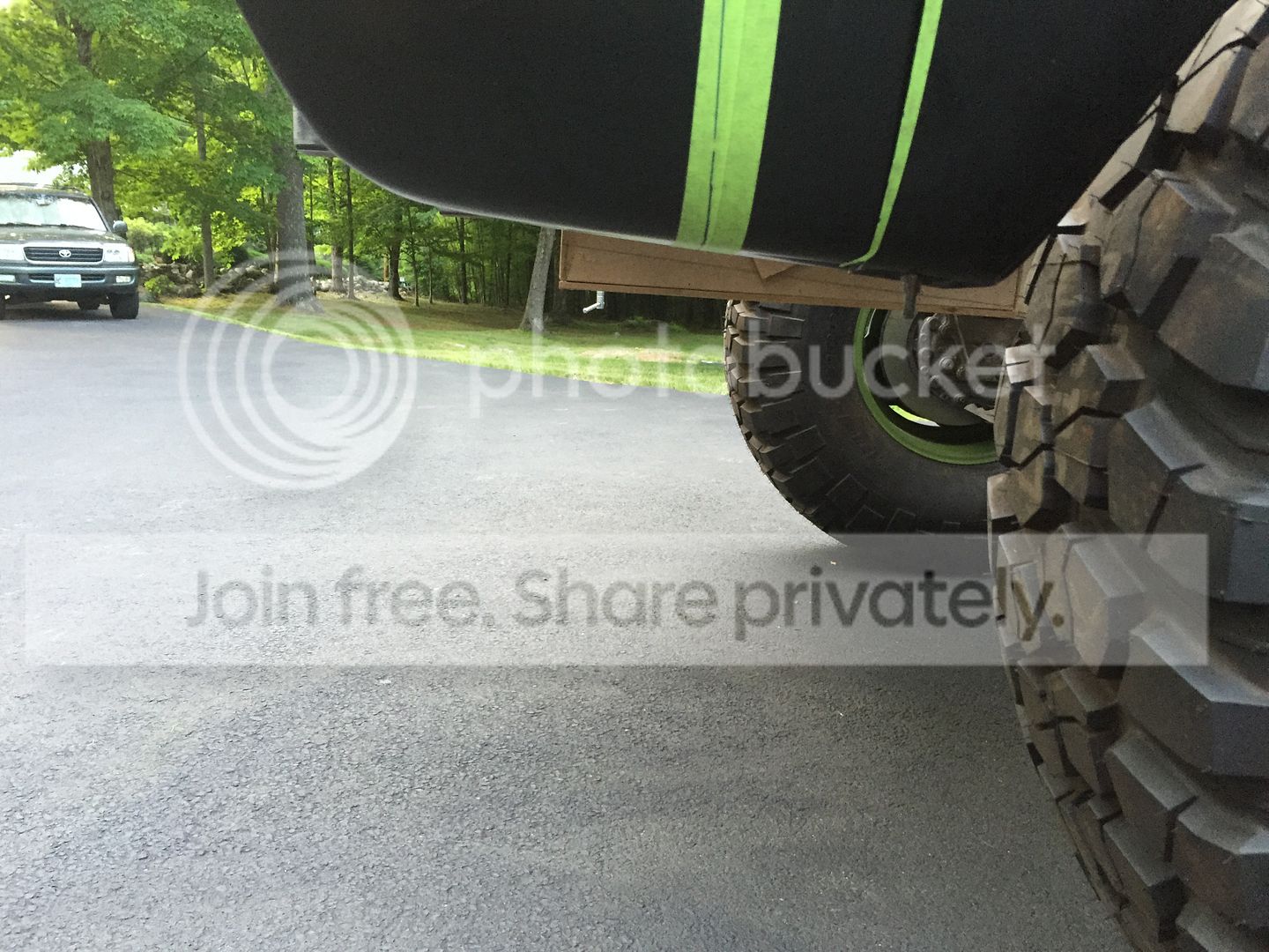

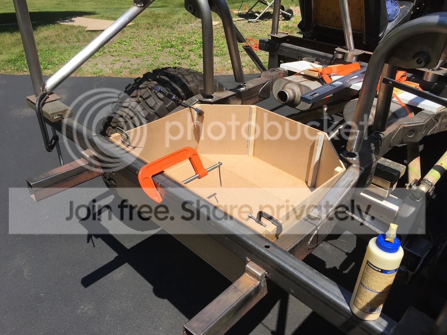

I did a lot of scaled-drawings and set up my tablesaw in the side yard to cut another sheet of MDF into new and interesting shapes to see if I could build a single, center-mounted tank capable of reaching my 32 - 35 Gallon target.
Most of my original designs gave me a center tank with about 20 - 25 Gallons, depending on how deep I made it. They also made it tough to get the exhaust routed through the area the way I need it. So the new objective was to keep the tank as "invisible" as possible (when viewed from the side or back).... improve exhaust routing and clearance near the tank, and also grow the capacity by at around 10 gallons over previous efforts.
The most logical answer seemed to be to extend the tank back closer to the rear axle, but create some 45-degree angles so that the exhaust could sneak under the upswept portion of the rear framerail and head to the rear corners of the bedsides. There is a limit to how far back I could go before hitting the mufflers, and the depth was limited by clearance to the pumpkin at full-stuff. However, with a bit of experimentation I got this:
That trapezoidal area added about 7-1/2 gallons to the 24-1/2 gallons in the front part of the tank. That gives a total depth of 12" . It all seemed awesome, since I basically hit my target instantly... but the problem was that the sideview is not what I want at all.....
It turns out that the lowest I can go in the rearmost part of the tank is about 10.5" deep (not including skidplate thickness) so the 12" deep and flat-bottomed tank has an ugly corner sticking down..... add a beefy skidplate and small air gap between them, and the overall look is not going to work for me. :thinking:
So I had a few more options: Taper the tank on the bottom by 5.5* to follow the natural taper of the rear bedside design.... or find some extra capacity somewhere else. The hard part is that I'm still working with a bedside that doesn't fit right because the wheelarch is in the wrong place (set up for factory 104" wheelbase instead of my current 107" wheelbase)... and when I lay-out the truck on the bumpstops the fender hits the tire.....A LOT!!!

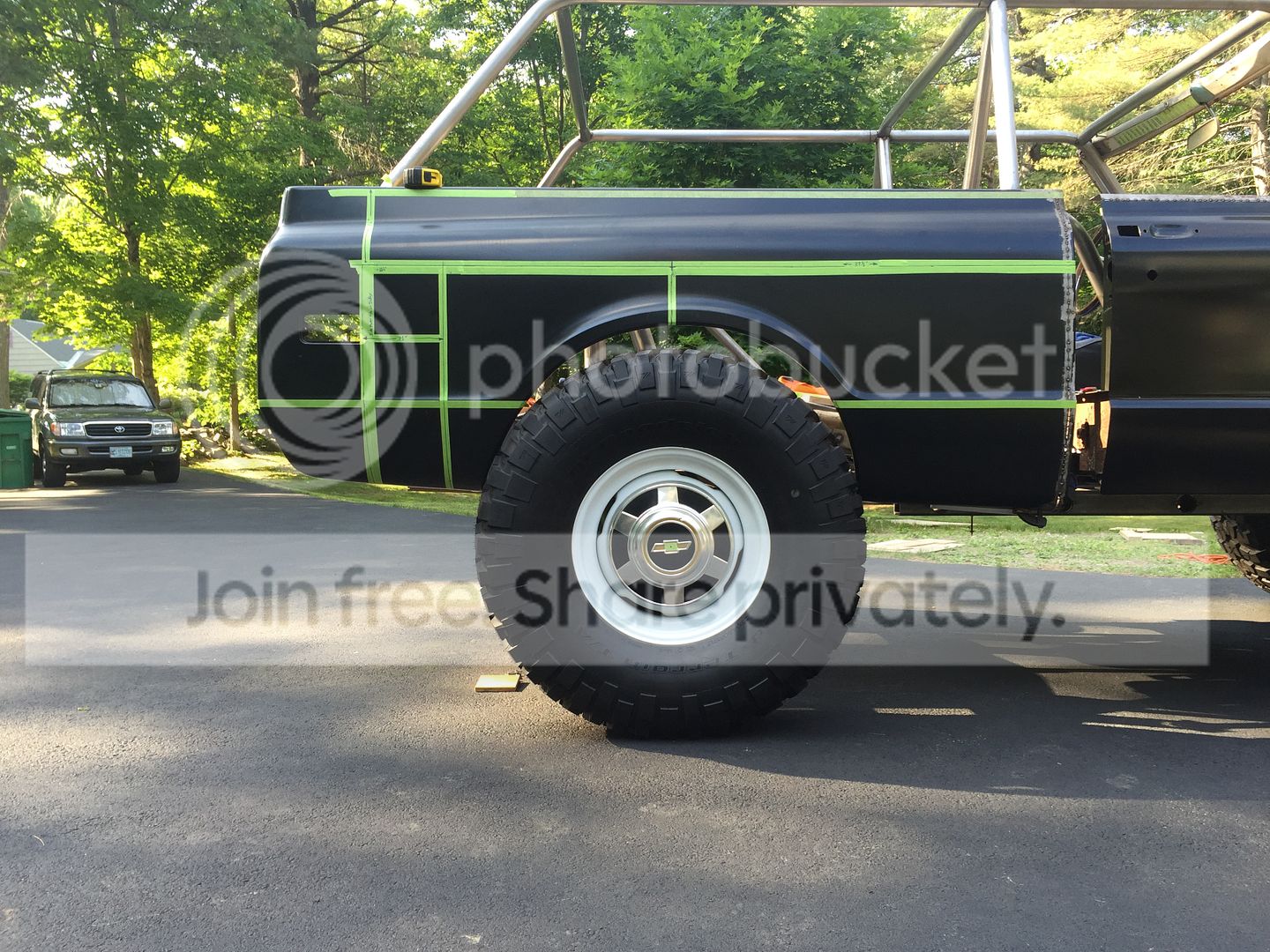

The wheel arch is a total hot-mess right now, with too much gap in the front and a curve that needs a ton of massaging to give it a "stock" appearance so that it doesn't have a big 4" straight section running across the top of it to connect the two sections. Not of that was unexpected, it's just an "I.O.U." that I knew I'd need to write myself so that I could get the bedside into the proper location and see the departure angle and figure out where the rear bumper was going to end up.

NOTE: All photos are taken at "full bump"... which is why it looks so low to the ground in most of these photos. For exhaust / axle clearance checks it was important to do all my experimentation while sitting on the bumpstops. :)

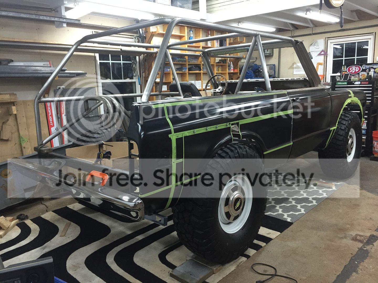

I just can't get over how cool it looks with the body panels hung on! Showed the build to a machinist/fabricator friend of mine and he drooled over it as well.

To James point, the picture with the new wheels and the rear bumper and the passenger side body panels is pretty sweet looking, how did that make you feel looking at for the first time?
:waytogo:
I'm not gonna lie.....it felt AWESOME!!! :saweet:

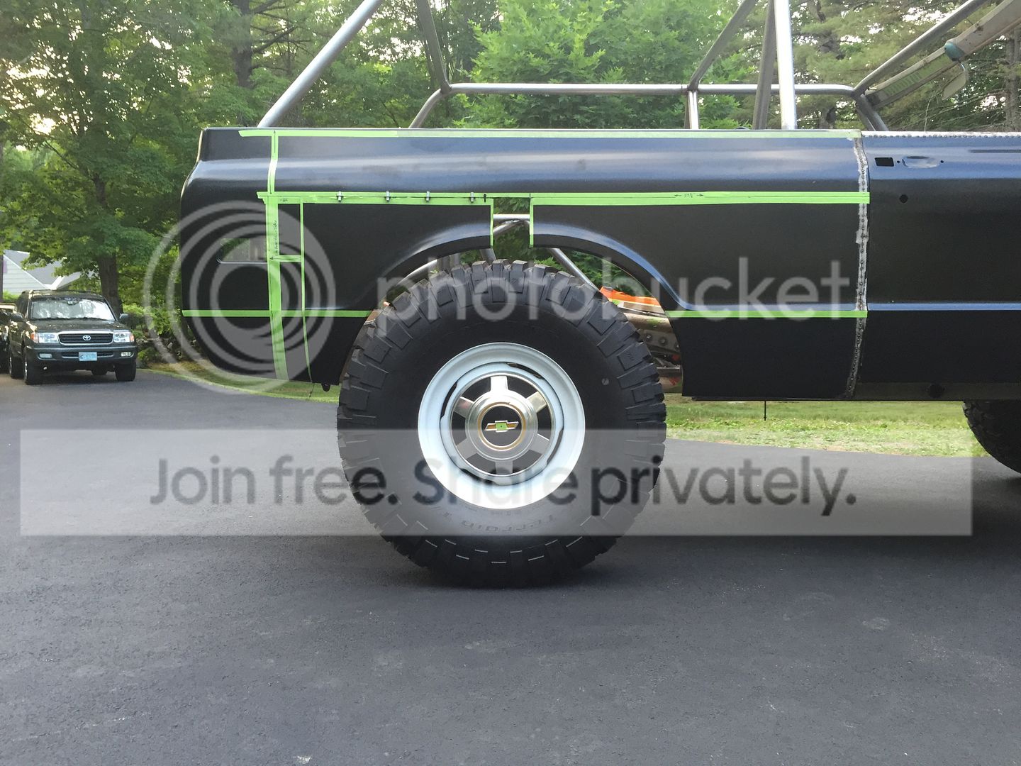

Now the only thing that bothers me are the wheel arches because they are so odd-looking. I want to get onto that part of the project SOON and get them resolved so that the "look" is even more accurate to what's been in my head for the last 10 years or so.
I messed around with the fuel tank again last night. Mostly clean work....just taking measurements, sketching stuff out and doing a lot of dividing big numbers by "231" (converting cubic inches to gallons) :haha:
The ugly "peek-a-boo" tank (from the side profile) is gone now and I've got the tank following the same angle (5.5*) as the lower bedside angle. I still have around 1/2" of room underneath to add a dimpled, speedholed skidplate that will only be visible from underneath.....or VERY far back behind the truck. The downside is that the process of sloping the tank cost me some capacity. I'm currently at 29.75 gallons..... so I missed my minimum target by a couple of gallons. However, the priorities of a clean side-profile and adequate clearance for the side corner exiting exhausts were ultimately more important to me. So concessions had to be made. :deal:
Next step will be one final MDF rendering of the complete tank design just to confirm that it clears everywhere. I'm only leaving 1/2" of space between the framerails and the tank for "wiggle room" and at full-stuff there is less than 1" of clearance between the back of the tank and the axle housing. I'm hoping that with a fully boxed frame and all my cage tie-ins, there won't be much flex back there and my clearances will be adequate??? :dunno:
I also need to come up with a mounting scheme to physically hold this tank up against the underside of the frame. Either a factory-style set of straps, or possibly some kind of long J-bolts on the sides? I'll have to study some online images and see how they do it with RACECAR. :haha:

Take this for what it's worth (not much), but my guess is that you want to cut the rear wheel flares off entirely and create new ones based on the new tire size and position. If you remove the "flare", the profile of the k5 quarter panel is close to a single plane bend from top to bottom. Depending on how skilled or insane you are (there's evidence for both in this thread :bow:) you could graft in a newly shaped flare without messing around with extending the current one or pie-slicing it up. The toughest part would be recreating the seamed lip around the very edge. A bead roller might be a decent way to do that.

I've thought about that idea as well... (clean sheet flares). it's tempting. Maybe I can come up with a shape I like using my old "pizza slice" method, then transfer that arch shape to a fresh sheet of metal and try to do some shrinking / stretching to make it work. I watched those Covell Videos about building wooden bucks for metalforming... they look awesome, but ultimately without a large English Wheel and dies I really can't replicate the shapes I'll need.

It's tempting to think you'de need an English wheel, but take a look at the individual portions of the wheel arch. Don't think of forming it all out of a single piece. if broken up into parts, it can be made from single plane bends except the somewhat small compound blend between the main "body" of the quarter panel and the vertical part of the arc that goes around the tire. That thin blend wouldn't be difficult on a wooden buck and a few rubber mallets. I'm. It not saying you would be able to get away with zero filler, but I bet you could get it really close. At least as close as your get with the pizza slice.
Maybe take a look and make some templates of the portions with some thin flexible plywood. I think you'll see what I mean.
