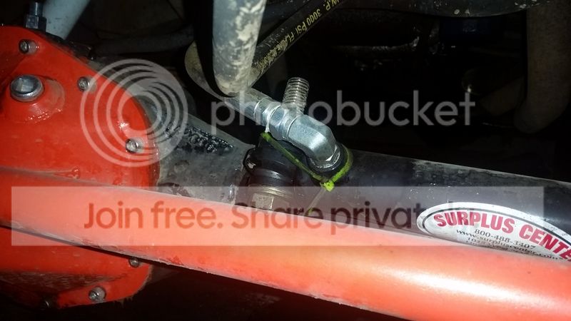

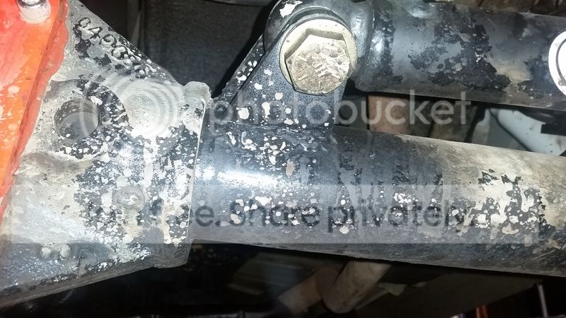

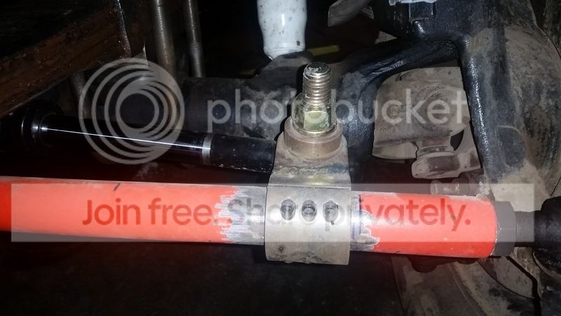

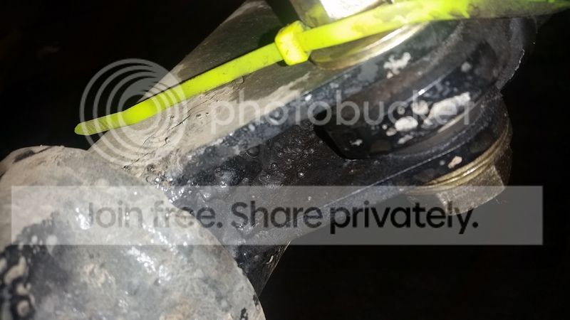

Well as promised here some more shots of my hydro setup. The zip tie is no longer needed. I situated my clamp to aim up a bit to avoid rubbing the rams fittings.
Excuse my ****tacular arc welds....they worked...no more excuses with the new mig.
Make sure you shim between the tabs when you weld. I used some brass sheetmetalsheet metal strips.

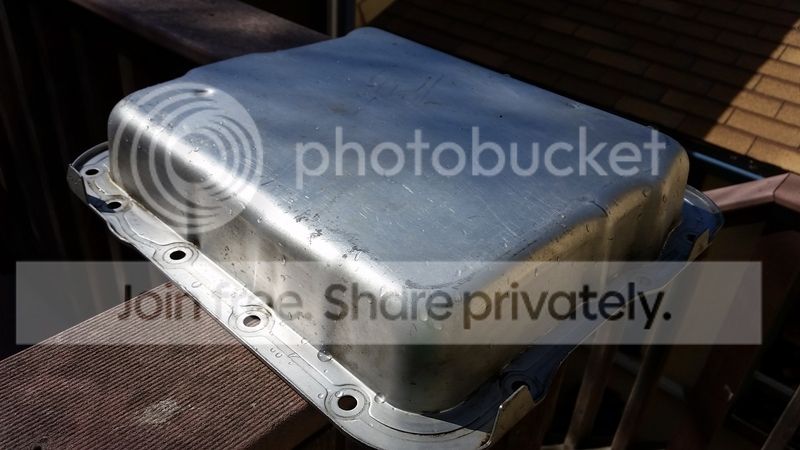

Took the pan off and replaced the filter.

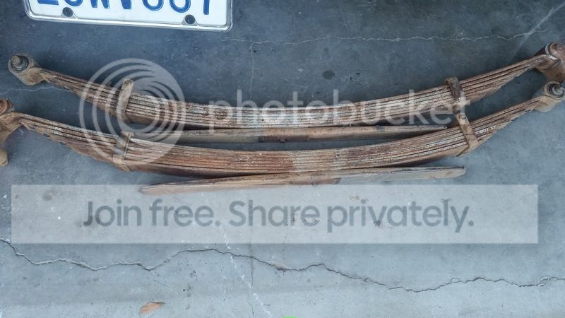

Lastly heres the 56s I got last weekend. 7 leafs...

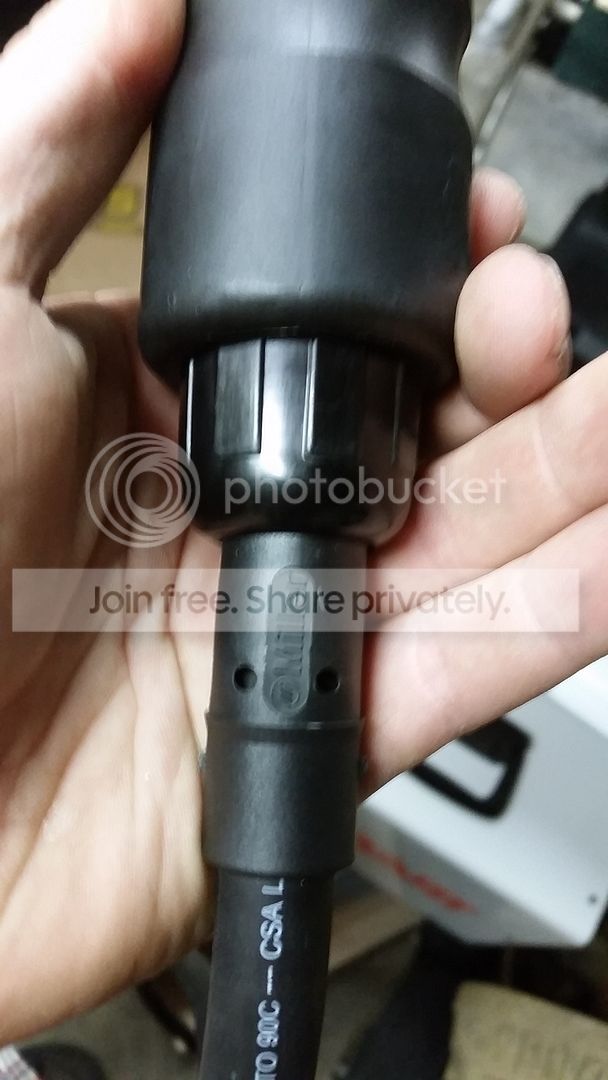

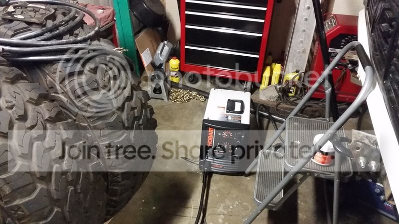

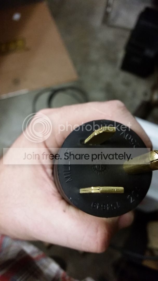

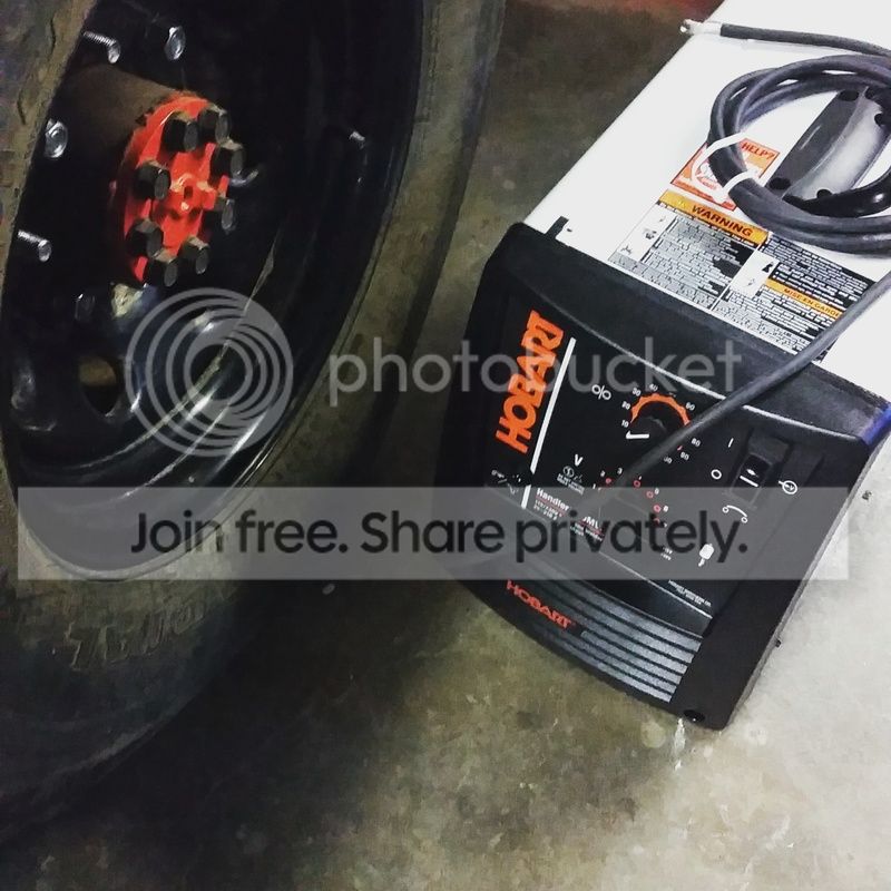

Well my welder came in!
Everything was stamped by miller lol

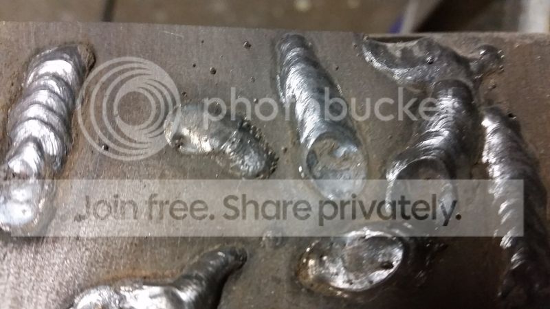

Its my first time mig welding. Its crazy how easy it is to do! Ill probably get a bottle and a cart for it soon. I played with it for about 10 minutes last night and damn does this thing run hot! On the settings it called out for it was penetrating way too much so i dialed everything back a bit and produced the middle weld. Im super happy with it and im sure it will be around for a long time.

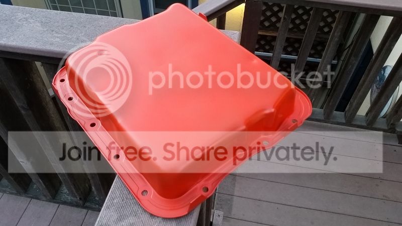

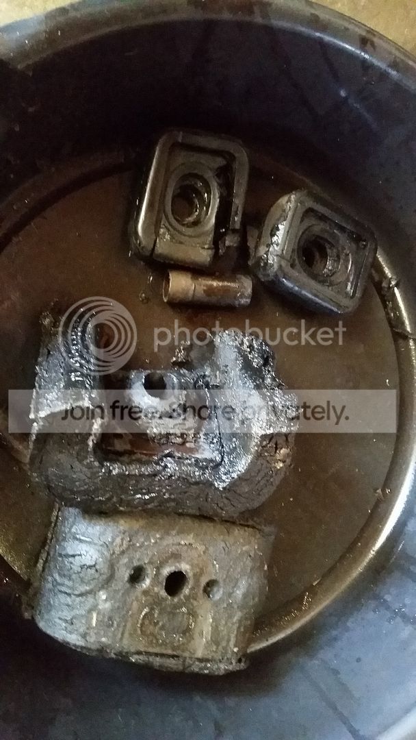

I put a new filter and seal on the tranny. Everything looked brand new inside.
Left it out in the sun too long and it turned orange :D

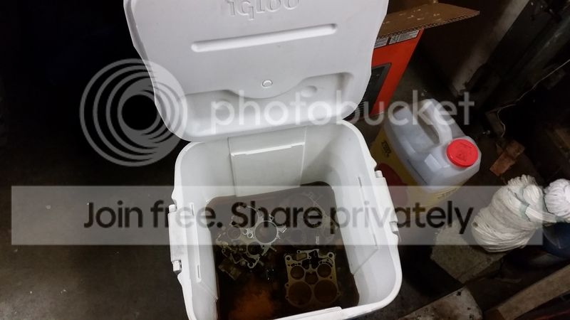

Found a use for my old crappy ice chest...
Going from the 110v welder I had to this unit was a night and day difference.
Yeah ive never had a 110 version but I hear its only good for exhaust and sheet metal.
Hobart is made by miller.
Yup. I did a bunch of research before I bought it but I was surprised to see the blatant stamping of miller on stuff. Pretty sweet if you ask me!
Yep, and if you got a flowmeter with it for the gas my company made many of the plastic parts on it!
Thats awesome, I have it!

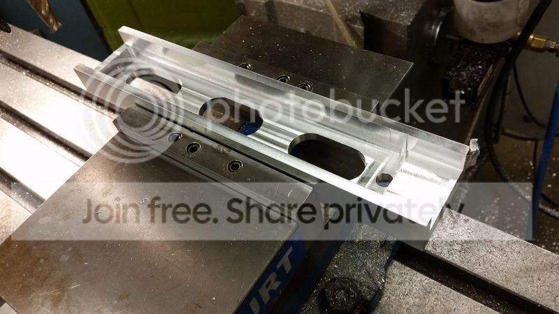

Im also machining a battery hold down bar which ill use studs to keep the battery fastened to the truck. I'll likely make a tray at some point.
I started to pull carb parts out of the wash bin tonight and ill finish up tomorrow. I noticed the lean solenoid mixture screw was stripped. Dont know if ill be able to find one of those. I can make one if I get hard up for it.

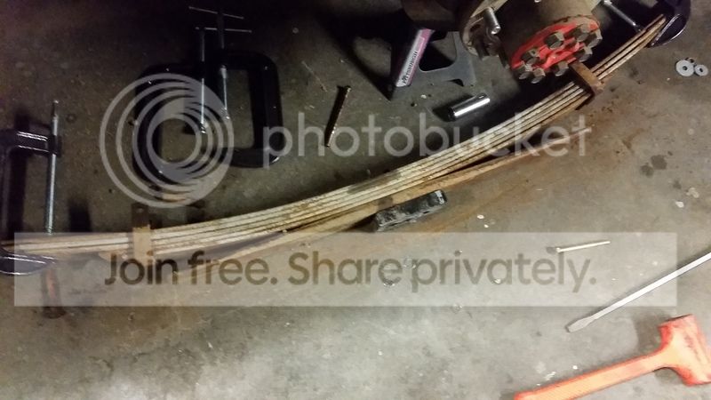

Did you already flip the overloads on those leafs? Whichever one looks in better shape (strength wise) put it on the driver side. For whatever reason, that side always dips on my truck.
Yeah they came that way. I tried to use all 7 leafs but it wont work due to the worn out lift springs in the front...so i have to do my bast to match so i went with 5 springs. The goal is to get some better springs up front and use all 7 leafs.

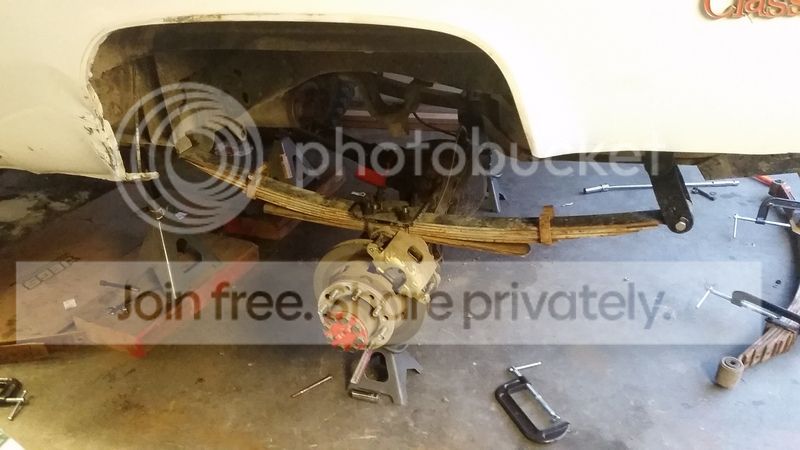

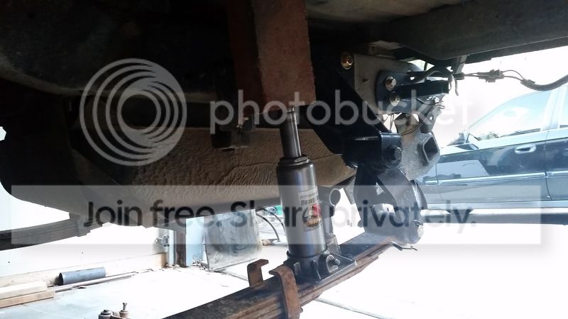

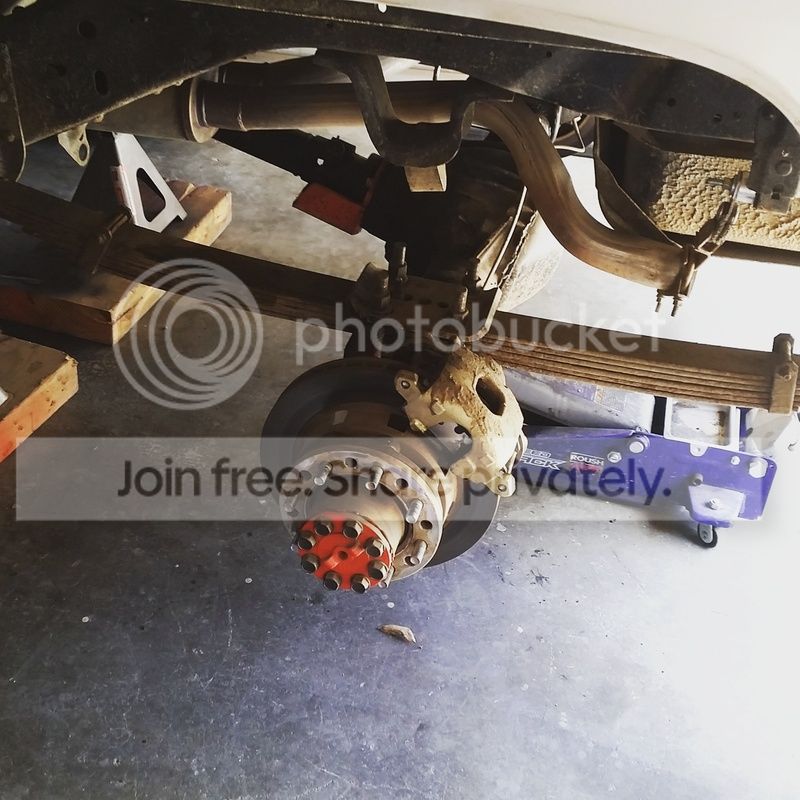

Time to address these clapped out springs...
I tried to run the full 7 leafs + the overload + the ez inch but it wasn't going to happen. It would be better if i had 52" springs up front, which will happen at some point but for now i have to try my best to match the worn front lift springs...I ended up taking out 1 longer leaf and the slightly smaller one below figuring id keep more arch if i had the smaller, harder to bend ones in there. I know my rear bump stops aren't making contact so ill let the overload do that for me until i get shocks on and do some testing.

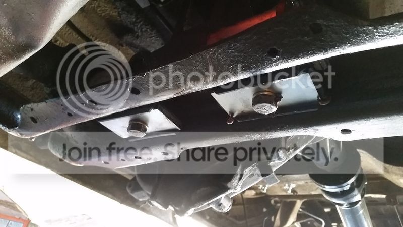

Changed these out for poly mounts...the old rubber mounts got elephantiasis from the atf lol...

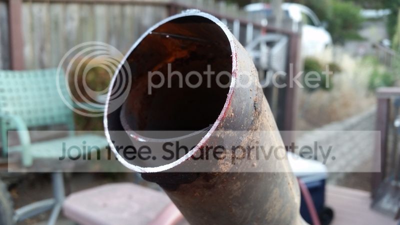

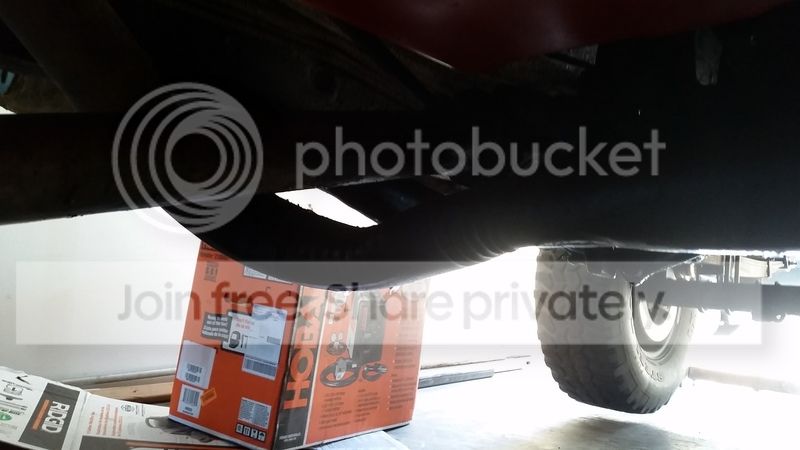

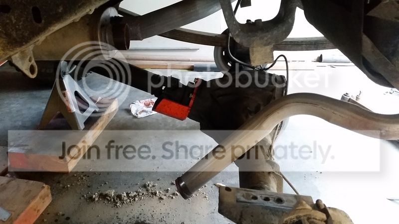

My exhaust pipes burnt my nice new coated drop brake line in the back so i cut the pipes off....F you. Look at this crystal meth exhaust...

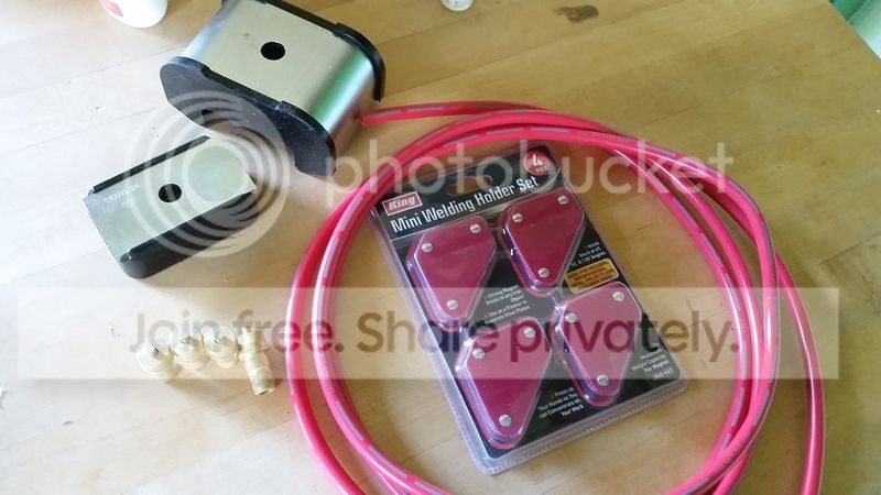

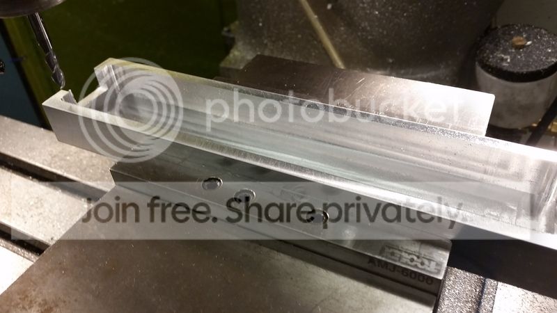

So my battery nearly got ripped out on the last wheeling adventure so its time to deal with that before im left stranded. I could have made a new mount in the engine bay but i didnt feel like it and i wanted the valuable space so ill be putting the battery behind the passenger seat. Ive already got a battery box, now i just need to find a way to mount it. Ill be using standoffs and a plate to strap the battery down with and ive started collecting parts/making stuff for that. Heres my battery strap im still working on. I should have it done mid week. Ill probably get it black anodized and put some speed holes in there too.
Its hard to see but my passenger collector pipe is pretty crushed...now that i have a mig ill probably make up my own exhaust. Ill probably go long tubes, a Y that crosses between bell housing and pan then a super 10 flowmaster or something small and short for a muffler.
Still plugging along on the battery strap...
New leaf springs back in now. Looks way better now for the time being. Atleast the overload is in there.
When you cant get the damn leafs back on you must get to jerry riggin.:waytogo:
