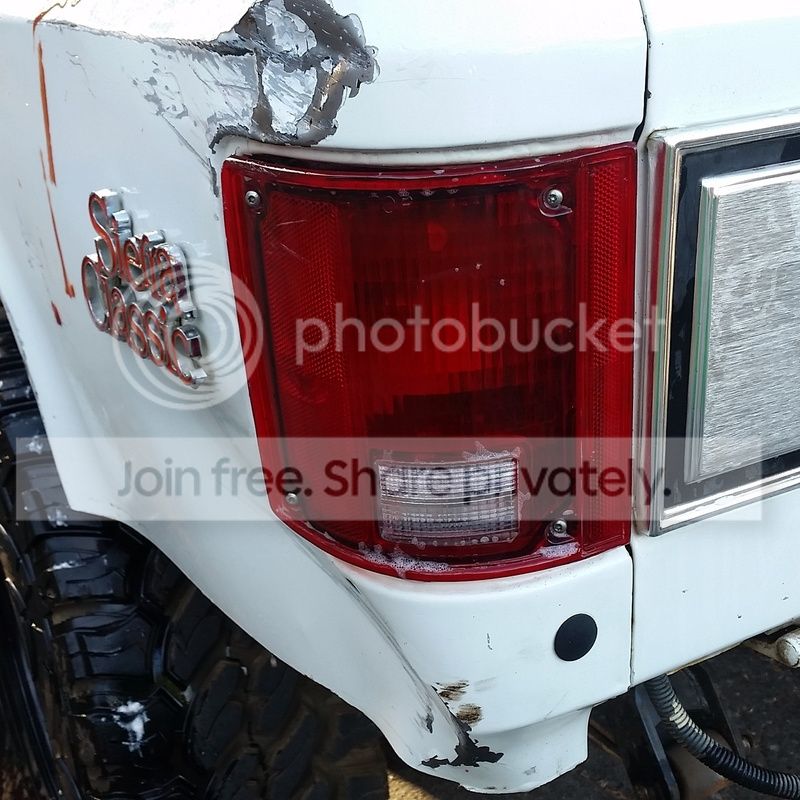

That may be the reason im getting some new sheetmetal on Saturday, but the learning experience was worth it. I know what I need to do to this one to keep it straight ish
Exactly. I think when I get tired of the banged up sheet metal ill dove it front and rear. Its way easier to keep them straight out here that way. Heavy amounts of learning for me within the last week.

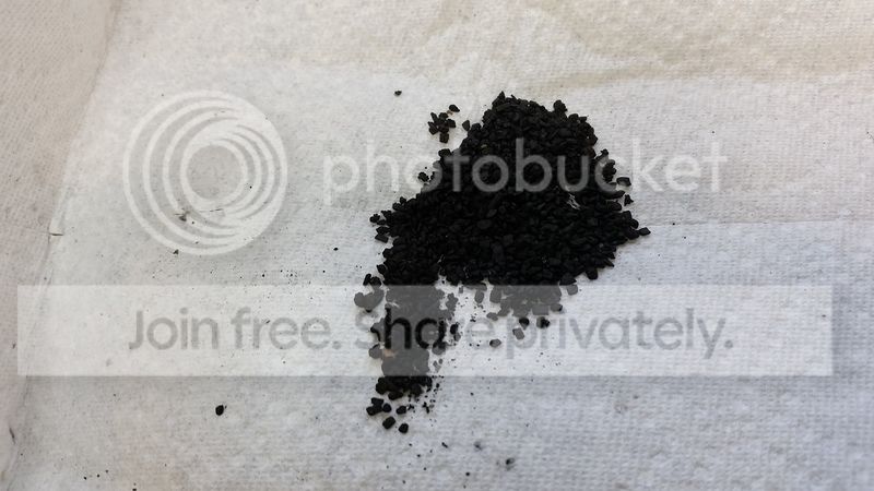

Charcoal...

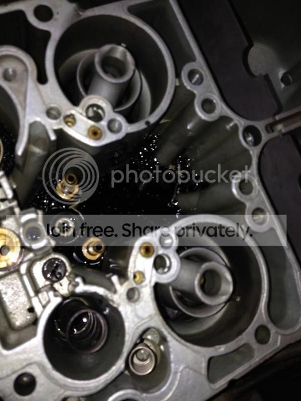

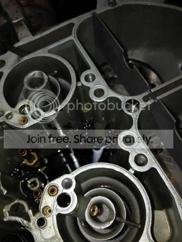

After I dug out the majority from the carb...

I missed it, how did the exhaust pressurize the fuel tank?
It got bent up in the trail. I guess i whacked it on something and it stayed up. There was about 1.5 feet from the gas tank but it pressurized it really badly. It took about 10 minutes to get the pressure out. Definitely coming up with a shorter exhaust that doesn't include a cat. Turn downs are a must too. I never knew that could even happen until it did.
I can honestly say I have never seen that happen before. Maybe the charcoal canister was bad, or went bad, when the tank got cooked and allowed it to bypass into the carb. Worst I have ever seen one get was filled to the gills with gas after somehow failing. Never seen one puke its carbon.
Yeah weird right! The thought of the canister stranding me never entered my mind. No more canister for me lol.
