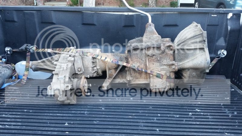

Well I finally found what I was looking for....
Had to drive to friggin Placerville to get it but its the first 32 spline ive seen in a few months. Everything seems tight but free spinning. Kinda contemplating putting it in once I check it all out.
Its out of an 83 apparently. I think its a 208 but didnt have time to look. Im curious to know if its similar length to what I have now. If its right on the money ill start yanking the auto and sick 208 out for this stuff....
It is an NP208. That setup will swap directly in place of a TH700R4/NP208. You can reuse your current driveshafts. If you have the correct crossmember, they are also a direct swap.

You don't have a picture of the other side of the bellhousing.

Just FYI, pretty sure that is a mechanical clutch bellhousing, not a hydro one. Hydro bellhousing has slave cylinder on the passenger's side. Not that it really matters since it's a matter of personal preference but you also have the cast iron top plate/shifter instead of the more desirable aluminum top plate/shifter. What did you pay for the combo? Hope it wasn't more than $300 or so.
Yeah its not hydraulic. It will be though. not sure of the difference in top plates. As far as I know the guts are the same. I paid 200 bucks for the setup. Ive been looking for a 32 spline 465 for months so I jumped on this one as soon as it came up. For some reason there very hard to find out here.
Ok, that is a fair price. The hydro bell housing and pedals are where the main expense is. The later model aluminum top plate has a shorter throw shifter that is moved forward several inches. It is the one in my build.
