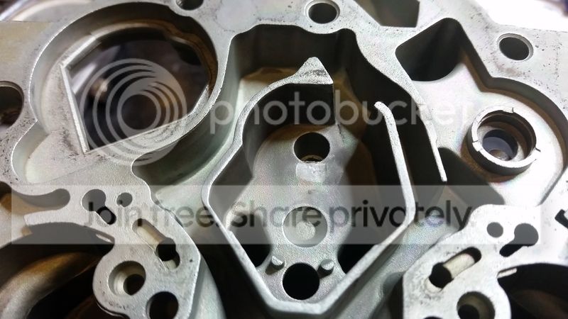

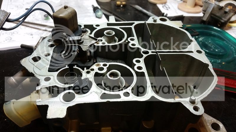

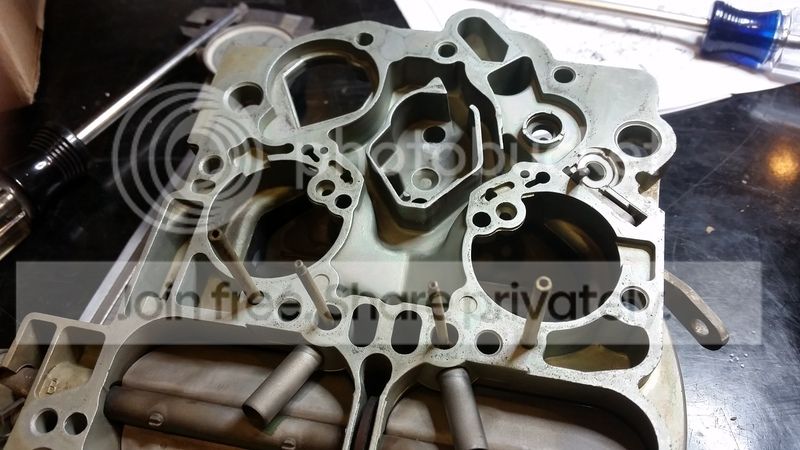

At the top of this pic where the screwdriver goes off the page you can see the port in which the charcoal traveled. Seems like it goes right into the bowl through some passages.
Its the barb-like port on the left there.
Passages up towards the right...
From what I understand that is a fuel bowl vent, It vents fumes from the bowl to the charcoal canister when the engine is off. I think there is another line from the cannister to the PCV line that creates vacume to vent the line to the tank and the fumes from the cannister when the engine is running.
I definitely know which ones youre talking about. This line is definitely that fuel bowl vent.

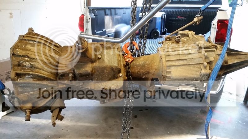

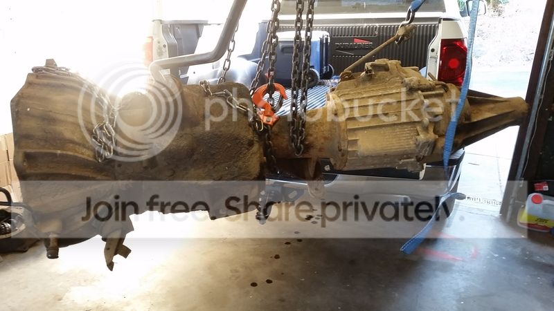

I finally got the 465 out of the back of my other truck today. I also moved the k5 out of the way and went over it to see what needs to be done. It sure is screwed up. I was thinking id make a small wheeling trip in October but theres just too much to do. I need to get this thing running right first. Ill probably get a regular ol quadrajet, rebuild it and slap it on for the short term.
Got some of the road grime off...

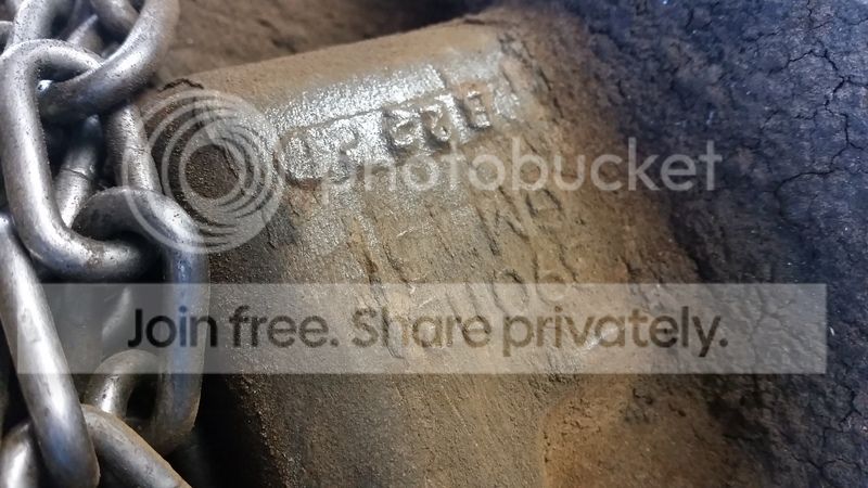

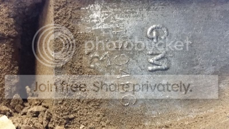

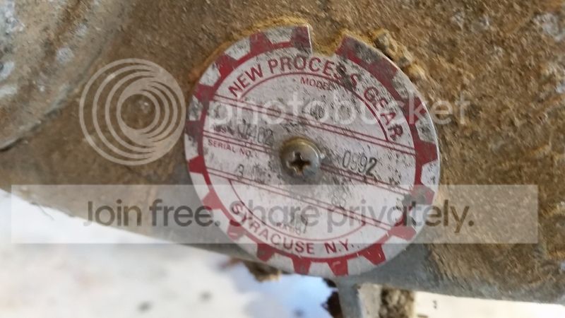

Found some numbers.

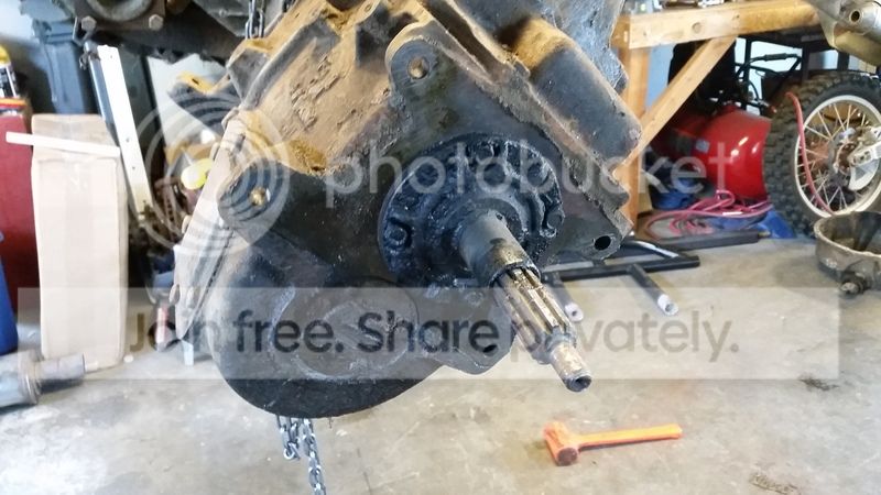

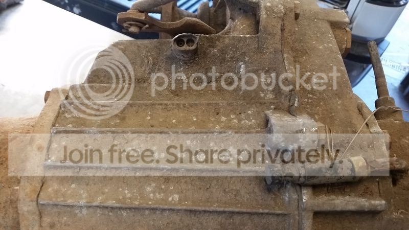

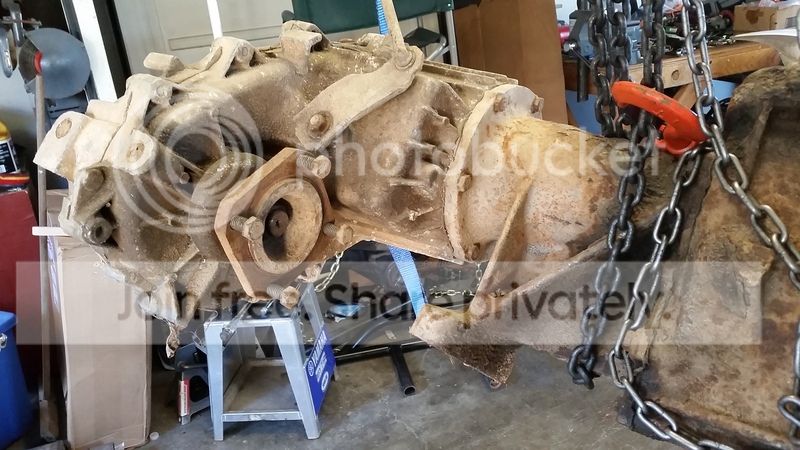

Whats this connector for? Theres one on the top of the tranny too?
Took the bellhousing off so I didn't break it.
This bellhousing will work with novaks hydraulic kit, so thats awesome.
Shes a bit crusty but itll clean up...

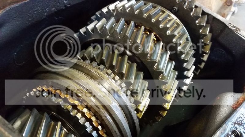

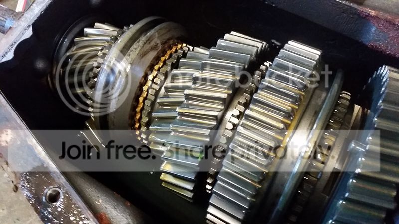

Im happy to see everything looks new inside the tranny

Still need to get a flywheel. Im thinking ill do solid motor mounts while the tranny is out as well. Took a bunch of pics of the smog crap. Its all coming off soon.
Ya, I think the plug on the T-case if for the dummy "4x4" light in the dash. Can't remember anything else.
Why would you have a reverse light switch in the column for a floor shifted 4 speed?
Martin
ohhhhhh
to be different
Where's the plug for the dummy light? I had one at one point lol
He was talking about the plug on top of the SM465. That is for the reverse lights.
The switch on the NP208 is for the 4x4 indicator lamp.
