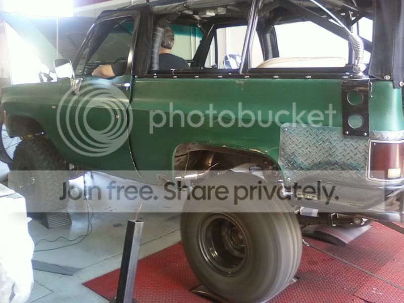

I found this guy http://www.socaltuning.com/ he was close to the house and in about a hour/2 on the Dyno, the truck is running great and shifting right.:D
He also pointed out the problem that I was having, which was the ECM program. This guy said it was all screwed up. It wasn't just one little glitch, it was many things.
Now that's something I paid $200 for Howell Injection to reprogram in the First place. So I e-mailed a letter of complaint to them and I'm still waiting for a response:rolleyes:.
Now, before I can go out and test it off road,I need to do something about the engine crossmember. It sits right against the oil pan.
here is a dyno pic i tried to get video but brain farted it so this is all i got.

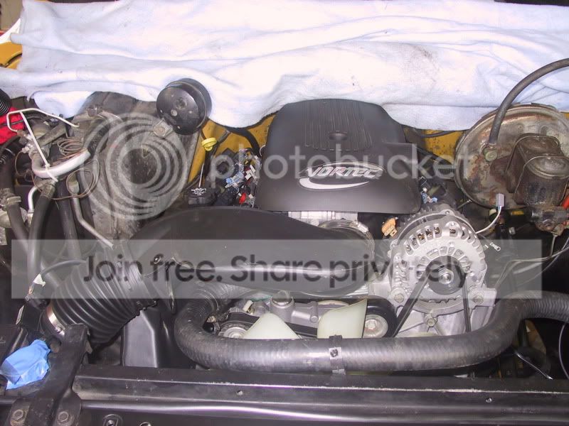

I just finished my 5.3/4L60/NP205 swap in my stock height 1972 Jimmy. I and a good welder I know fabricated my engine crossmember which was real tight with the front differential to crossmember clearance. Going with the NP205 also added to my swap costs as I had to change the output shaft. May as well add the beast sunshell and new clutches while I was in there.
Here is the engine sitting in my Jimmy

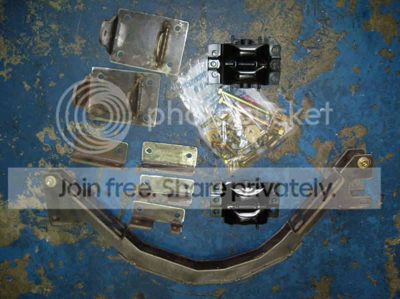

Here is a picture of a crossmember offered by pacific fabrication for the 69-72 trucks. It may be usefull for the later years or they may even have a different one?
