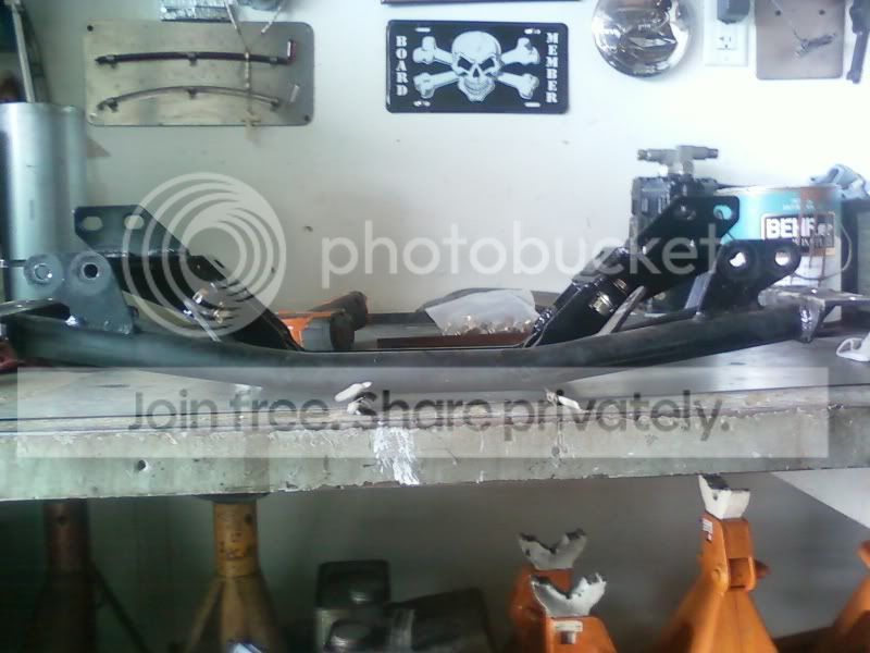

Well my diy4x cross kit is on order and hopefully be here this week. I'm going to try and make something that bolts to the flanges. If it works out I'll send ya some pics and if you like it I can make another.
That looks like plenty of clearance to me. How close will it come to the axle is the real question.

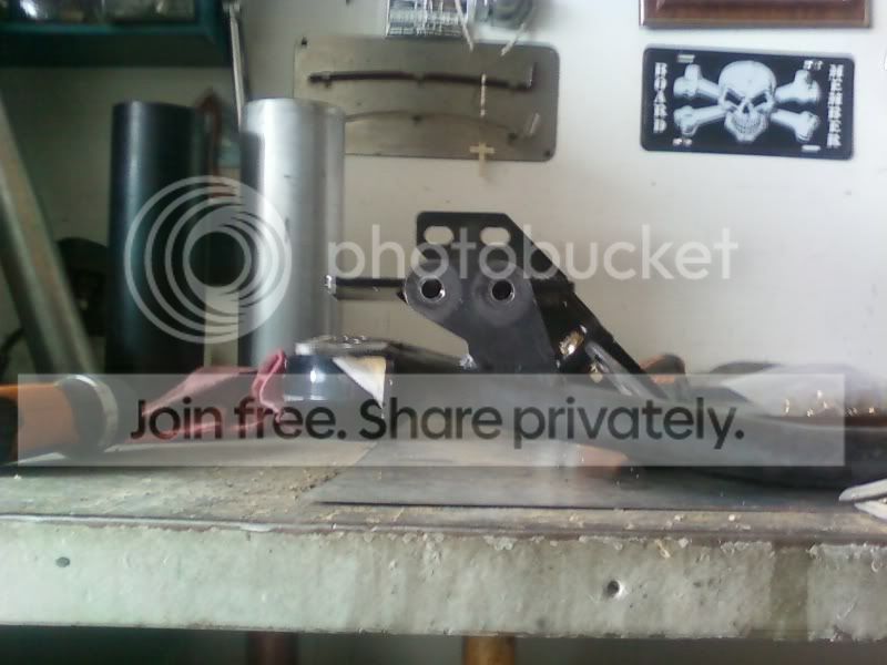

Here are a couple pics of both cross members sitting on the bench the twisted one sits 1 1/4 lower than the ord one clearance should be no problem. Buefchris has the pics of it installed.
Much more room than ORD's. These pics might not show but there is almost 2" of space between the pan and the member.

Now I have a 3/;8 spacer at the motor mounts to keep the manifolds from hitting the frame, so I may have been able to use the small block center piece instead of the big block.

How is the front differential clearance? How about some pics of frame attachment and the motor mount area? Nice looking piece, glad you're making progress.
