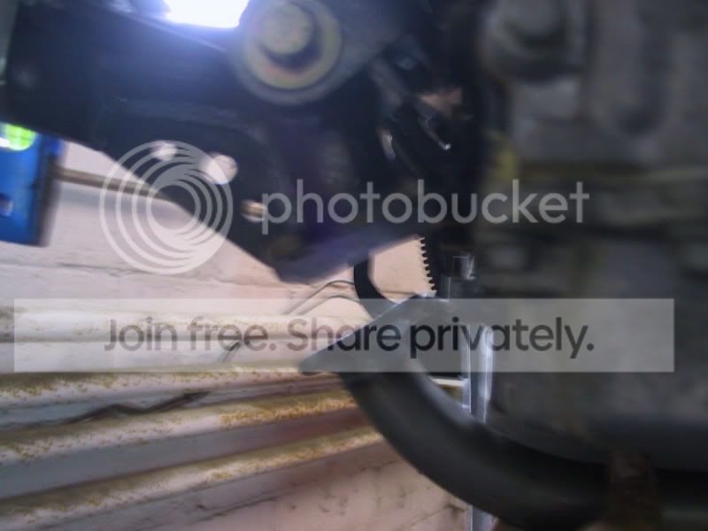

How you making out on the cross member situation? I'm talking to Kert at diy4x about using one of his early blazer members. Their newer design allows the crossbar to come out while leaving the motor mounted and will clear a big block pan as is. Does the LS pan require more clearance than a BB?
I could not get Kurts to work. I made my crossmember out of some of his parts though. I used his frame brackets, the plates that bolt to those brackets and his motor mount/bushings. I then welded 1 1/2 inch chrome moly 1/4 wall tubing to those parts to make my crossmember.
Did you start with his newer or older model? From what I can tell its gone through three revisions.. One piece, three piece and an extended three piece that allows for BBC pan clearance. I've seen the mount you modified but it looked like you started with his older one piece style mounts?
Here is a picture of how far off his one with the removeable part was.
I sent him a template and he said it would be easier without the flanges so we tried another one using my template and it still hit the front differential.
I finally decided to custom make one using his parts as a starting point. I am still very close to the front diferential.
