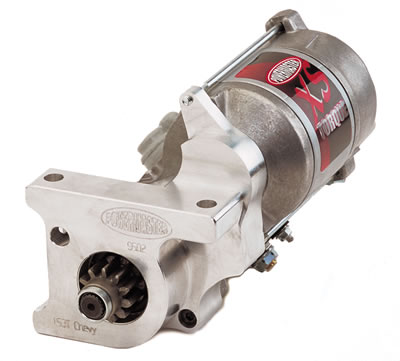

as Dave said...
here, 168 starter mounting..

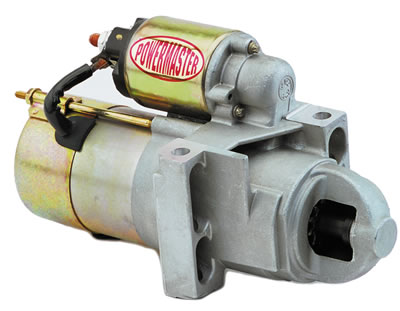

and a 153

later blocks have provisions for both mounting configs..... 168's are 14" dia.. 153's are like 12.75....
lot's of earlier chevy blocks only have the staggered pattern for 168 starters..
