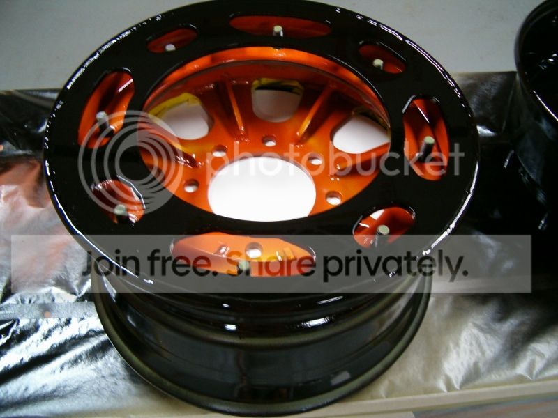

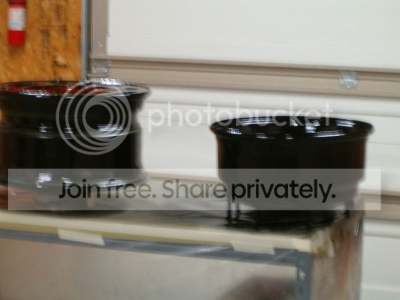

Got the black on, and decided to see what they looked like...despite a little dirt in them, and missing a bit on the inside of the rim, I'm liking em.
I still have the cardboard in the back half (the white poster board to cover the orange)
They look good Dave, nice job. Now bolt them on and go to the dunes this weekend!
Looks great, Dave... :waytogo:
Edit: Looks like you're the winner of my 1000th post. They must look really awesome for you to win that... :haha:
I like em alot...but I won't be making the dunes til July...just got to much to get done yet, and not enough time to do it. Still have to get the Vette some attention before Powertour also.
Would like to get a quick paint job on it, but not sure I'll get to that either.
will be working on the other 2 wheels in the next couple days, then cutting down the runflat inserts and trying to get them all together.
Then the tube doors, skid plates, hydro assist, some electrical stuff, and a few issues that need to be taken care of before running it again.
