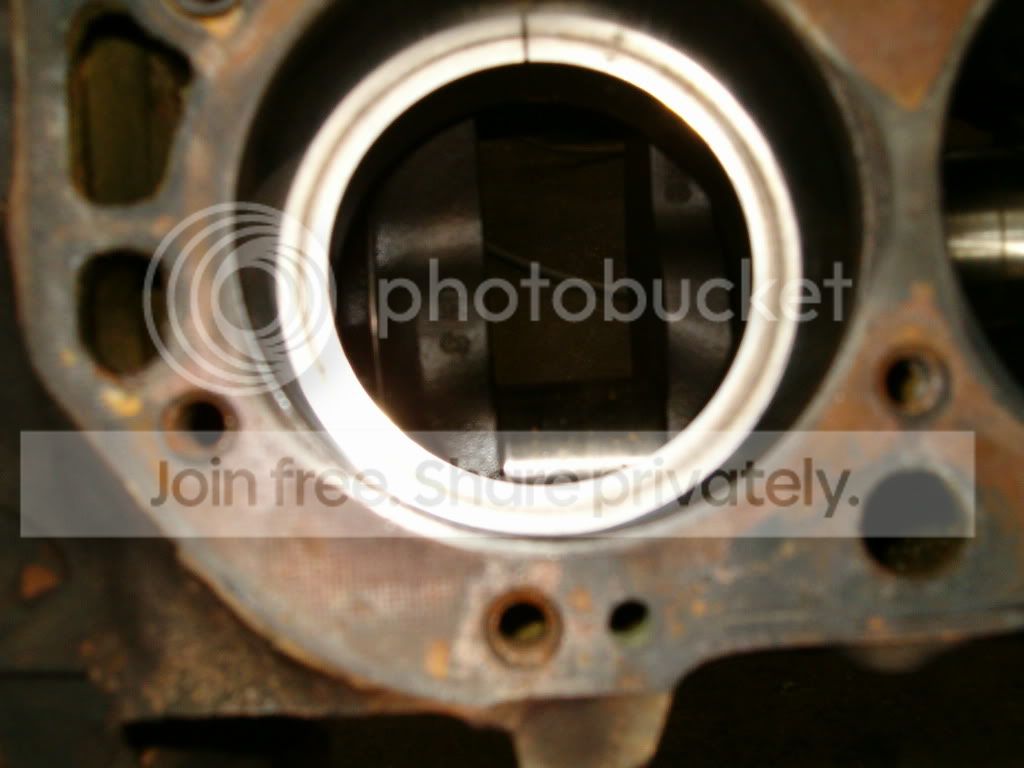

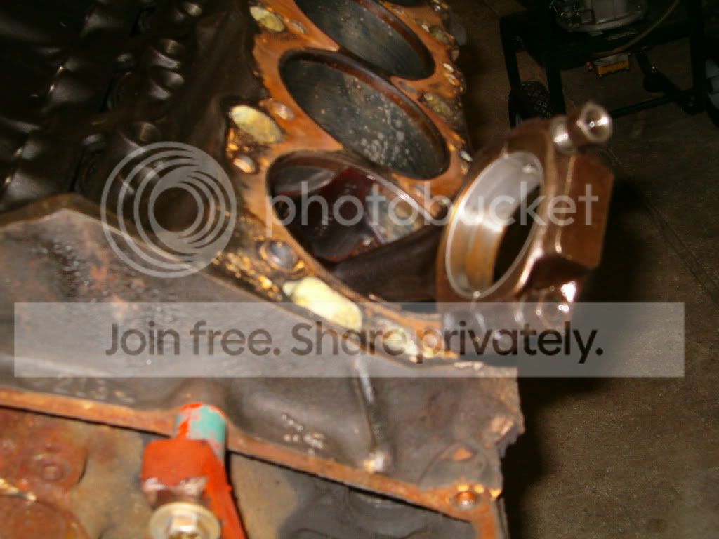

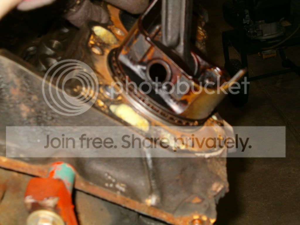

The block is standard bore, and I cleaned the top ridge of carbon, then put a ring in to measure the gap. I used the bolt and stop nut to get a relatively even squareness in the cylinder of the ring. Top gap measured .036. This is in the unworn part of the cylinder. Then I turned the piston upside down to square the ring again to measure down to the top of the piston ring travel area. Gap there was .042, then the length of the piston skirt down into the cylinder, which is about 3.625 inches, not quite the bottom of ring travel, but it will give an idea of how much taper there is to the bore.
Gap at bottom was .040. So taper in the bore is good, however the bore is worn at least .006. too much I think to reuse the existing pistons.
Shining a light from the bottom showed no light between the ring and cylinder wall, so it looks to be pretty round still also.
The machinist will have to make the determination on this though, I don't have the precision measuring tools to accurately check this out.

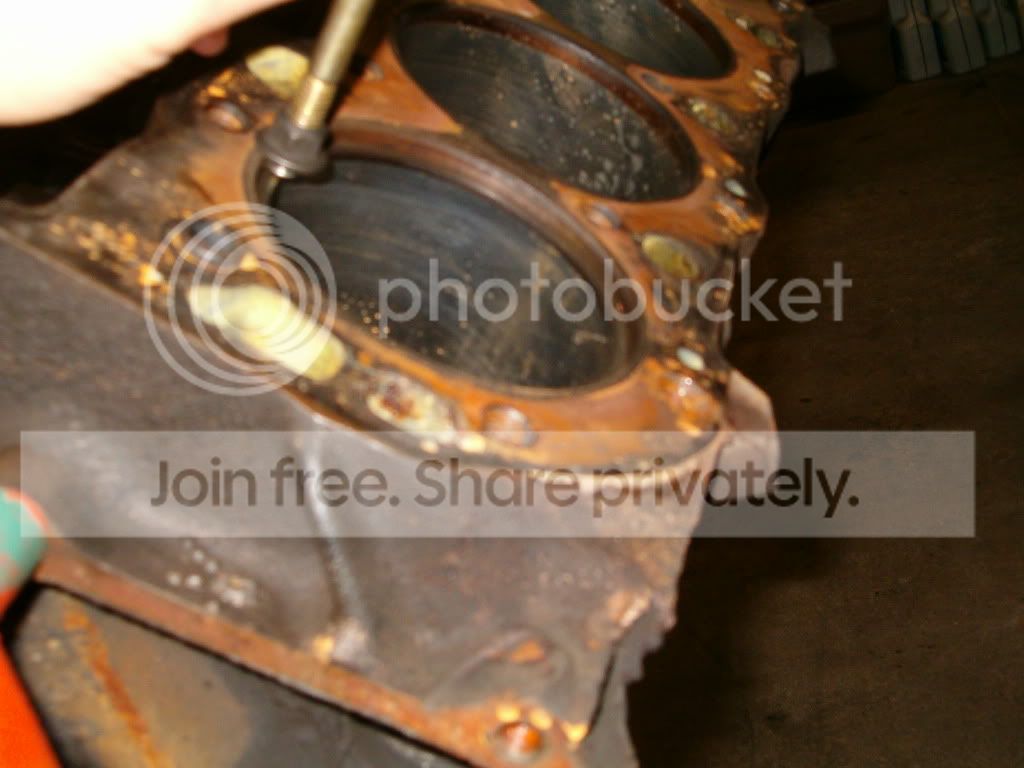

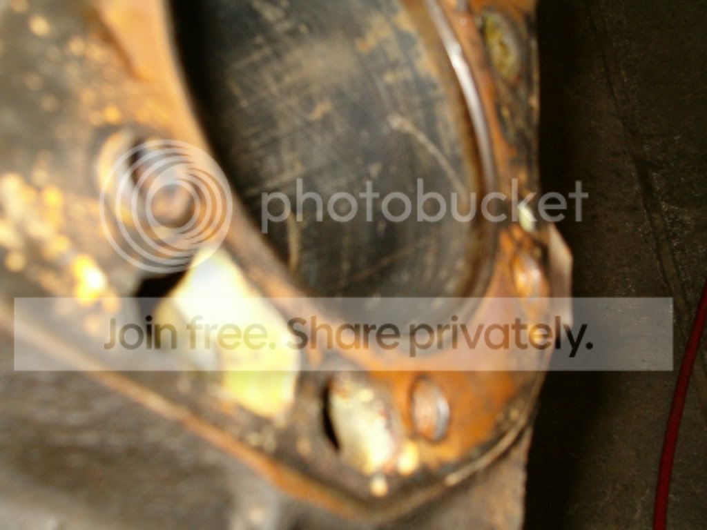

In addition there is this gouge in the bore, which is more than a couple thousandths deep, so it would blow oil by there, so it looks like a bore job is in order.

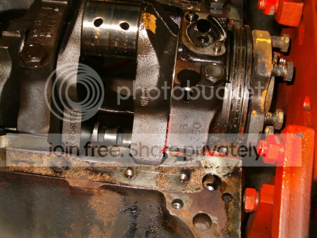

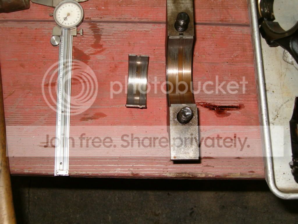

The Crankshaft has already been ground too. I didn't check the size of it when I bought this engine, my ignorance is going to cost me more here too. It already has .020 under bearings in it. So another grind will take it to .030. Machinist will advise on this one, but he said as long as it magnafluxed ok, we would go from there on what to do. The crank mains measured (still in the block) with a set of calipers are 2.75, and rod was 2.178.
This is typical of the bearings I took out:
The crank is a cast unit, as can be seen by the yellow marked parting line on the flywheel flange. Forged cranks have about a 1/2" wide parting line here, where as a cast crank has just a thin line. Casting number mean anything to anyone?

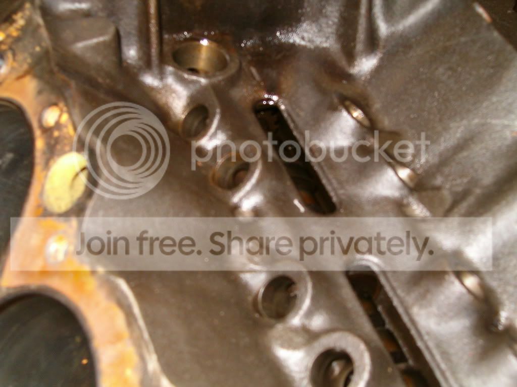

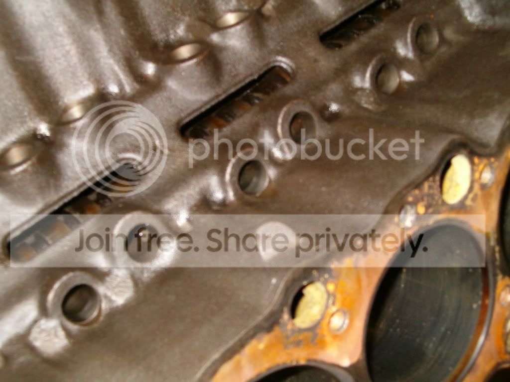

And it looks to me like some of the lifter bores have been bushed. Look carefully, and you can see what looks like an insert in the bore of some, but not all of the lifter bores:

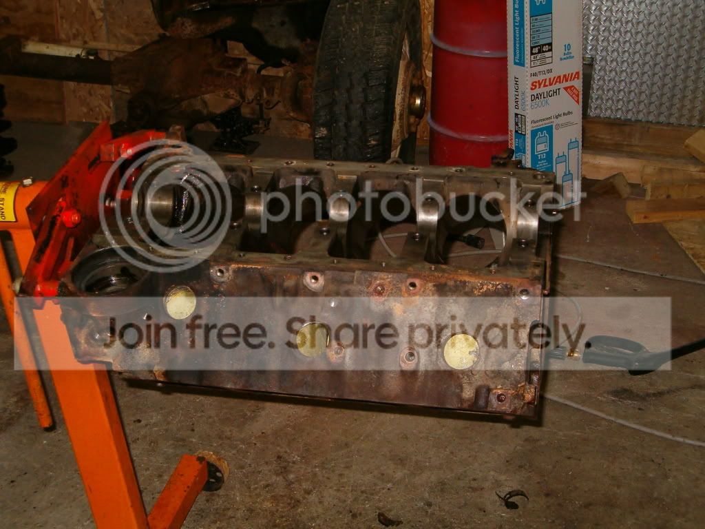

AS PROMISED.....NEKKIDNESS:
Block, Crank, Rods and Pistons ready to go to machinist.
I got the dampner off finally after trashing 2 more puller bolts. I could only find grade 5 bolts, and even using penetrating spray, and a couple doses of heat on the dampner, it finally came off.
I stripped the block of everything, all galley plugs, freeze plugs, and such. The only thing left in the block is the cam bearings. The machinist can take those out.
I also tapped all threaded bolt, and plug holes.
