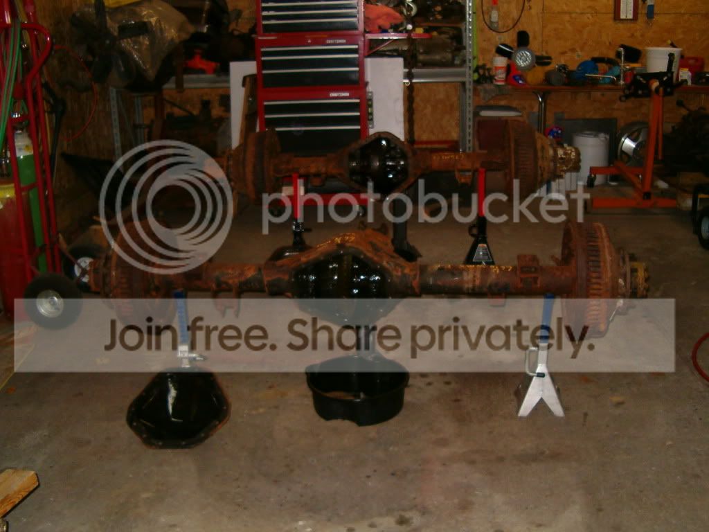

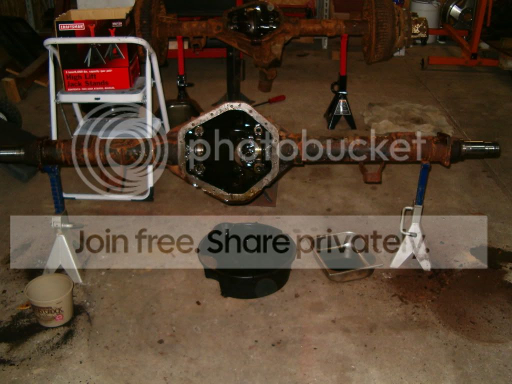

I got my C&C axle, and the 79 3/4 ton axle into the shop today to begin teardown.
I plan to use the diff out of the C&C, and put it in the 3/4t housing, with a Detroit in it.
Here's the two axles:

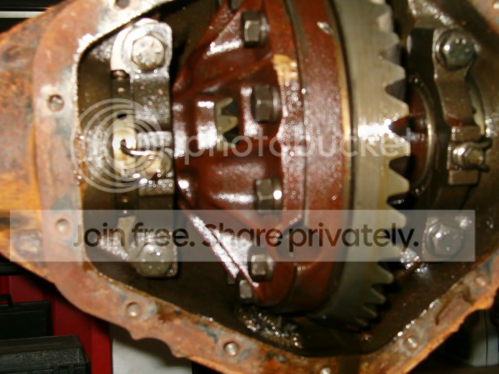

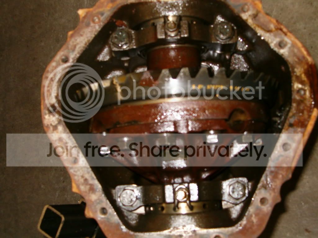

The C&C diff. 4.56 gears and open diff....I was thinking this thing had a gov/bomb in it. I was really pleased to find out it was open.
The 3/4t diff. open also.

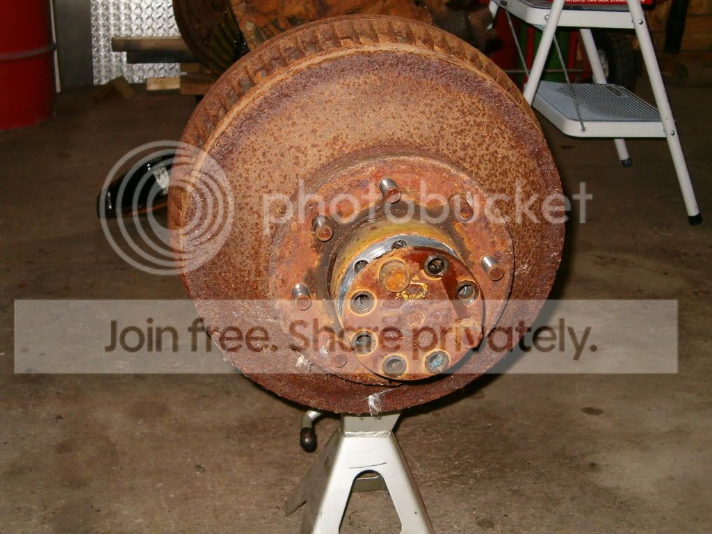

Taking out the axleshafts:

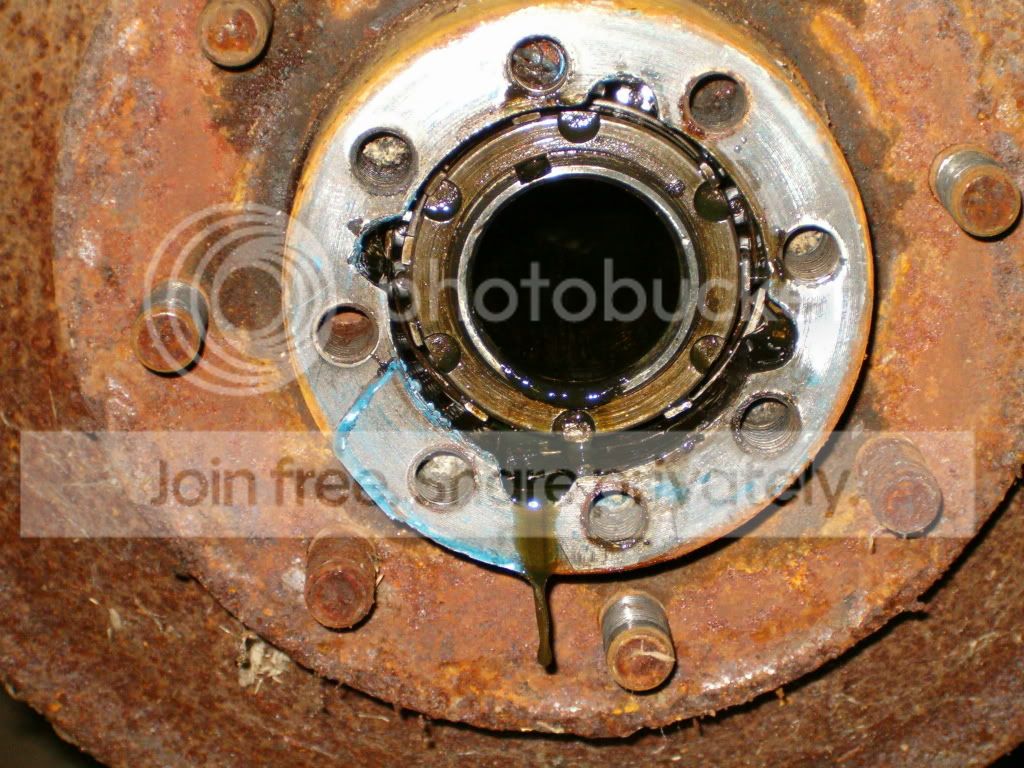

Taking off the spindle nuts:
There is a locking ring first that must have the tab bent up/out of the indentation in the outer locking nut.

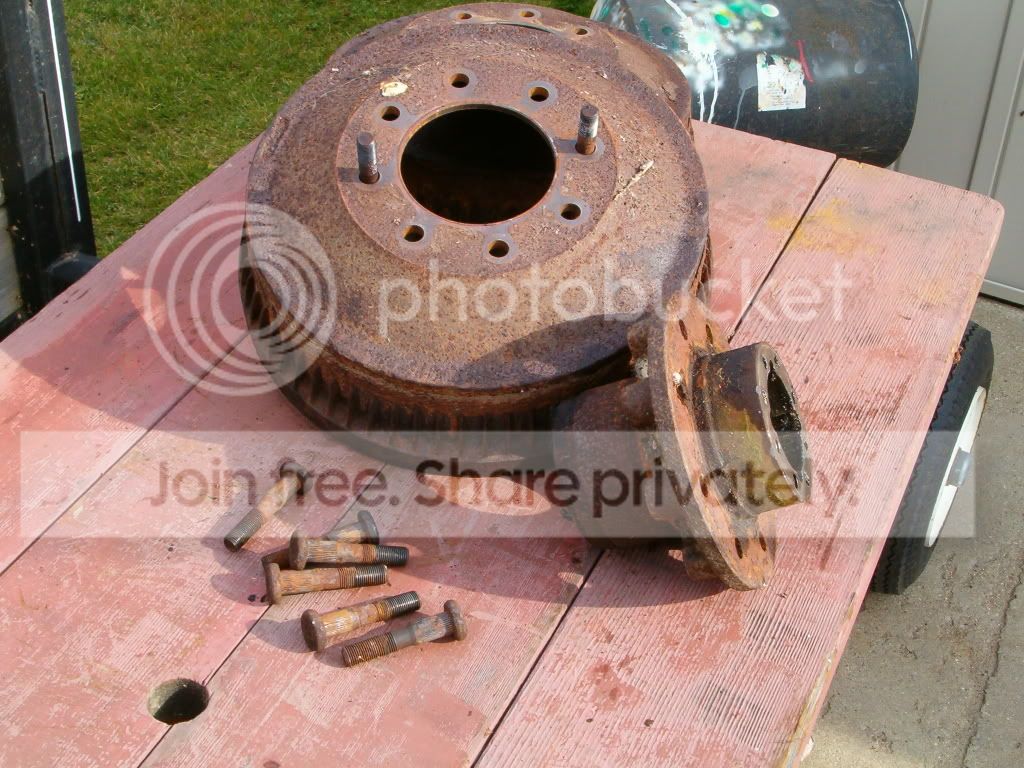

The you need to get the brake drum free somehow. These axles were sitting outside for a few years, and were absolutely a bitch to get the brakes loose from the drums. I ended up taking the pivot bolt at the top of the backing plate off, and pounding it in towards the drum. I beat the hell out of the adjuster wheel, and couldn't get it to budge. After pounding the pivot bolt through, and cutting off the brake shoe holding pins, the drum reluctantly came off with the shoes assembly inside the drum. I also had to slip the parking brake cable off the actuator lever inside the drum.
Glad thats done.

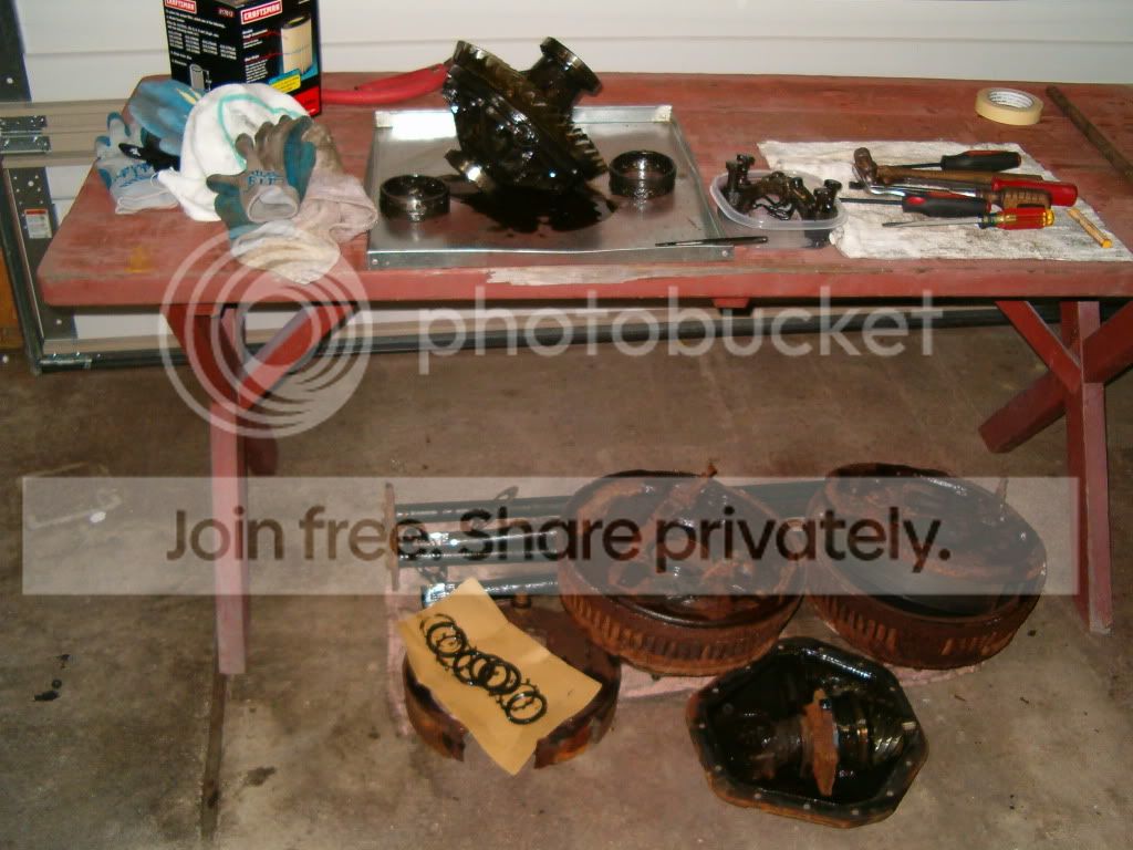

The empty housing, ready to go to the acid strippers (I'm doing this because this housing has rust inside of the axle tubes, and I want it cleaned up good):
And the pile of parts...

Next time try using a t-bar puller to pull the drum off. Works well, and very little cussing.
Martin
Martin
School me on the T bar puller. Does it use the spindle as a center support to leverage from?
http://www.sears.com/shc/s/p_10153_12605_00971566000P
Might not be the correct name, but that is what I have always heard them refered to as.
Thread to longer 1/2" bolts through the bar, into the drum, and put a spacer on the end of the spindle to push off. I just had to do this the other day.
Martin
Yep ok, just a regular puller then. But I mean this sucker was stuck on there. I was ready to torch the drum to break the bond of the shoes, but then just cutting the shoe hold on pins, and the pivot bolt loosened things up enough to get in between the drum and the backing plate. Then all I had to do was disconnect the parking brake cable.

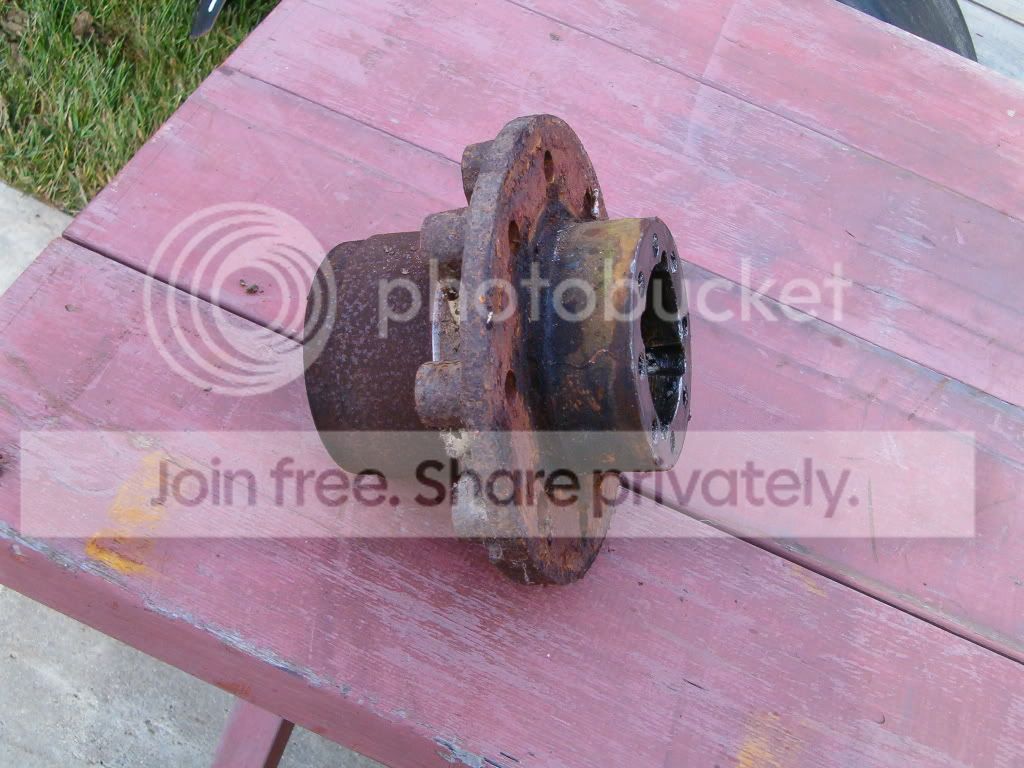

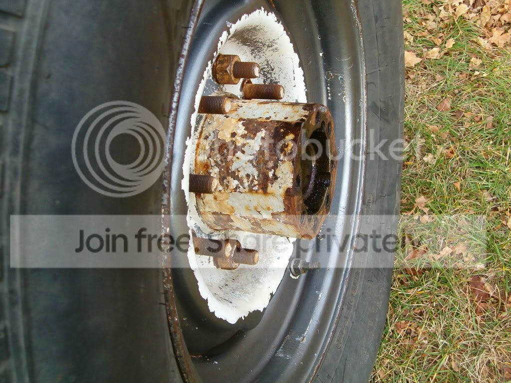

Also took some pics of my hubs today from the SRW (which I will be using)
and the C&C hubs.
SRW hubs:
C&C hubs:

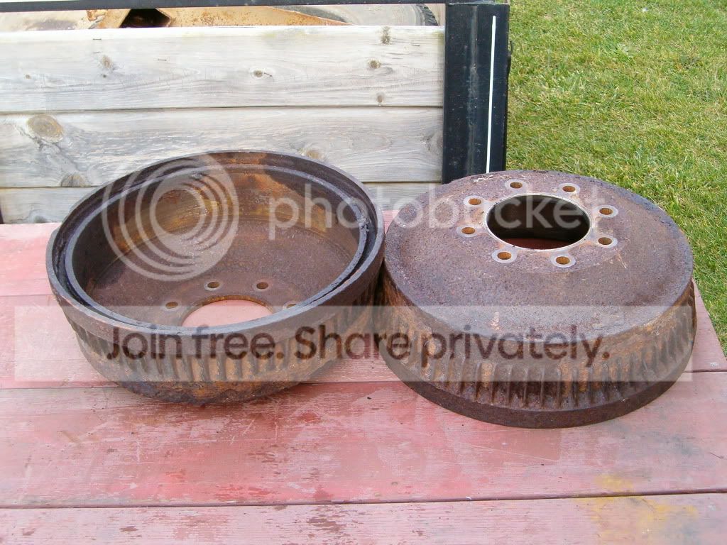

I separated the hubs/drums/wheel studs yesterday. Nice to have access to a 30 ton press.
I'll add these to the metal recycle pile:

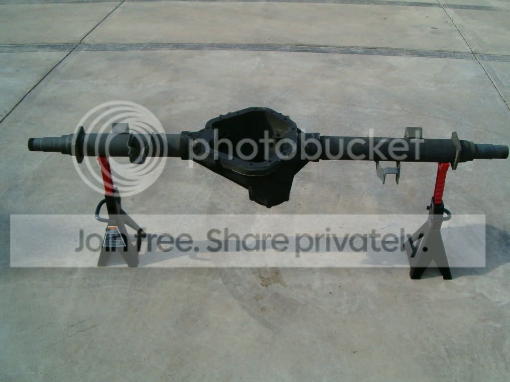

Got my housing from the strippers today, man I love how stuff comes back from them. Like new metal.
