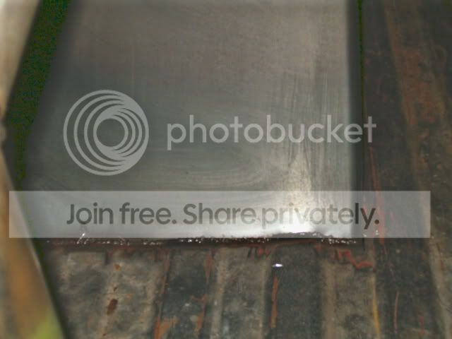

A few tub pics:
I'm not thrilled with the results, but its nailed now....

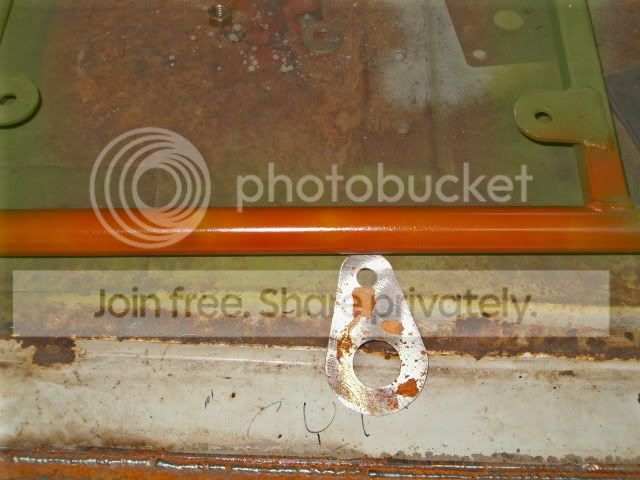

here is the before...you can see the original rusty opening width....notice the rise in the floor pan, in relation to what it is now.

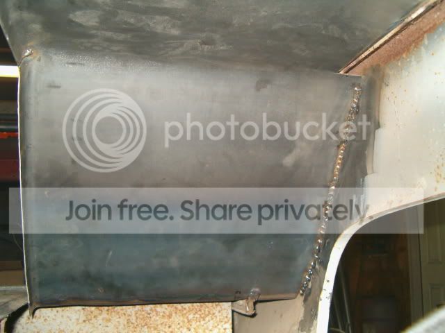

A rear view:
after widening, notice the rise in the floorpan:

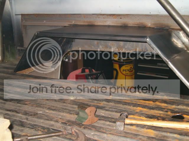

A view from the front seats:
