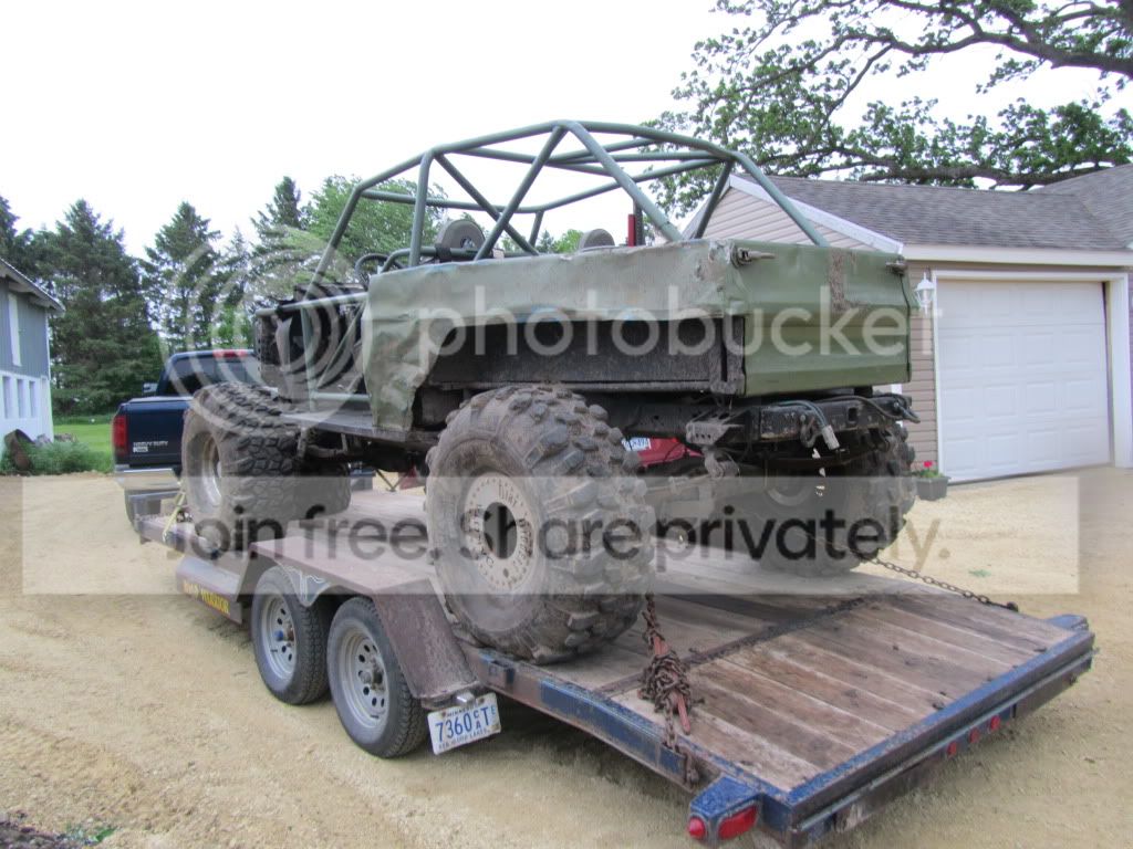

I think the quarters are fine:rolleyes:. Your gonna beat the snot out of them anyway. Then back half it or rip the whole body off and go full on truggy:whistle:

Your right Rick, its not like they're cherry originals....I'm not to concerned with how they look, just get some paint on em.
Uh oh, daves gonna need some more tubing :pimp:
Eventually, but right now that's a long ways off, I just gotta hammer on this thing to get it driveable right now.:popcorn:

Cage paint prep, rear floor quicky paint job, steering column change/rebuild...combining 2 into 1 good one I hope. JK steering shaft addition, rear inner boxside panels, seat mntg, seat belt mtg, center console for a shifter mtg. ya know lots of little things that suck up your time. Really feeling the deadline coming too, would like to have it fully functional by mid august, to work out any issues before BB11.
