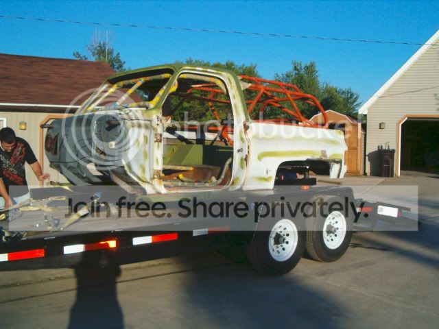

Progress is looking good Zim and I look forward to seeing the body on for the final time (this go round).
And it's Iron Maiden, doesn't it need to be flat black? Or that's too boring?

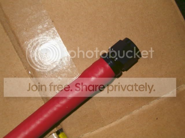

pushloc hose and fitting assembled....Heath it really is easy to do.
run the hose under hot water, put some soap on the fitting, and push!
The pushlocs will be used for engine and trans coolers.
) so you can push the hose with both hands with all your strength, soak the hose in boiling water for 5 minutes to even have a prayer, then pull it out and immediately try to force it on. After you get it 3/4 of the way and the hose is now stuck there, and your fingers are sore and red even though you have leather gloves on from the pain before, then start cussing and cut it off without damaging the fitting and start over. About half the time you could get it all the way on. Nothing like you are desribing, that sounds lovely. But if it goes on that easy, it also makes me wonder how good it really is.
DA the whole thing and clearcoat bare steel

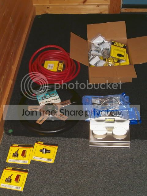

I got it through Jegs, and it was $60/25'How much was that hose per foot?
I hope to do a aux. trans filter, and an aux. cooler sometime this summer and wasnt sure what to plumb it with.

And I'm liking the silver/ gunmetal grey look.DA the whole thing and clearcoat bare steel
Scratches wont show up till they rust and it cant get any easier to color match for repair, just sand and clear again
who cares if it will expose welds and repairs. It'll add to the lookjust give it a douche in some single stage... I could mix you up a badarse peuter-grayish color... that little tint of copperish orange in the gray would match great with the cage..
obviously a metallic would be cool, but as I've mentioned in the past, not advisable in single, plus the coin of it... but a solid could still look great..
Ive seen a few of the HD's with that paint treatment, to me it sure looks like bare metal under the clear.
Almost reminds me of the engine turned metal.
Thats why I said sand it down and clear itScratches wont show up till they rust and it cant get any easier to color match for repair, just sand and clear again
