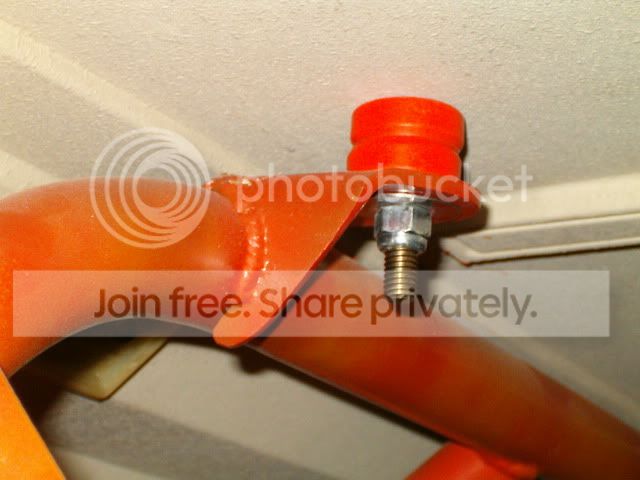

looks like a seatbelt or shock tab bent over
Just found a few pages back where he says it's for a seat mount. Not seeing that on Kert's page but going to send him a message.
What diameter are those bars Zimm? Need to figure mine out.

Zim, where'd you get that bracket exactly? Custom made? Didn't see that on Kert's site the other day.
I likes it.
AJ, they are Kerts angle tabs, but I had him make the tube cut on the opposite side of them from what his stock item is....
My upper bars in that pic are 1.5" AJ, but the tabs were cut for a 1.75...I'm sure Kert could make a few for ya what ever size you want. He's good like that.
