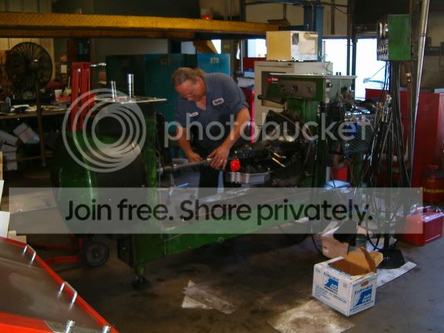

here's what they found, (to the best I can remember, I'm going on 3 hours of sleep last night)...clearances in the front and rear were too tight (my fault, and the other guy for not finding that)
The direct clutch piston was replaced...it was forced into the drum too far creating a groove in the piston and not allowing it to apply as it should, (the other guys fault, and mine for not checking a unit he said was ready to go, but it pressure checked good, I could hear the piston apply????)
The fwd/driect clutch pack needed to be replaced because of the damage....
A new shim in the pump
A new center support snap ring
A heli-coil ???
1 hour dyno test...
Torque convertor pressure and visual test....evidently they really need to be taken apart to check the vanes to see what condition its in, he said go with it.
So it passed on the dyno....I got a much better feeling about it now.

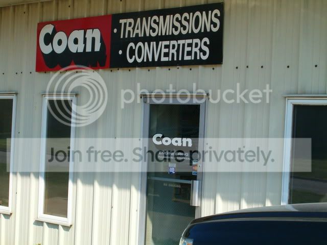

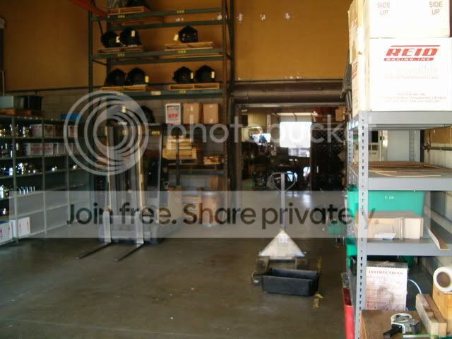

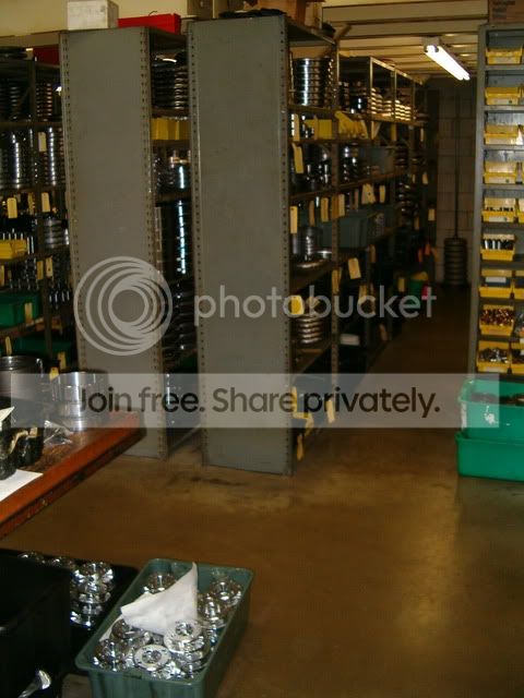

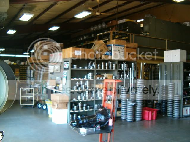

While the tech was working on it, Walker (the guy that got me in on a Friday of a holiday weekend) took me on a tour....this place is way more than I thought it was...they manufacture a lot of their own high end pieces...mostly for highpower powerglides...like suppying 90 monster trucks, terrible Herbst racing, Lucas oil off road team, and too many drag racers to list. It was a very cool tour....They make some real pieces of art that go into the high dollar racing transmissions....a ton of billet stuff.
A few pics of areas they would let me take:
The dyno test:

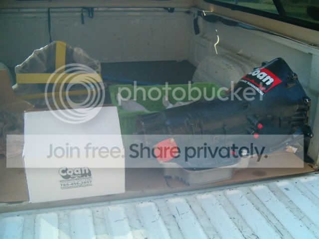

The end result, I'm headed out to the shop with right now:
Total..260$
