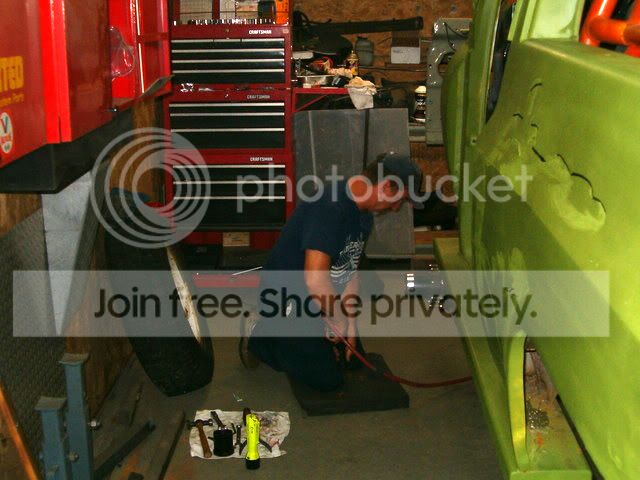

Got the brakes fixed today....interesting find for me...don't use stainless steel hard line...it flares hard, and is hard to seat and not have a leak....with that, we stuggled all day to get rid of the leaks....they will be replaced sometime in the future, but will do for now.

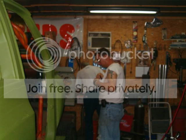

We got a few other things knocked off the list too. Got a lot of help again today, don't know where I would be without it....thanks to all the friends who showed up today..especially Tony....huge help...
And brother Bruce, Son In Law Justin, and my Pop too.

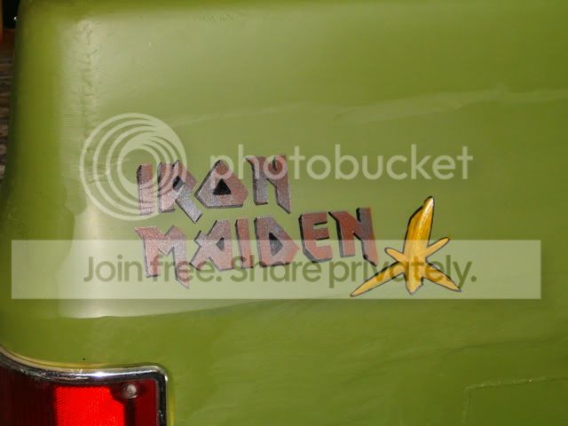

And my buddy Al, did a little artwork...I think this really adds some character to the Maiden!

Today we dealt with more brake line leaks, got em wrapped up now though...I hope!

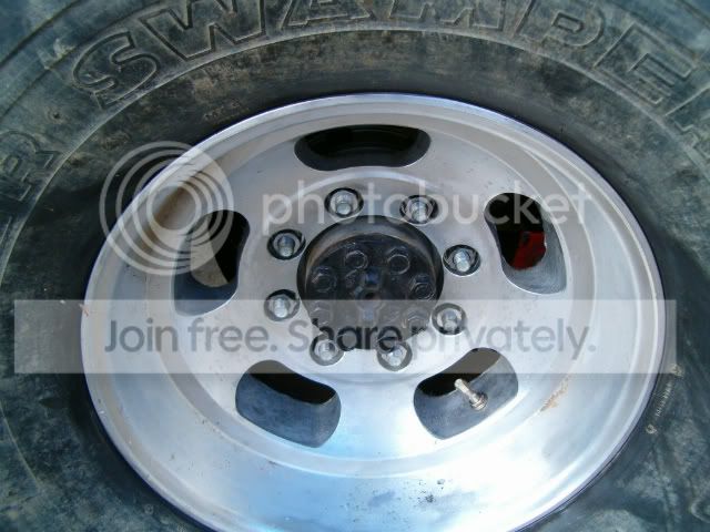

Dealing with some wheel/lugnut issues now...taking a dinner break and will go back at it pretty quick again.
had to cut some of the lugnuts for length, and open end them to fit one pair of wheels....

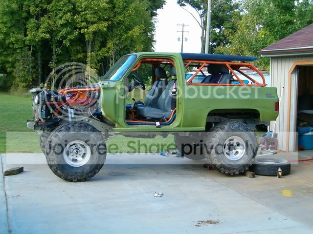

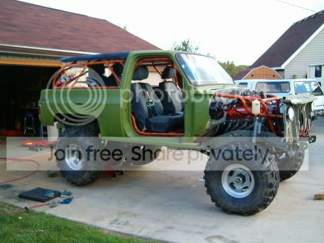

Progress at dinnertime:
Next up sheetmetal!
