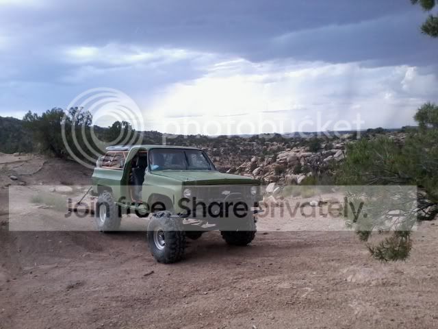

The Maiden has performed quite well, have a couple leaks that we are dealing with, had a rear axle seal go, and took apart the hub to find the outer bearing hammered out of its cage...I suspect I ddin't have the bearing race seated correctly,allowing it to be way too loose in the hub. Anyhow, we (Eric, Keith Blazer, Russell (man I swear that guy has every tool you'd need with him) Keith's brother, Russells buddy who ran for parts 3 times, and Kert and his son Jimmy)....all pitching in, in a motelparking lot to get it fixed. Man how cool is CK5 guys to help with stuff like this? We had to file the spindle smooth, and emery cloth it to be good enough for a new race, and seal. Got those put on tonight, then went to the BBQ tonight. tomorrow kert and I will finish it up and wheel a short trail and get ready to run Pritchett on Sunday. That will be the big test of how well everythng works....We also had to shim the D60 kingpins to get rid of some death wobble, found a leak on the piston between the master cyl and the hydro boost, that we are just watching for now. And I have a small transmission to adapter leak that will require removal of the transfer cases once again to fix it. So for now we're just wathching the trans fluid level.

Thursday we ran hells revenge, which about made me **** my pants when we went up the first fin....a long climb up the backof a rock formation, muchlike the lions back....probably a hundred foot drop on each side, and without Kert watching the pass side tires, Iwould have freaked out....but after we got past that it was a blastout in the trail. the Maiden performed really good, had a slight brake fluid leak... and the axle seal leak had started at that point. we decided to keep an eye on it, but after playing today in BFE we got back to camp and it was dripping outof the seal. we had to check itout.
WE got to play around a bit though withit today, and was anxious to do another trail, but timing just wouldn't allow it, and we decided to fix the leak instead. good thing with the bearing issue that was going on...much longer and we would have not been able to save the spindle. We changed the bearings races and seal on that spindle and dumped the fluid from the rear diff....it was glittery, but didn't have any bits of metal in it like the bad side did, so we will run it as is with new fluid, and I'll dissasemble the rear from side to side when I get it home.

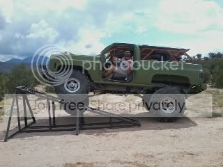

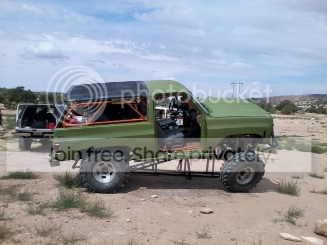

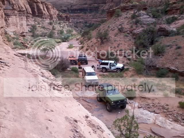

Well anyways here are your pics :flipoff11:lol
Calender pic right here
No idea why those last two are so small...

The Maiden has performed pretty good, the only casualties were minor in the whole scope of the build....that makes me pretty happy. We are still fighting a death wobble, and I will put another shim in the kingpins when I get home for a quick fix, then probably go with a bronze bushing and hydro assist in the future.
The axle seal/bearing is working fine now. the ring and pinion looked real good, and the temps are about equal on both sides of the axle now. and no leaks.
The minor brake leak has fixed itself thankfully. and the problem with the serpentine belt was taken care of with a shorter belt. All was good today except the driver...I needed to be winched up Chewy (on Pritchett), then back down as we decided to turn around due to possible problems with Russells t/c....it was a butt puckering trip up and down Chewy, Eric makes it look easy but for the rest of us....it was a huge challenge. We were in a second group going through Pritchett, and we were pretty much noobs compared to the first group. My thanks and appreciation to Eric for leading us through it, and helping Me especially taking a good line, and helping me to feel confident enough to give it a try.
Later in the after noon we played on a small climb and had some fun before we left Pritchett....then we went to potato salad hill...Eric of course made it look easy, then Chris Perry took it on without issure then Keith made it up, but having problems with a carb'd engine, I give it a shot, and after the third time, I decided I didn't need to get into something beyond my driving capability, so I backed down. I too was having carb problems....Potato salad is pretty steep at the top, and I would start spinning, then have trouble with fuel delivery, the engine would die, and then I had a hard time with brakes to hold it, with no engine power to the hydro boost.
