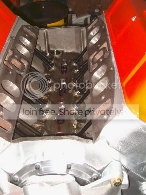

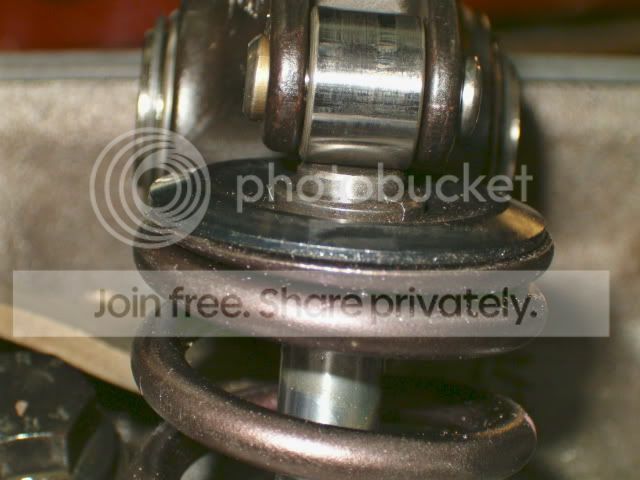

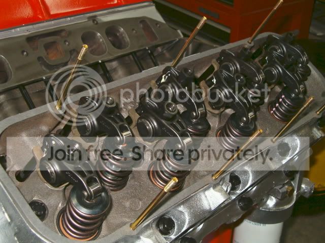

Today got the heads torqued down, and the valvetrain put in, the stock pushrod guide plates worked well, although had to move a couple of them around a bit to get a good contact pattern on the valve tip.
CC rockers and pushrods. K-Motion springs retainers and locks.
The pushrods are .080 magnums, and the rockers are Ultra Pro Magnum or something like that.
