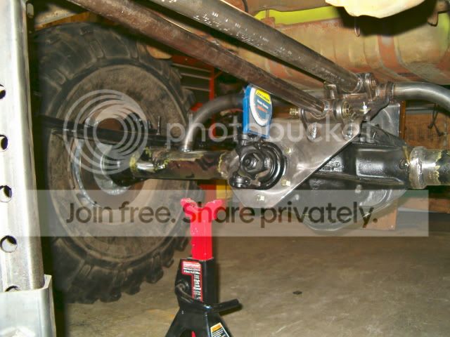

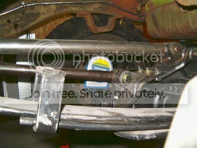

Today I got the DIY4X rear axle truss installed. I had to tweak it a bit to fit my axle. Kert says that although he builds these on a 14BFF housing, sometimes the housings are a bit different in dimensions due to production needs/tolerances.
Anyhow I had to tweak it a bit to get a real good fit without being under stress. I'm liking it...good and stout.
This shows how good it fit after the tweaks and before welding to the axle:
The end results:

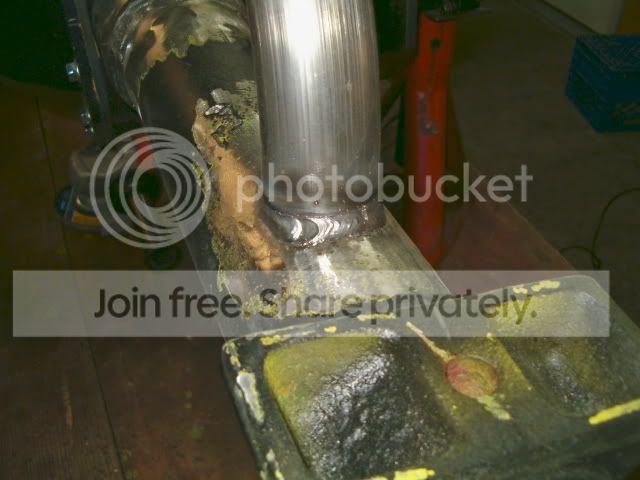

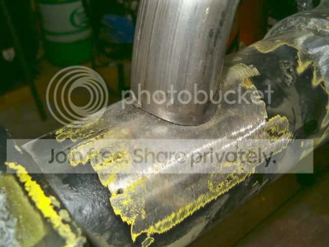

whats up with the heat marks on the tube, that doesn't have a bracket
was that one of your "tweaks"
Exactly...I had to move it about 1/8-3/16" to get it to seat good on the housing without being stressed.

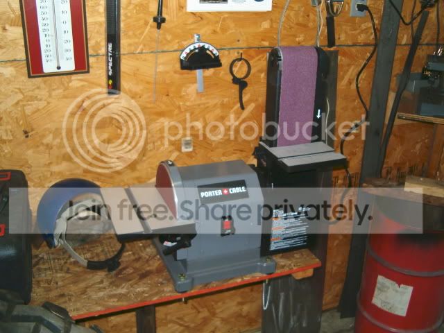

Got my new belt sander today....returned the POS Rockwell unit.
This Porter Cable has a little better setup for tables and an 8" disc.

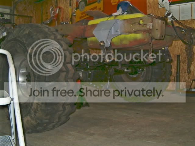

Got the spring perches cut off today....that's about as much fun as removing rivets:
Took all but 2 leaves out of the spring packs to better check ride height and articulation.
With the frame level, the t/c output is @ 5* , and repositioning the spring perches here (just sitting on the axle) the pinion is up about 5*.

The rear is nice an bouncy now. I think I'll tack the perches at the same angle as the t/c output for now.
I can check my shock mounting and articulation in the back then.
How do you know that will be the finished ride hight? I get that you took the springs out for testing but how many are you planing on putting back in?
Or is it a wait and see thing. Will it be a full body or a little cut up"lighter" than stock.
Actually just trying to picture what the rig will look like done.
Shooting for a level frame rail in the end. Right now the perches will just be tacked for further mockup on other items.
We will set the final pinion angle when I get the body back on.:waytogo:

That anti-wrap set up brings the Beef. Very Nice! :waytogo:
Thanks to Kert for that, its a very stout setup.
