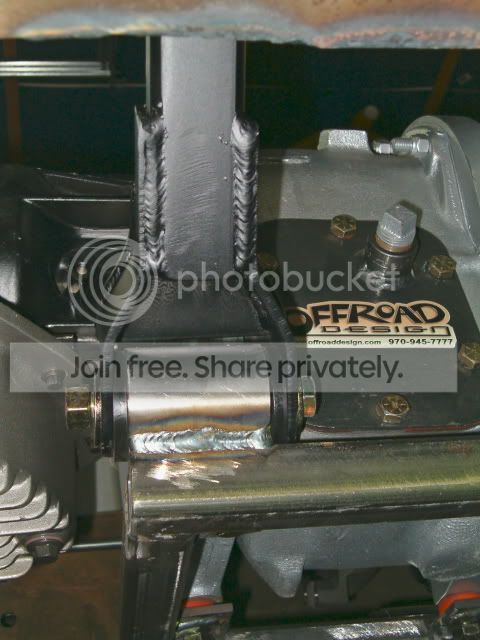

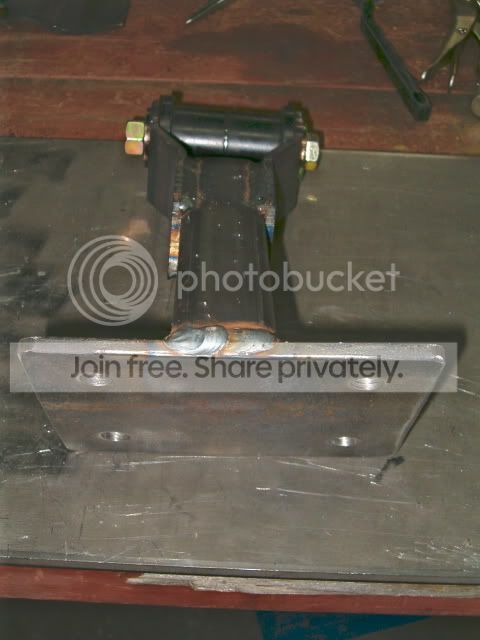

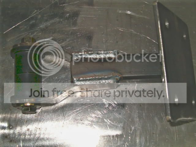

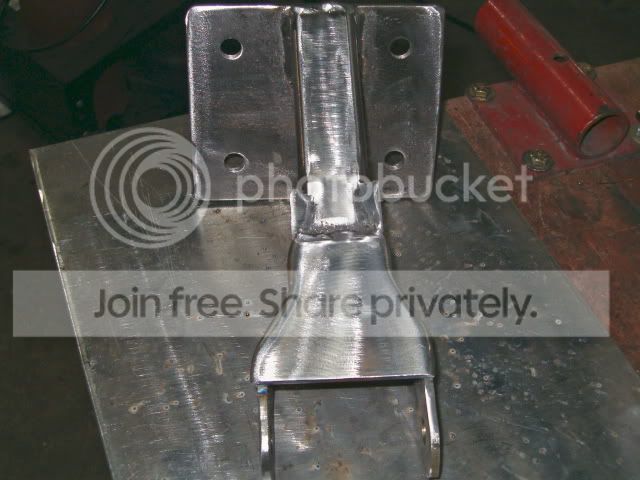

I did get one of the front links to the cradle done today....man this fabbing stuff can drive ya nuts....measure once, measure twice, cut, trial fit....wrong, now make adjustments to the bad piece, cut a little more here, grind a little off that edge to get the angle right....OK better, do that a couple more times and it fits like I wanted it too. Only took a couple hours....:rolleyes:
Anyhow here is what I got today:
This has some twist to it, which for me was a little challenging, the cradle sits at an angle to the frame, which meant going from one plane of the cradle, and twist a few degrees to another plane of the frame....
Installed:
Looks bad a$$, man! :thumb:
Thanks, I'm liking it myself...you know that part looks like it could be done in 45-60 minutes, but its taken me about 6 hours :dunno:.

I'm still not 100% sure about the whole cradle being soft mounted - but the fab quality is very good. Are you sure you are just learning to weld? :rolleyes: :D
BG, do you see an inherent problem with my design, or do you just think its overkill on mounting?

I think the design is going to be fine, you only want the tcase mounts to control the weight, not the torque. If you do decide to remove some of the mounts, in my opinion I would remove the outer mounts, NOT the inner mounts. If you solid mount the cradle to the doubler, then you just moved your bushings out to as wide or wider than your engine mounts, and therefore you are resisting torque through the transmission, which is a bad thing with a high torque big block, it can result in busted trans cases. It may be fine and it may not, but why would you want to take that chance?
The only thing I see that is odd is your angled mounts that bolt to the inside of your frame. They look strong themselves (except I would add a triangle gusset to the bottom), but there is nothing supporting them from twisting the the frame and sagging down, which means most of the weight will be supported by your main crossmember. If both sides were connected somehow it would be a lot stronger. However, since your cradle is mounted in more than one position it will want to remain level front/back, which will transfer some of the weight to the those brackets.
By the way, it's hard to tell, you still have room for exhaust getting by those front brackets?
My only concern is that you have bushings on both ends of the cradle (cradle to frame and cradle to doubler). If you do end up with too much draivetrain movement you can just eliminate the frame to cradle bushings as you said.
I will have to put the torque to it when the time comes to see how much movement there is....an underbody camera would be ideal eh?
