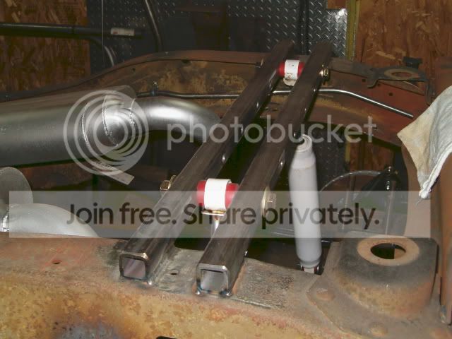

After only having one support for the rear shocks, a double shear just seemed to be better suited for the pounding the dunes would give it, so a 2nd upper mounting bar was added:

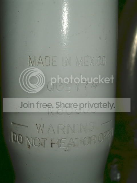

Eric, here are those rear shock #'s you was wondering about...anyone recognize these?

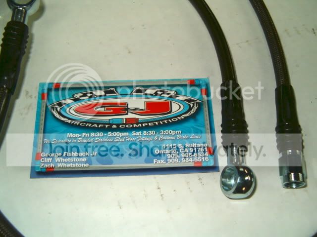

I got my custom brake lines from G&J aircraft today. took them exactly one week to make em and get them to me from CA. Extremely pleased with the quality. A couple members recommended them, and I'm glad I went with them. I don't think I could have got them any cheaper, and they are exactly what I need as I'm using different threads on front -3AN, than the back 3/8-24, and 1/4" lines throughout.
So the 5 custom lines, the anchor tab, the clip, the copper washers, all for 127 to my door.

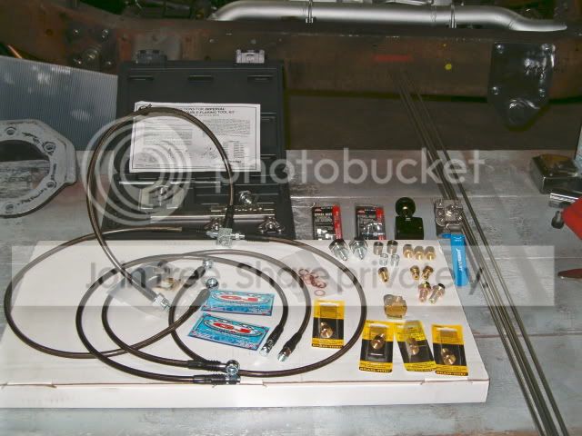

Here's all my brake line parts to begin the bending of tube.
Skyjacker nitros Dave. The 8000s not the 7s They are pretty good shocks
Other stuff looks so nice and shiny too, make sure all the brakelines are properly secured with tabs (something I still haven't done)

quick search comes up with about 12.75" for travel that about right?
