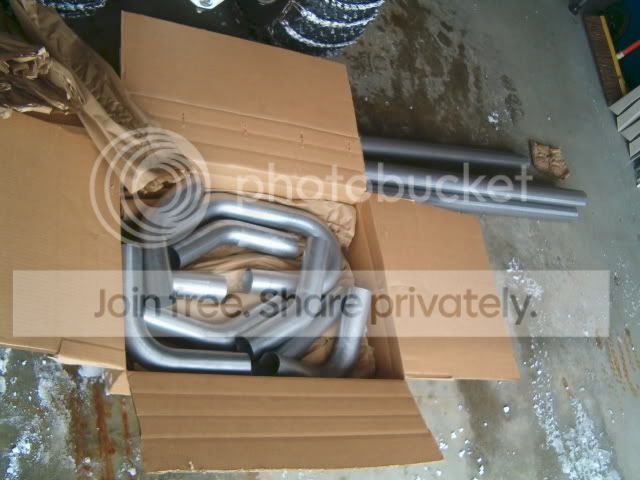

Got my exhaust parts today:
But spent the morning digging out, and clearing the driveway..
the hell you got planned for that ubend+45er there? i can imagine anywhere thats gonna go.
but i can imagine lots of my money is going to that website.
I figured with that piece I could have any bend I want....or two, or more.
its good to have options.
