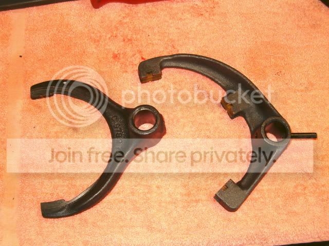

A few more notes about the syncro type 205:
the piece on the right is the syncro 205 type front output shaft syncronizer fork, the one on left is non syncro type, and is used for both front and rear output forks.

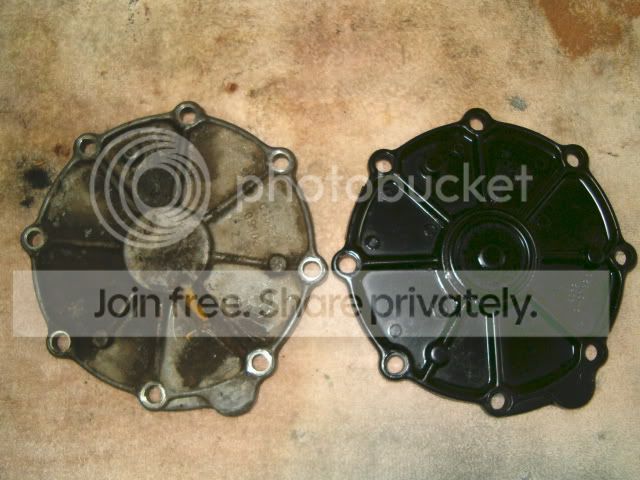

This is a pic of the front output shaft rear covers.
On the right is the non syncro type, the left is the syncro type (note the yellow raised portion...it is the oil feed to the bearing).

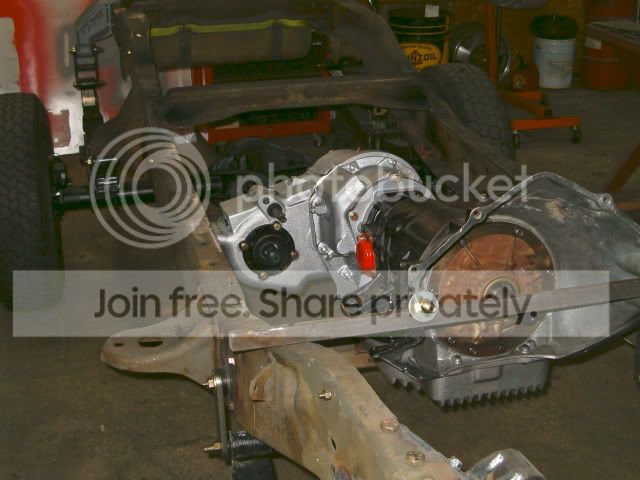

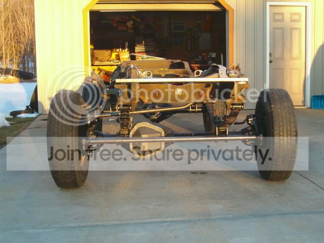

Is the angle of tilt supposed to be about 3* on the drivetrain?
I'm setting at about 8* right now, but its just a few temp supports holding it in there. I will need to get the engine in, and then figure the t/c mounting cage.
The stock location has the tranny pan level and the motor tilted 4* back
You don't have to run it that way. The motor could sit level but you may need to modify your tranny pan so that the pan is close to level.
Thanks, I figured the trans would have to be pretty close to level, but didn't know where that left the engine angle. I'm tilted up at the front pretty heavy right now, as it sits in the pic. I'll get the engine in before I decide what to make for crossmembers. I'm glad I'm going with 1410's looking at the angle of the shafts....but then there isn't much weight in the frame right now either.

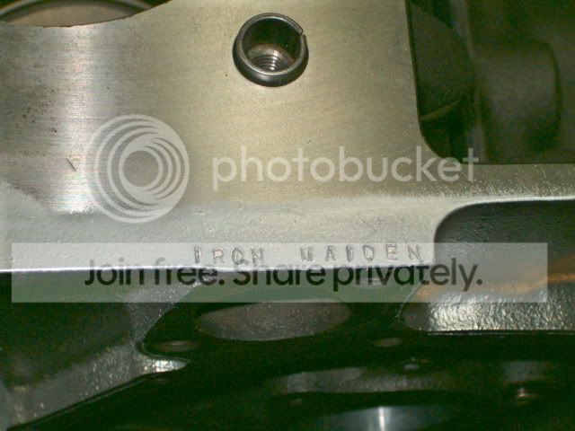

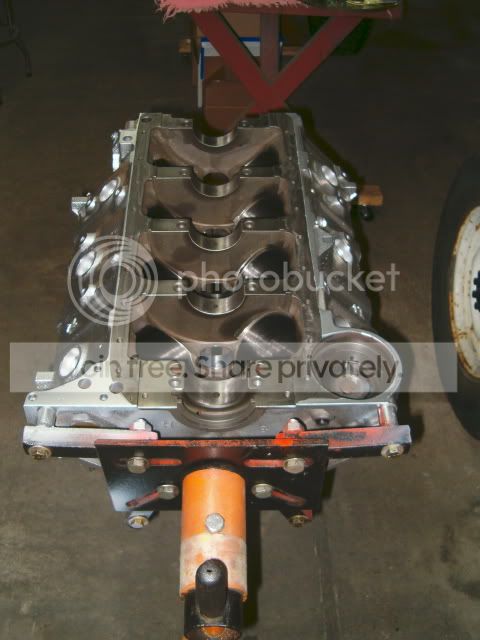

getting started with engine assembly today...nekkid block:
VIN:
Block parts:
AHHHHHHHHHHHHHHHHHHHHHHHHHHHHHHHHHHH
Engine porn
You stamp in the pedigree yourself?
Engine porn
Yeah, I did

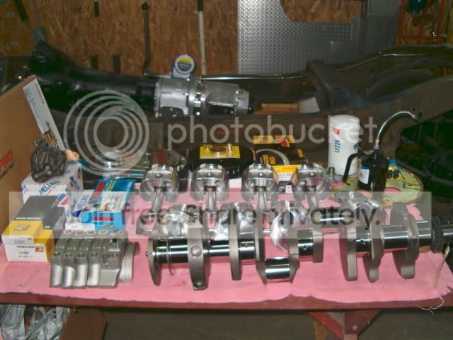

I did get to check the mains for clearance today before coming to work:
checking in it at .002-.0025 for all the mains. Nice. I'm using studs instead of bolts, does anyone know if that changes the torque requirement?

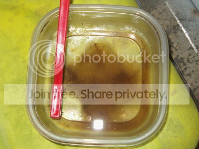

.and a good reason to clean all your tools thoroughly before doing engine work:
This was after cleaning 5 sockets, and a speed wrench, done with brake cleaner and a detail bristle brush, then run a clean cloth through them, kinda like cleaning a gun barrel.
Its something I always do before engine assembly.
Good attention to detail. Most don't think about tool cleaning I bet. At work our tools have to be spotless clean and wiped down with alcohol before we work on anything with tools.
