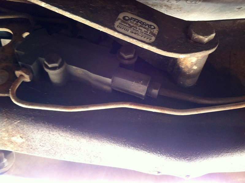

Damn proportioning valve started leaking... And right before im going to take it on a roadtrip... How much of a bitch is it to find and replace one of these? I tried to tighten where it looked to be leaking and all it wanted to do is round off the edge, so I stopped.
You can kinda see the drips on the bottom here.
Yeah, spray it with penetrating fluid, and then work it back and forth with a LINE WRENCH.

Yeah it looks like it. Its the wettest by the right hand line. I don't have a line wrench. I suppose I can go buy one though.

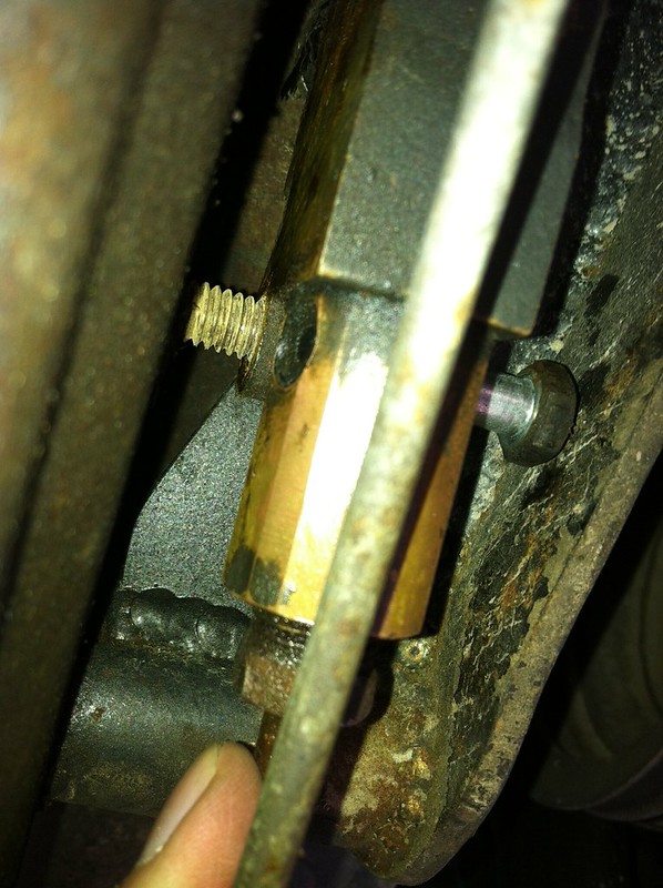

It's not the line. It's on the back side of the small brass piece to the right. There's some kind of hole on the back of it and the fluid comes out everytime you hit the pedal.
