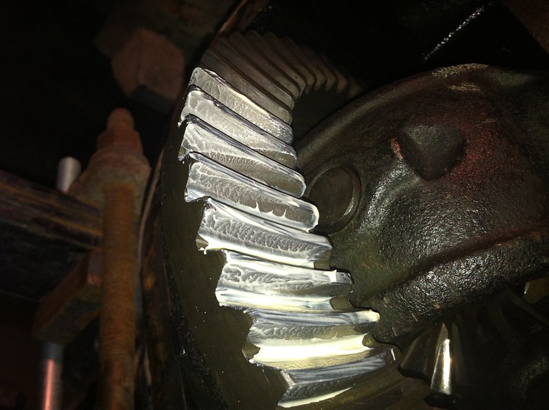

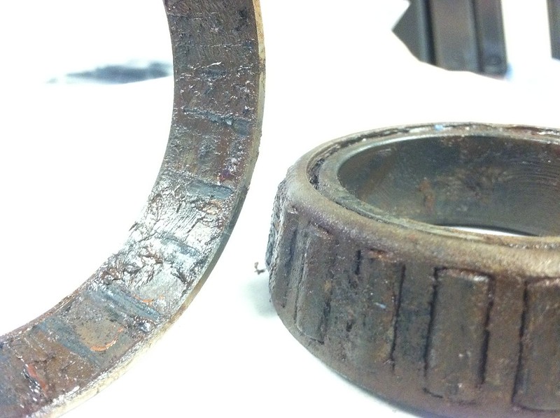

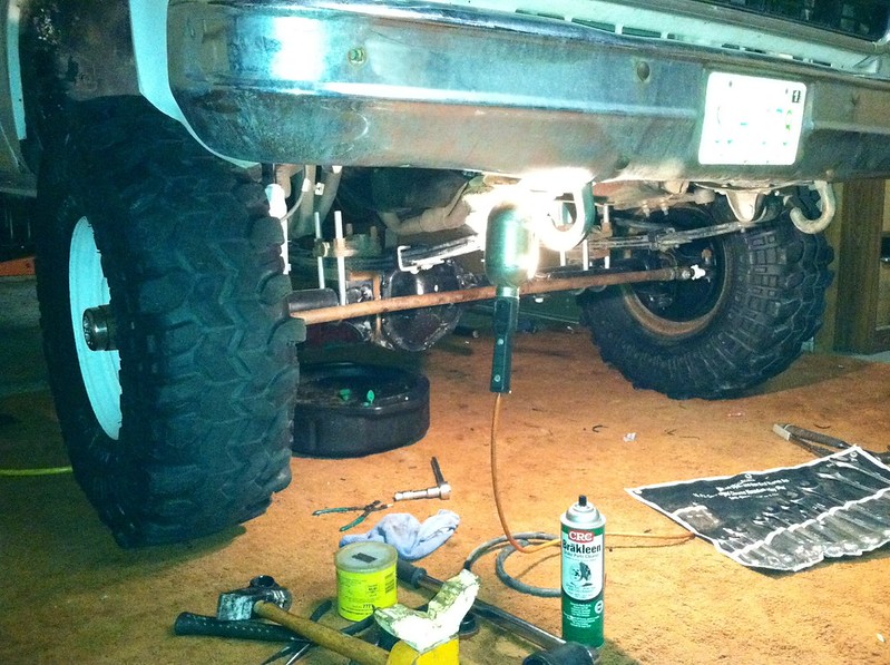

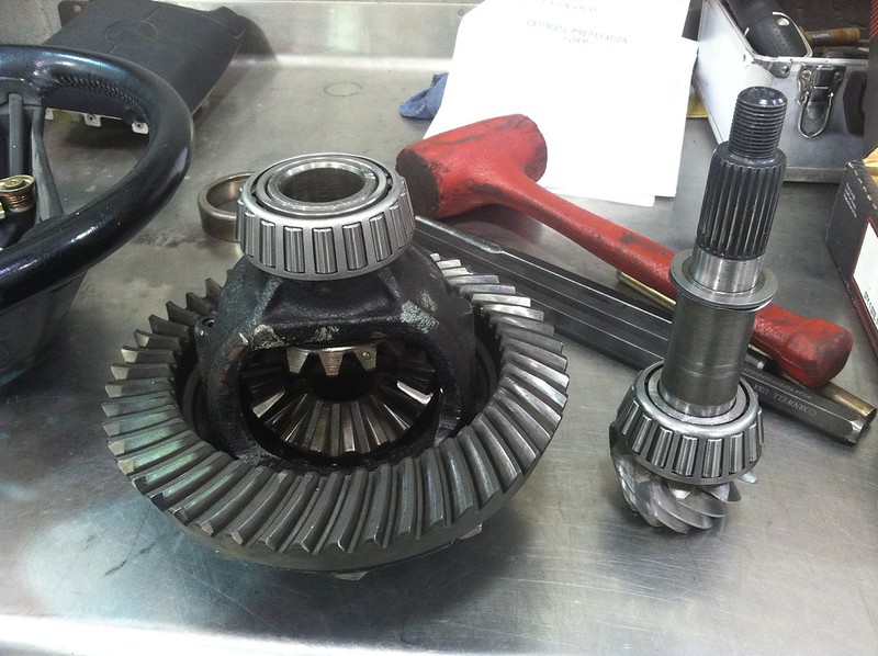

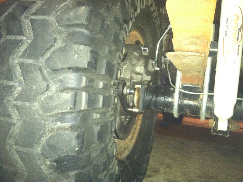

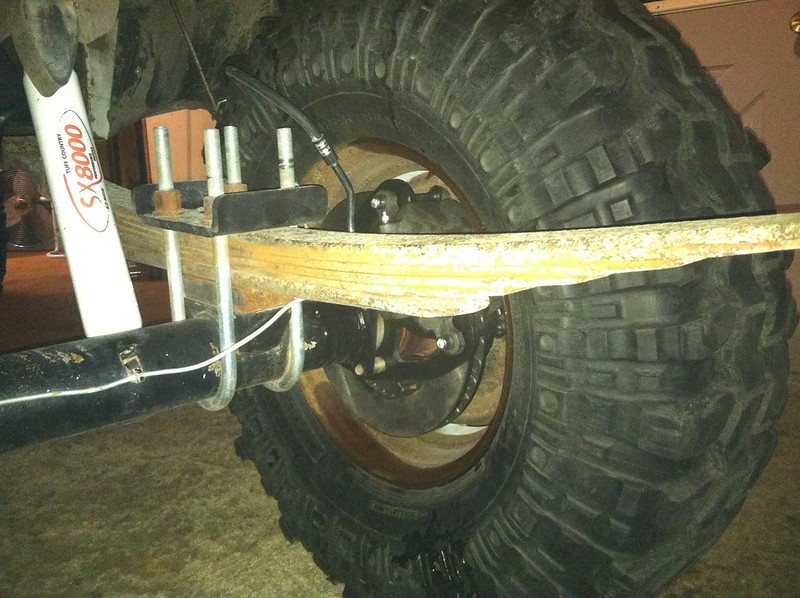

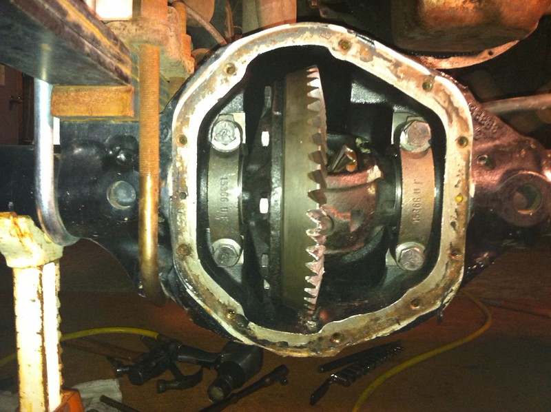

The 44. Everything looked good the the 14 bolt. I ended up getting a bearing/seal kit for the 44 since almost everything was messed up. Im going to think twice about playing in the water now. Too expensive to do this everytime. Granted, I found out I had a giant hole in my breather line that probably let it most of the water...
Yeah, your 44 was probably due for seals and bearings anyway. My Dana 60 looks fine after that last trip with all new seals and bearings. I think those outer axle seals would be a good idea too.

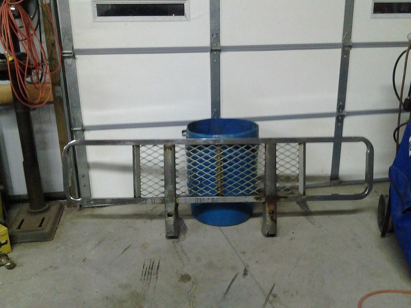

So I bought this cheap grille guard off Craigslist and im wanting some opinions on what I should do. Its kind of rusty so should I put it on as is, or paint it? Or what? Im thinking I will just put it on as is, but im open for ideas.
