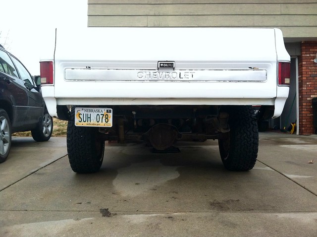

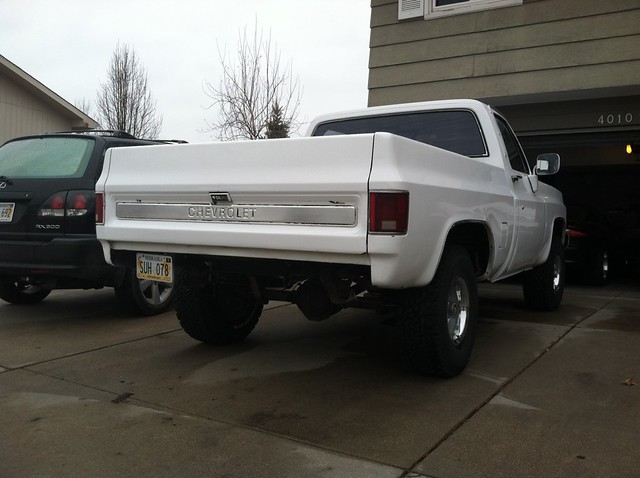

Decided to take the rear bumper off and get rid of the POS hitch that was welded to the frame. Also cut the tail pipes off so now I have dumps. Tail pipes didn't bother me, but they would've had to be taken off when I do the shackle flip anyways. I think it sounds pretty cool and looks better like this now though. :D
I want to build/ or have a buddy's Dad build some kind of bumper with a hitch eventually.
haha yeah, pretty much. I want something that somewhat protects the rear box area as well.
Well, it looks better than it did.
It looks like your rear cab mounts are shot. The body lines don't match up. You have a nice truck though. I had an 86 K10 that looked exactly like yours.....with a sloped hood of course. :rolleyes:

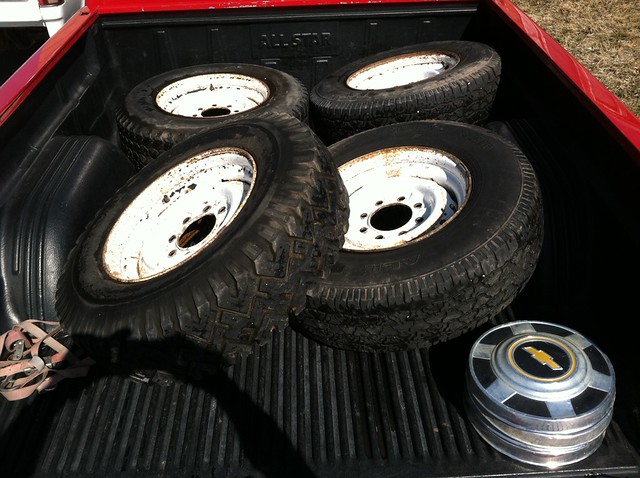

Found these 16.5's on Craigslist yesterday and picked 'em up for $75. Center caps are in great shape.
Set them next to the K10. It looks saawweeet.
That is going to look great. You need to get those 3/4 ton axles under there. I just sold one of my sets......

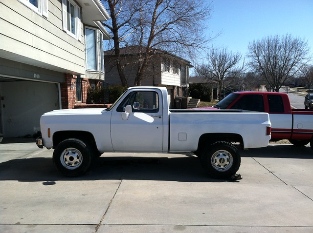

Went to the local swap meet and got a new GM bowtie for the grille and a Scottsdale 10 fender emblem. Still need one for the drivers side though.
