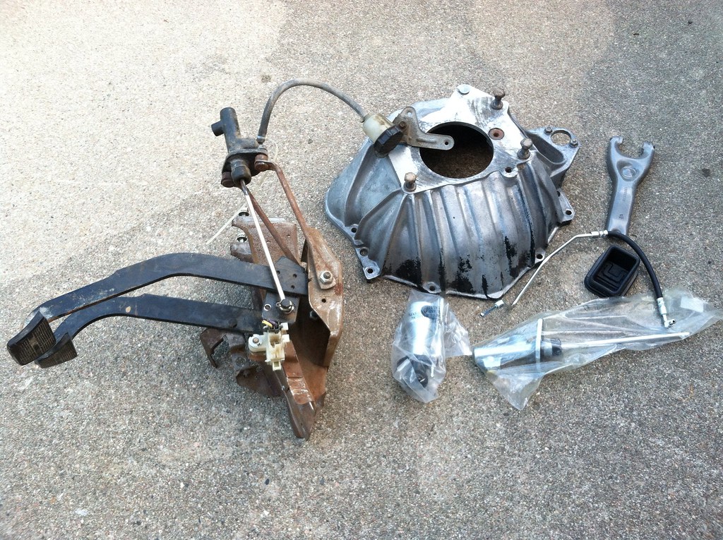

Have just about everything for the Hydro clutch.

No, haven't even started. I'm doing an engine swap at the same time so it's gunna be a little while yet.
