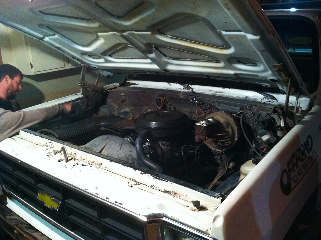

It's powered though a relay. Send constant fused 12v to the relay then power to pump out of the relay, triggered by the fuel pump signal from the ECM. Along with that there ignition power to the coil, injectors and sensors. I'm sure people have more professional ways to do it but this is the simple way and I've had my truck running good on it for a while now

Yeah took it on it's maiden voyage last night, just around the block cause it was about 10:30 with open headers. Starts up and revs good, but has a slight miss when giving it a tiny bit of throttle. Also falls on its face when I floor it. Lots of little bugs to work out still but I am happy that it runs and drives.
