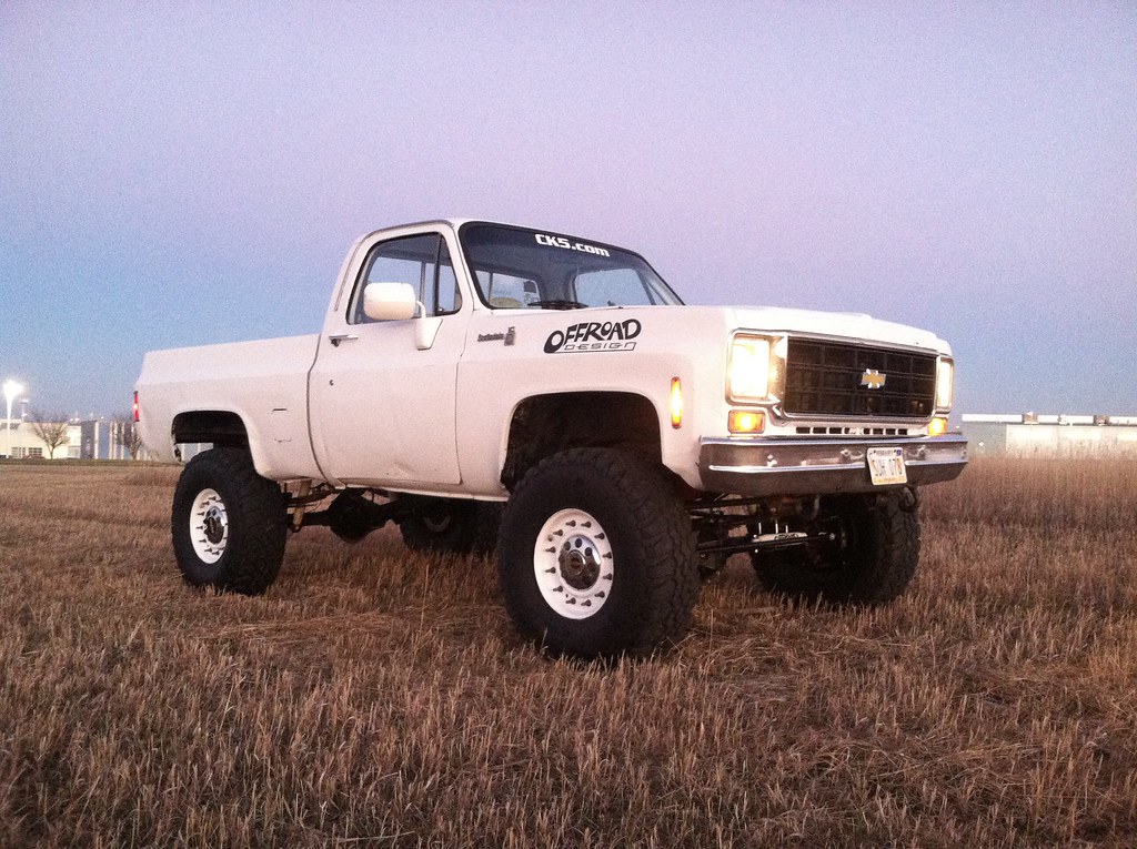

Cleaned it up today at work so I took a picture. Hopefully going to do a little pasture wheeling at my buddys farm tomorrow, so we'll see how it does.
