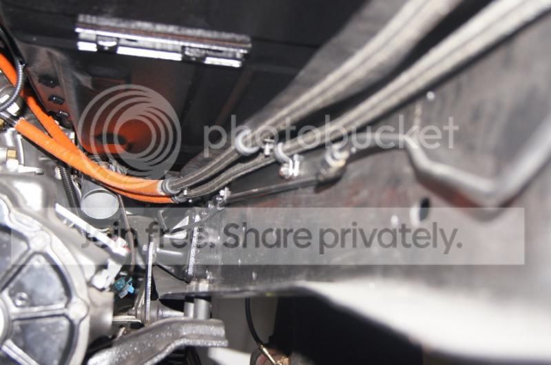

Still working on my fuel lines. Got them mostly side by side for the length of the frame, much cleaner. They are mounted with stainless steel bolts, stainless hose clamps. The inner line is the return line, and the outer most line is my main fuel line.

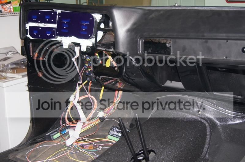

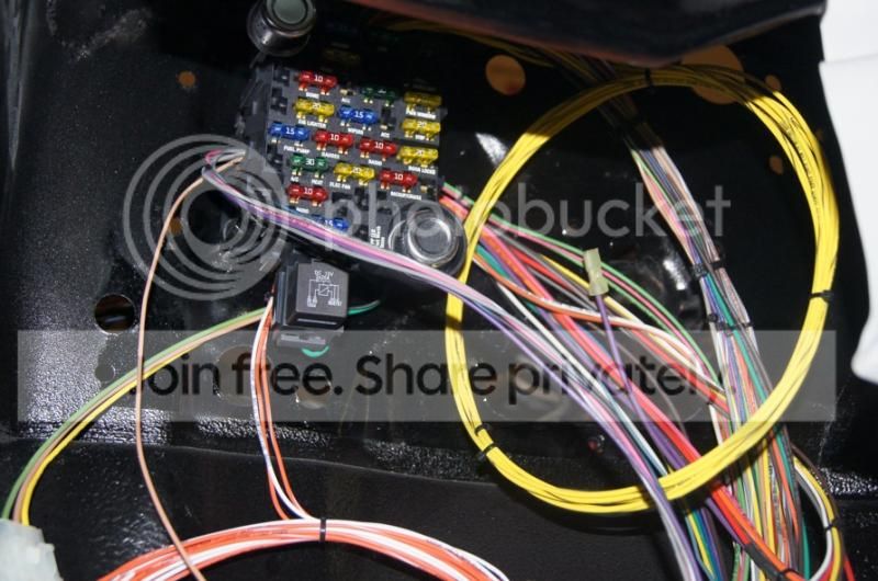

Doing a COMPLETE rewire. This is a painless performance chassis kit. Pretty swamped by the mess of wiring, no real idea where to get started.
From no stick to twin stick!! Those are dakota digital guages. Doesn't help with the wiring complexities really, thats for sure. I just know it'll be awesome when I'm done.
FYI: replace those collars on the T-case crossmember with a full length 1"x1" square tube. Those collars like to bend/ crack the frame when used that way.
Otherwise, nice build. I feel ya on the wiring harness. I did my K5 and am about to start my C10. Never fun
^ I agree. Whatever you do, do not rush through. Take your time and route and hide the wires correctly.
