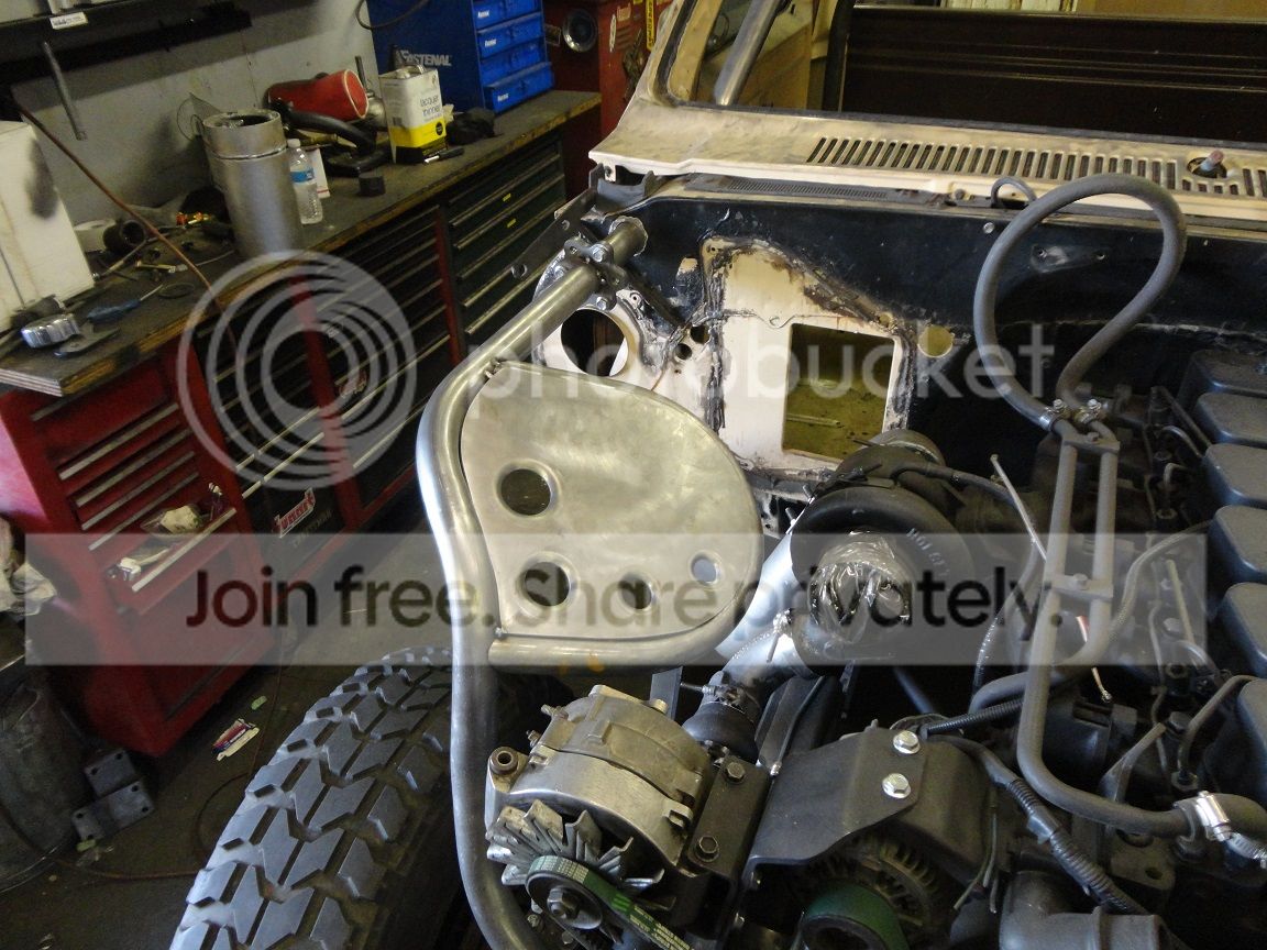

Top of the shock hoops tacked in place.
Somebody had asked for pics of how the cage is connected to the frame. Here's a couple shots.
Keep in mind, we're using our pseudo polys right now. When final assembly happens, we'll switch out the aluminum for the actual poly urethane.

Nice work Kert, maybe I missed it but are there more supporting struts to those shock mounts?
and he makes it look so dam easy too.....
from years of pulling the trigger!:waytogo:
Thank you!
There will be a bar that wraps around the rear of the engine. I've also looked at making a small kicker down to the frame with another poly joint to isolate it.
I'm going back and forth on the kicker down to the frame. If I do that one, it will certainly be in the way at some point. Would add a lot of strength and resistance to twisting on the hoop itself.
I'm running bilsteins with a fairly heavy valving in the front so there will be the potential for some flex. Decisions pending.
