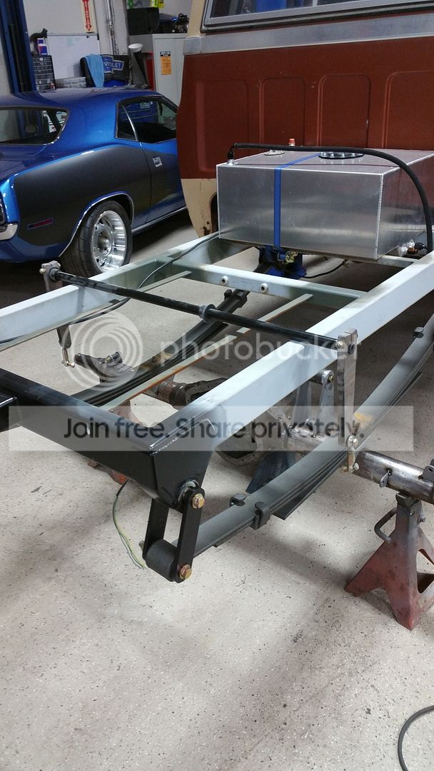

Check out this hackery contraption of rear suspension. Leaf springs with coils up front?

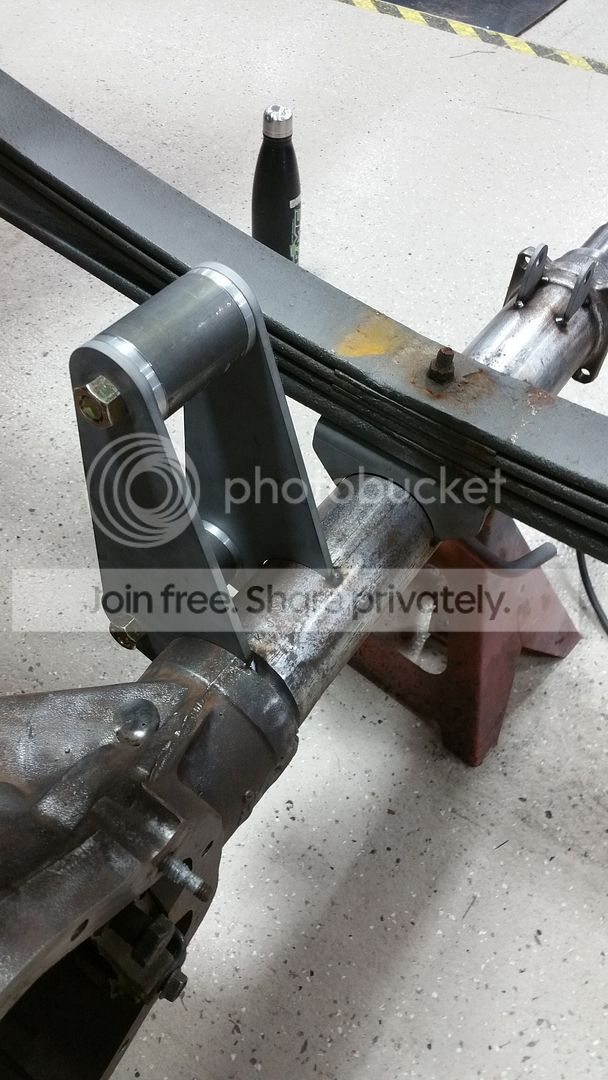

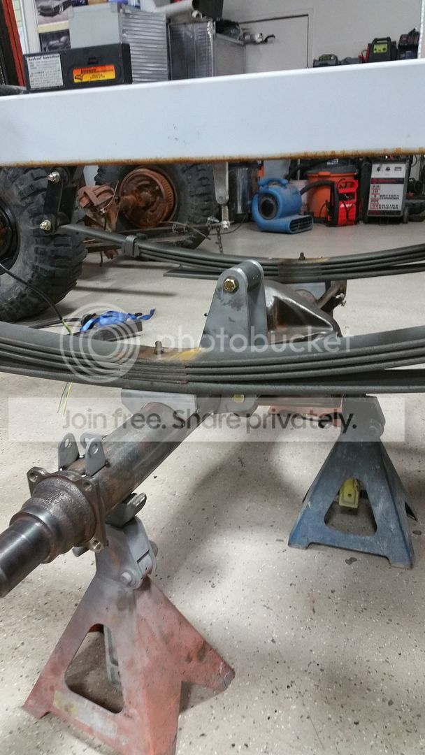

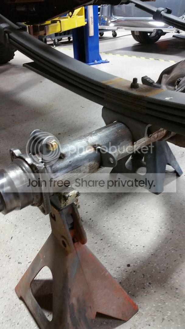

I've been slacking on the updates. I got my 2wd gearbox rebuilt and drilled for hydro assist. Currently working on getting the rear axle finished up. Headed to pick up another housing since the previous owner destroyed it trying to cut the brackets off.
Borrowed UNCLE RICKS F450 and headed to @82355 squarebody sanctuary to pick up a housing.
