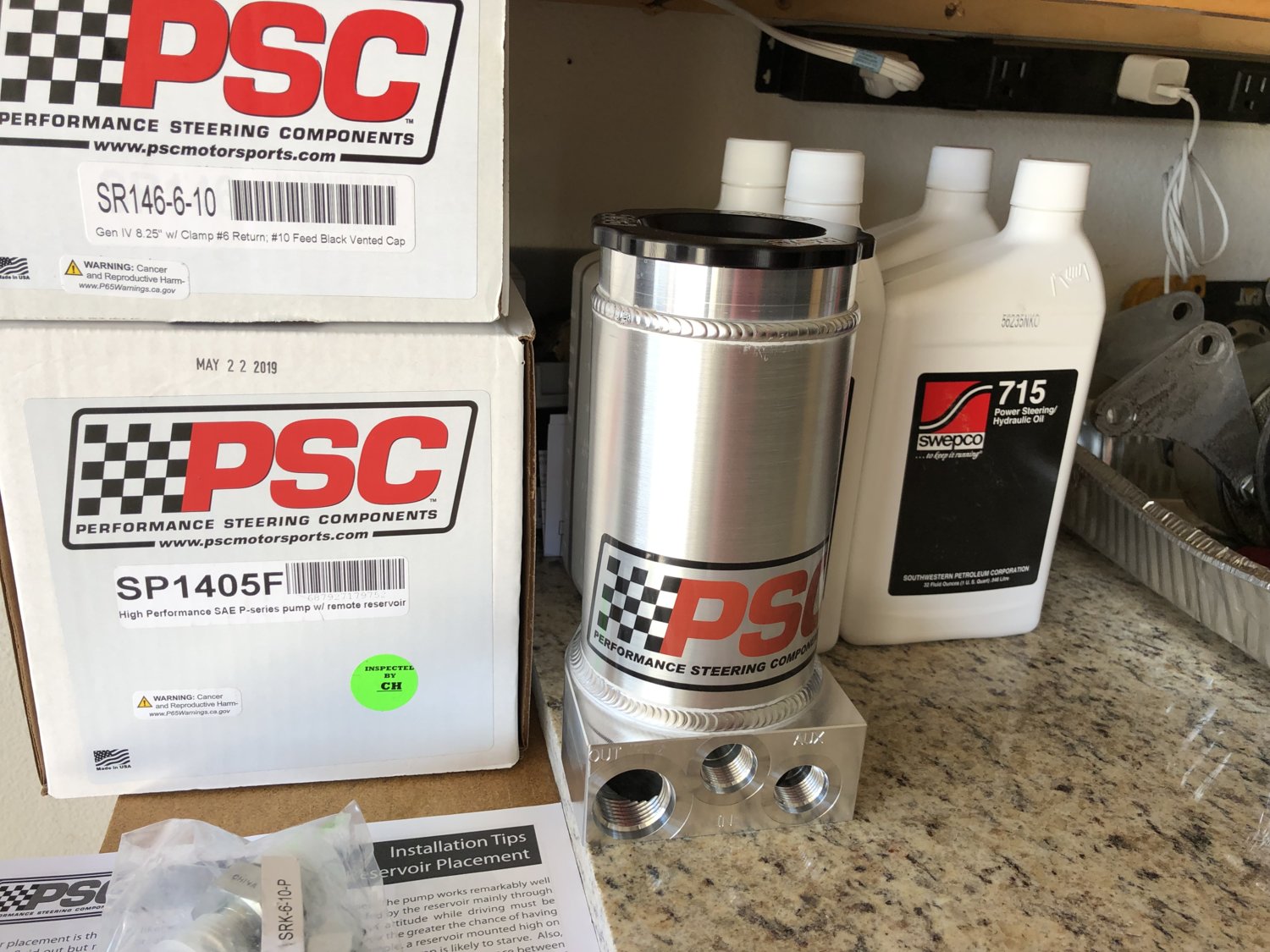

I ended up buying another pump and upgraded the reservoir to the newer 8.25" version.

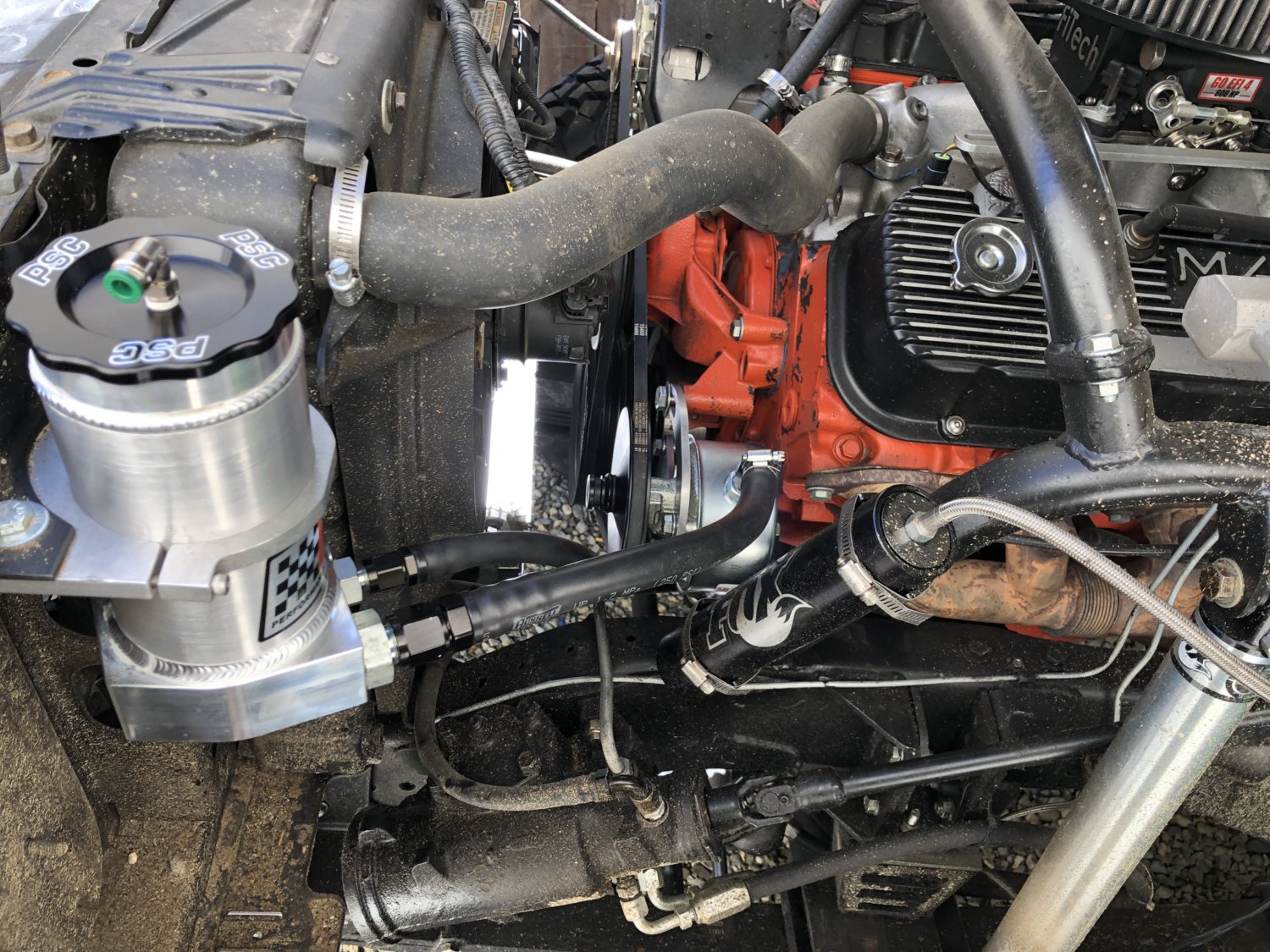

I used a single groove pulley this time so I can access the mounting hardware easily without removing the pulley.

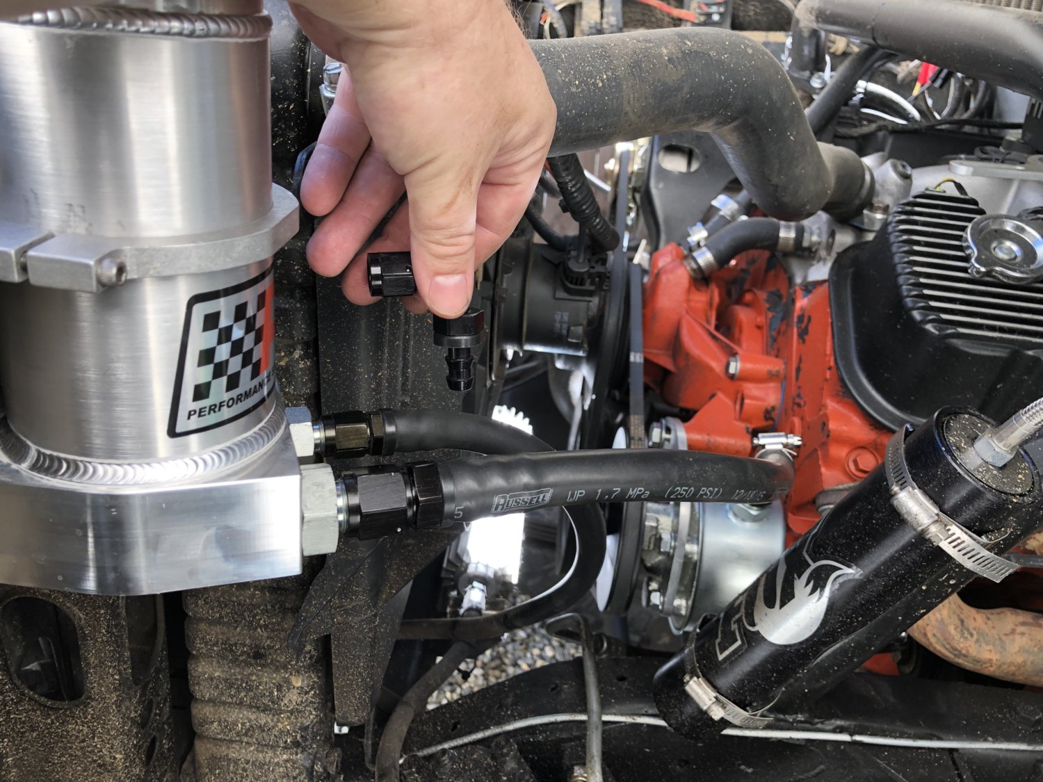

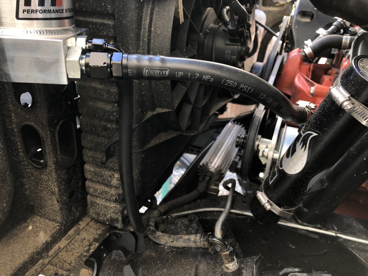

I'm trying to decide if I want to add a 90 degree fitting at the return on reservoir from the cooler. It would be smoother from a routing perspective and I can't find any reason to avoid the 90 (use two already as well).

I'm trying to decide if I want to add a 90 degree fitting at the return on reservoir from the cooler. It would be smoother from a routing perspective and I can't find any reason to avoid the 90.

Less strain on the return hose that way
Only thing I can think is the straight fitting would provide smoother flow than the 90, but not sure that would matter much.
that was my only concern however the consensus says it's OK as long as the fitting is smooth without reducing the ID.

I personally wouldn't worry about any strain on that return hose from just the weight of it and the oil inside it. Yes, it can bounce around, but will it really bother?
And I doubt that a 90* fitting would cause any restriction there, as long as it was a full flow fitting. But it looks like you could run it along with the line out to the cooler, similar to how you had it before, if you used the 90.

I actually did -8AN on all my returns but a lot of that is because I have hydroboost brakes so I wanted the best flow I could get. I also did -12AN on the feed to the pump. So I'm always thinking about flow on these systems.

I was rethinking the low pressure lines on my setup a couple months ago after it failed. However after speaking with the PSC tech, reviewing PSC documentation and looking at other builds I decided it was overkill for my application. I also noticed the pump inlet is tapered down to 10AN anyway....
Went ahead and installed the 90 degree fitting so I should be able to add fluid and bleed the system now.
