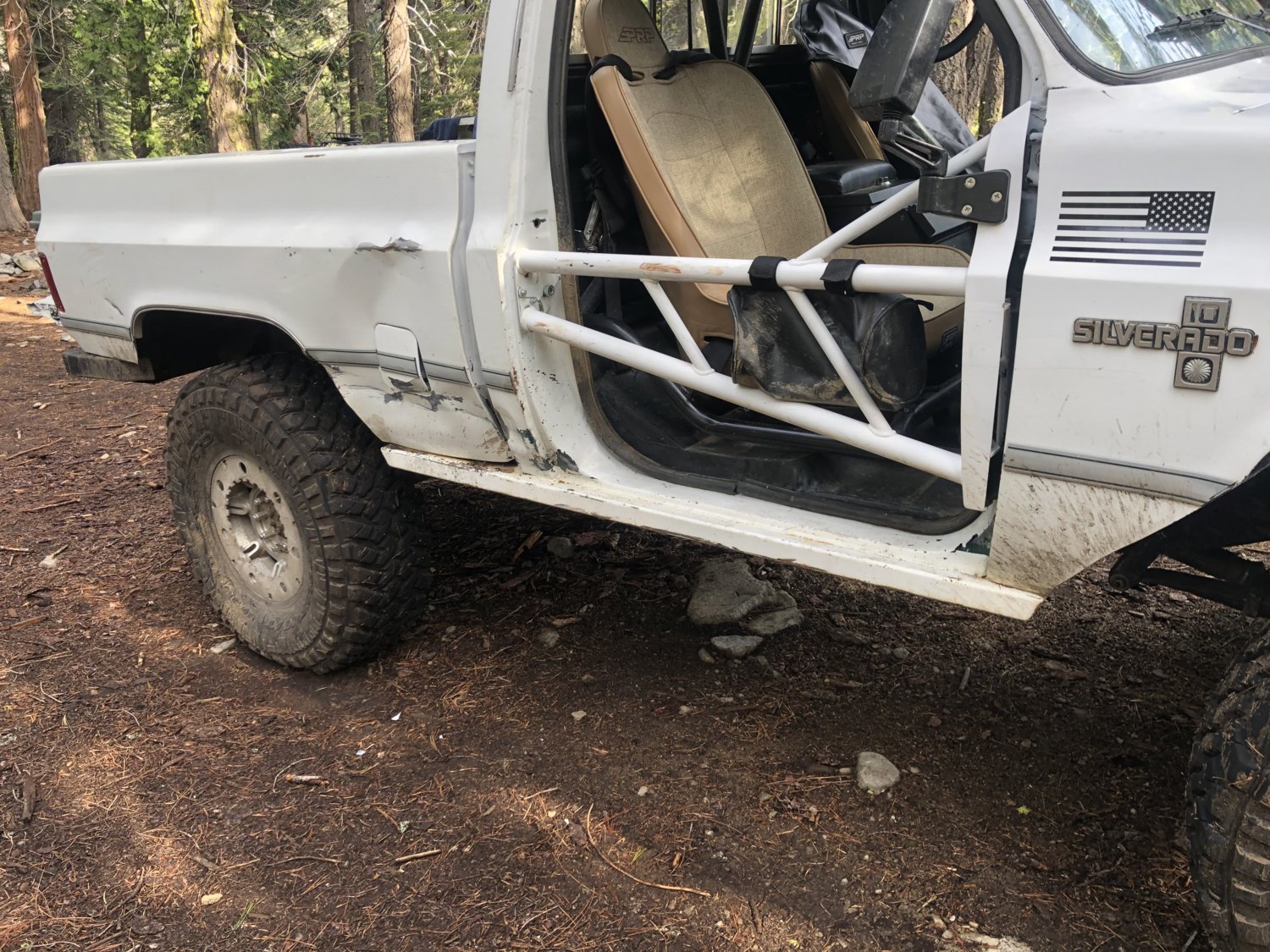

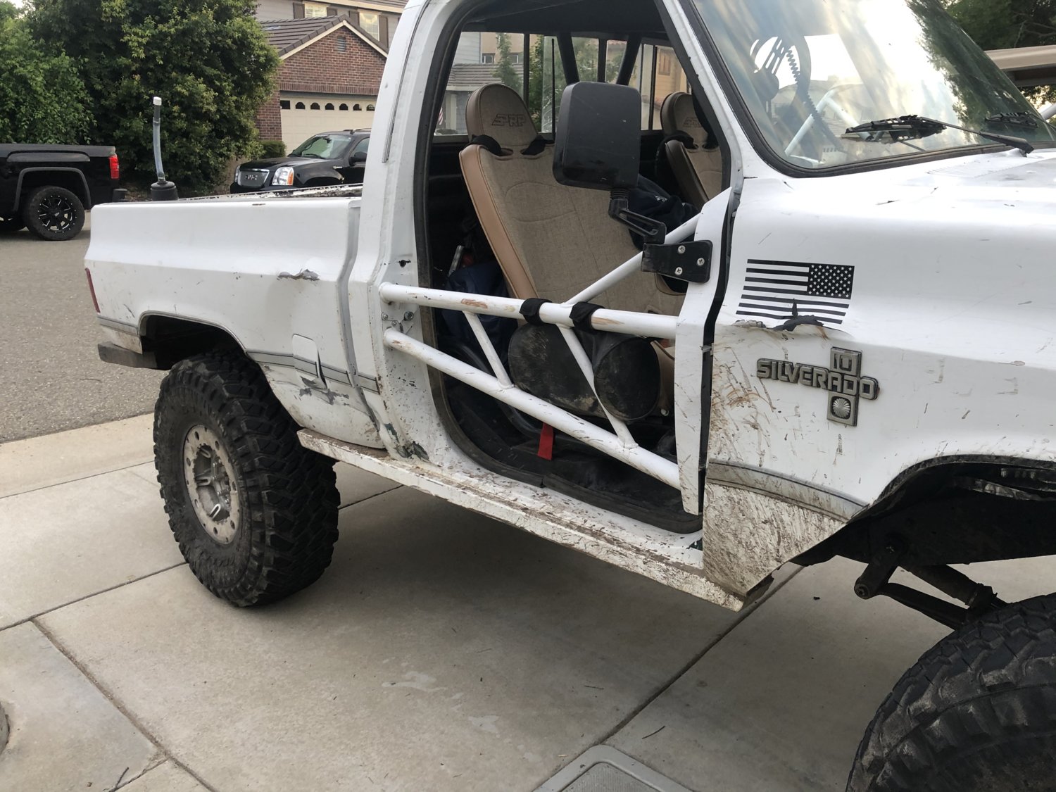

squeeze rock damage @bmxbryant9 @onetonbb74

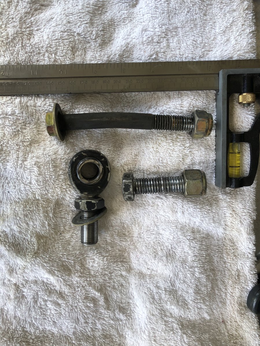

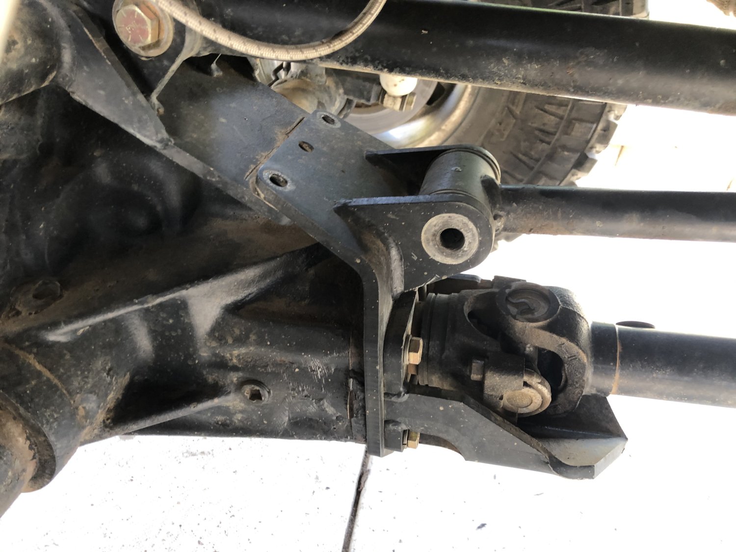

On the way out fordyce trail I noticed two bolts were missing from the anti-wrap which I thought was odd but it was possible they came loose. After further inspection I came to the conclusion that the anti-wrap was binding quite a bit, enough to bend a 9/16" bolt. I believe the 2 missing bolts were sheared off since the holes no longer align. Secondly, I apparently forgot to swap out the 5/8' heim bolt for a shoulder bolt when I was mocking up the rear suspension.
full
full

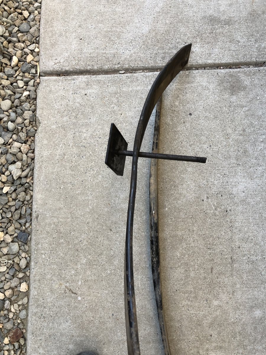

I'm pretty sure this started binding when I swapped out the 6 degree shims for the 4 degree last year when I was experiencing driveline vibes on the highway. I don't remember adjusting the heim therefore the anti-wrap was fighting the leaf springs. At least that's my working theory based on the axle position at rest disconnected from the leafs.

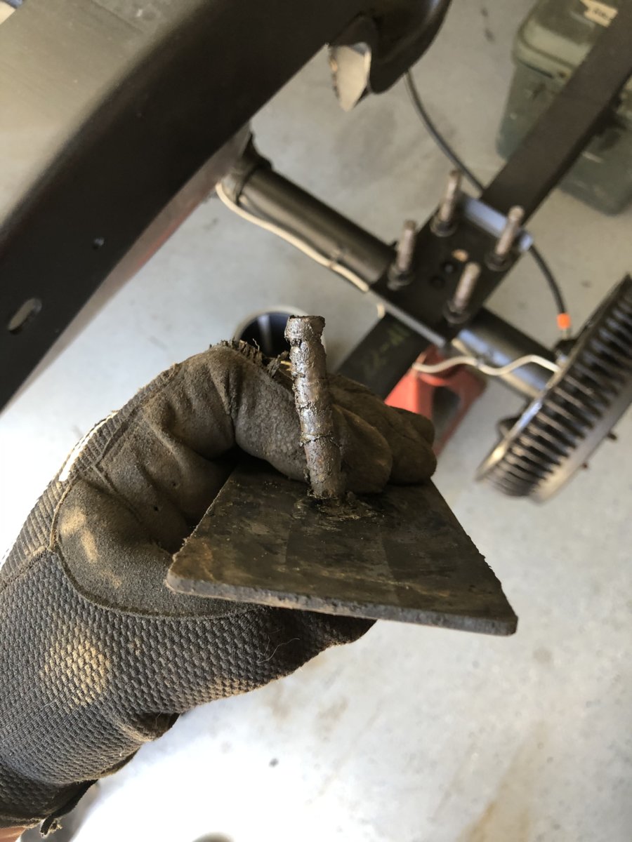

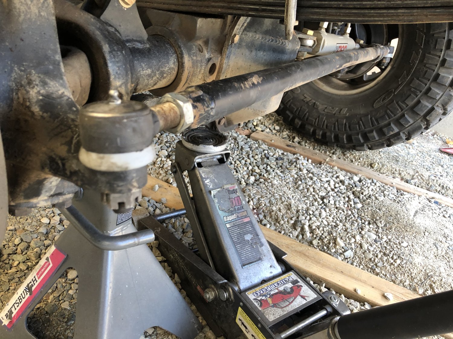

I also found a shim coming out on the passenger front (top) after breakfast on our last day at Fordyce. After I pulled I removed my bump pad from the u-bolt plate I found a snapped centering pin. The bottom half of the pin was still centered on the axle but the top half that held the top shim was broken. I loosened up the studs and u-bolt, hammered the shim back in and tightened it up. It held up fine for the 3 hours of wheeling out and the one hour drive home. I picked up some new ruffstuff u-bolts, WFO centering pins and WFO Dana 60 u-bolt studs last week. I pulled it apart yesterday finally and found a hammered center pin and my leafs are pretty well fk'd.
full
Right where the shim makes contact with the leaf it's shaped like a spaghetti noodle.
full
I was able to secure a new pair of Pro Comp 13311 springs locally that I'll pickup tomorrow. I'm interested to see if my gangster lean is cleared up with the new springs and bushings on all 4 corners.
