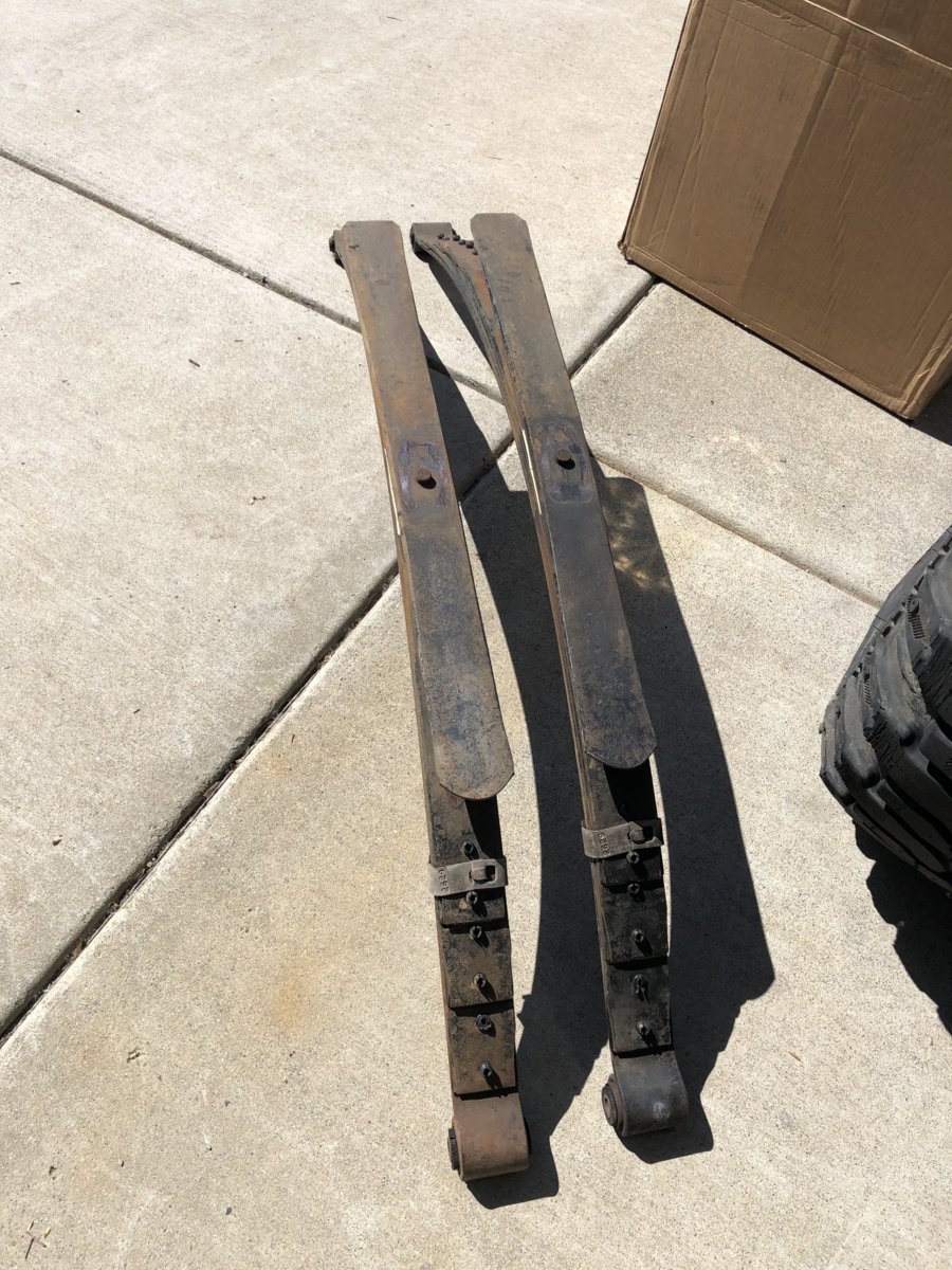

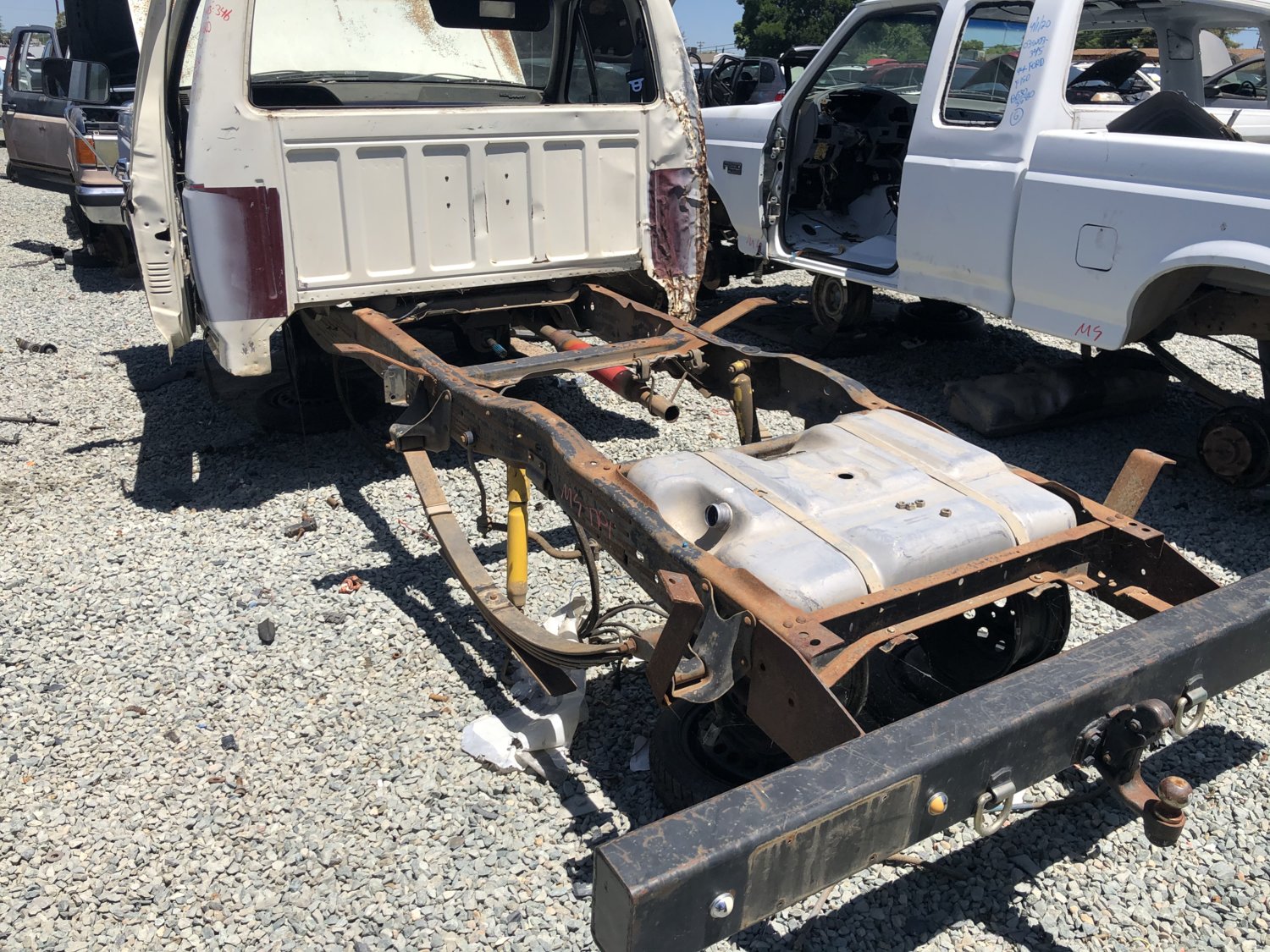

up first was the rear 57" springs which I've had on this truck since I did the shackle flip on the first frame in 2013. I found a few F150's in the yard and one in particular that someone already removed the rear axle from.

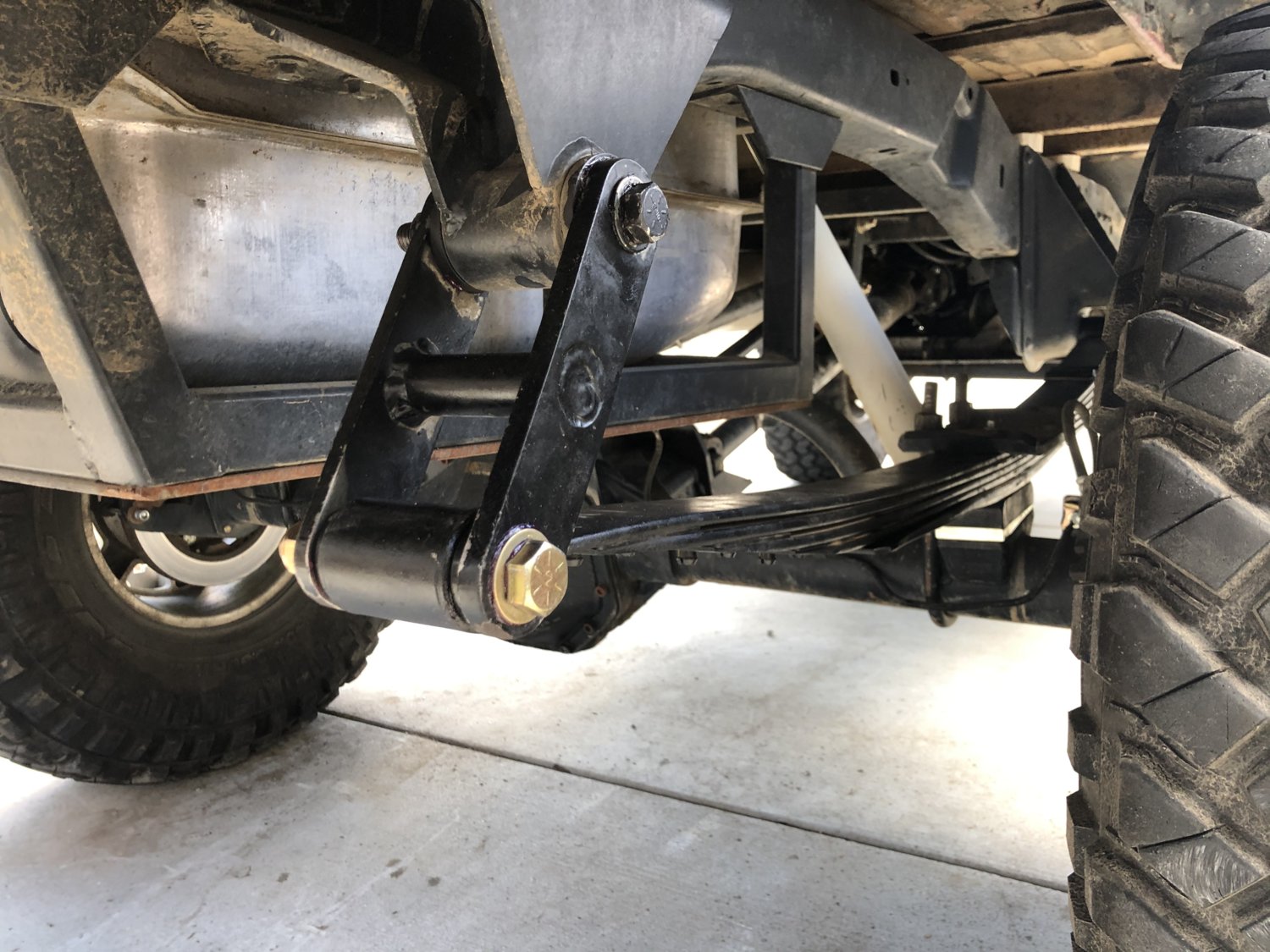

These have offset pins so I run them with offset blocks moving the axle back forward to minimize my tank skid to diff cover interaction.

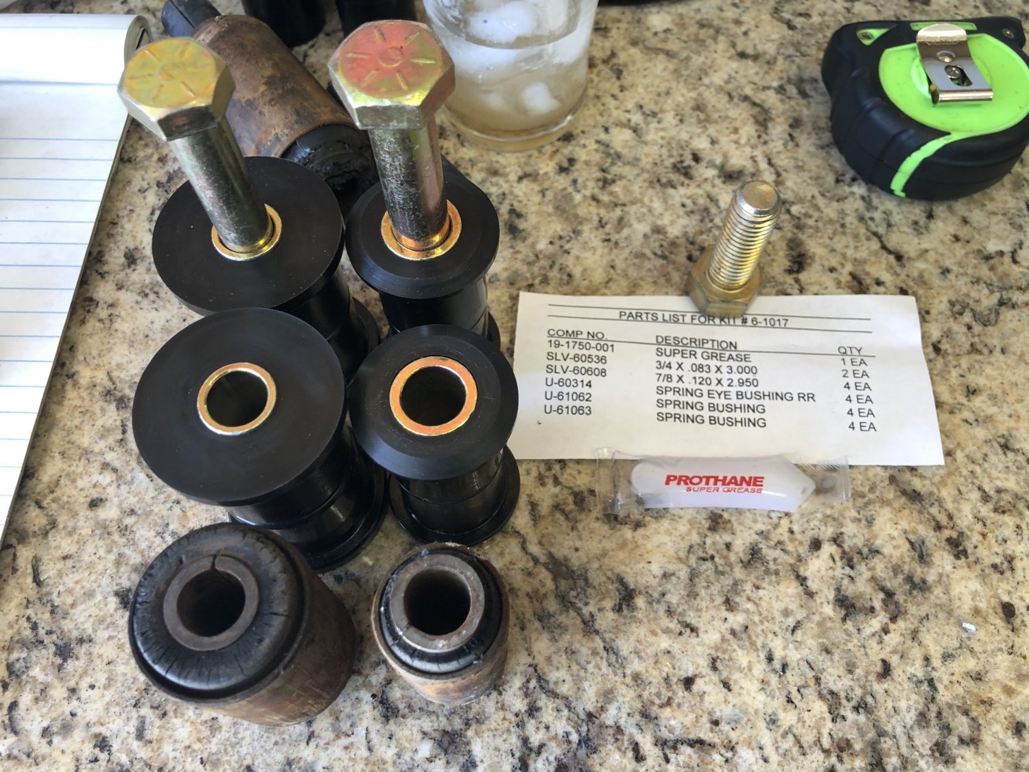

New poly bushings and the old stock ones I was running. You'll notice the rear poly bushing (smaller one) uses a 5/8" bolt rather than the 9/16" so I had to bore out the shackle a c hair over 5/8"

I also found a shim coming out on the passenger front (top) after breakfast on our last day at Fordyce. I removed my bump pad from the u-bolt plate And found a snapped centering pin. The bottom half of the pin was still centered on the axle but the top half that held the top shim was broken. I loosened up the studs and u-bolt, hammered the shim back in and tightened it up. It held up fine for the 3 hours of wheeling out and the one hour drive home. I picked up some new ruffstuff u-bolts, WFO centering pins and WFO Dana 60 u-bolt studs last week. I pulled it apart yesterday finally and found a hammered center pin and my leafs are pretty well fk'd.
full
Right where the shim makes contact with the leaf it's shaped like a spaghetti noodle.
