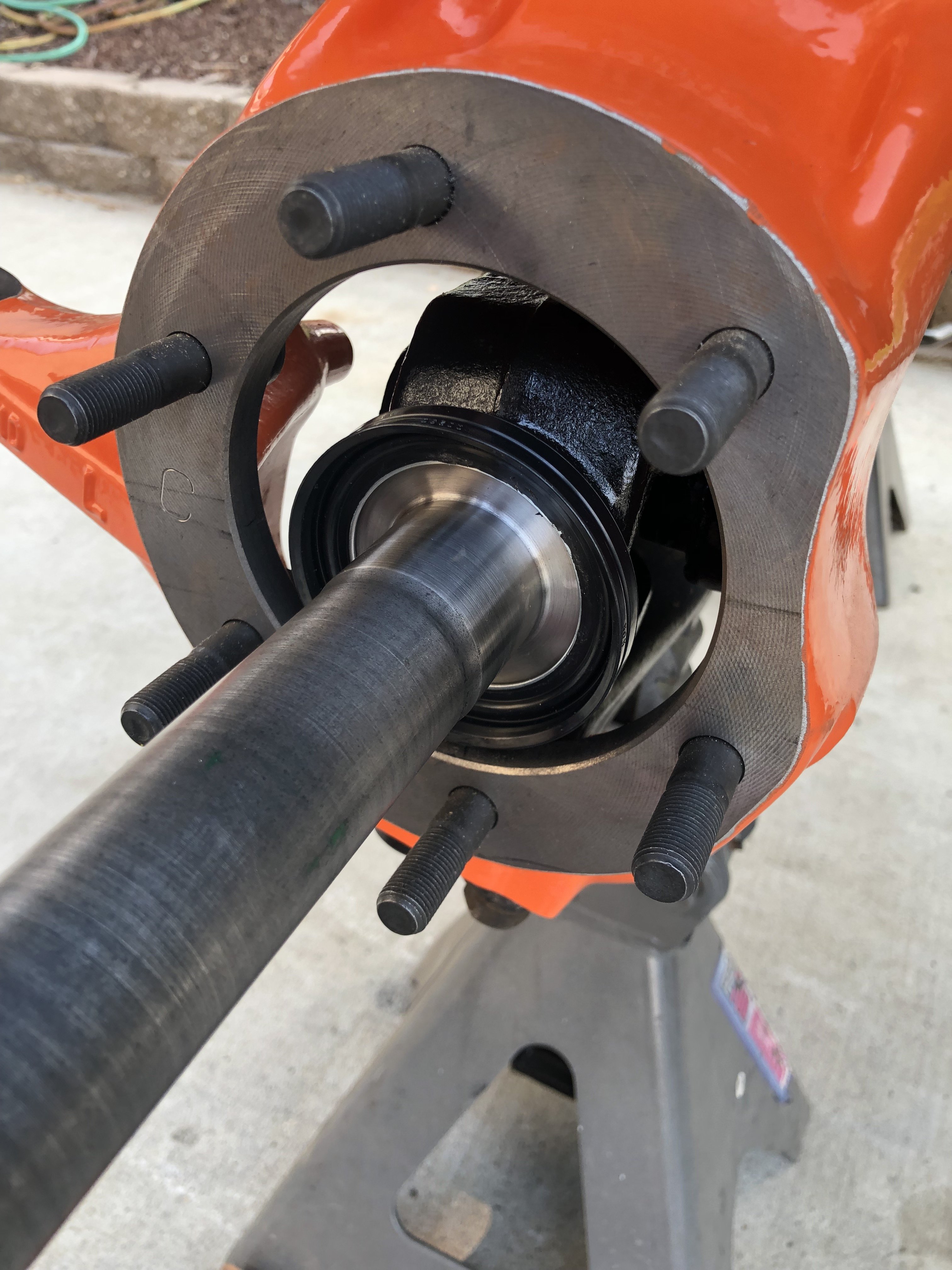

3 months later I finally got a chance to pressure wash the rubicon dirt off the truck and tear down the front axle. Unfortunately the driver side spindle is no longer round so I had to add another $500 in parts (spindle, wheel bearings and seal, spindle bearing and seal, spindle nuts). Passenger side looks fine other than the axle shaft and the bearings/seals I did last year are in great shape.
I had to use an impact to get the spindle nut off. Then I had to use the hub assembly like a slide hammer to get the outer bearing to slide off the spindle. Also had some water sitting inside this hub......

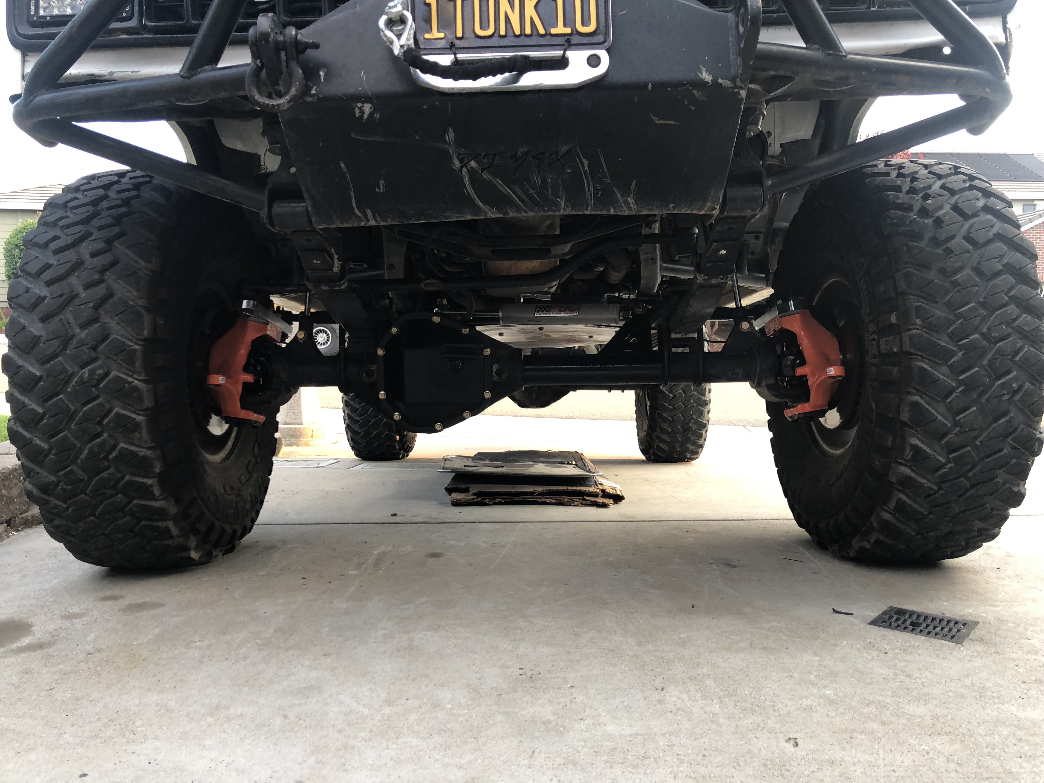

Reid's and WFO High Steer (reverse) going in too. Hopefully my tie rod will last longer than one wheeling season now.

mocked up with the WFO ram mount (5.25") and the old tierod.

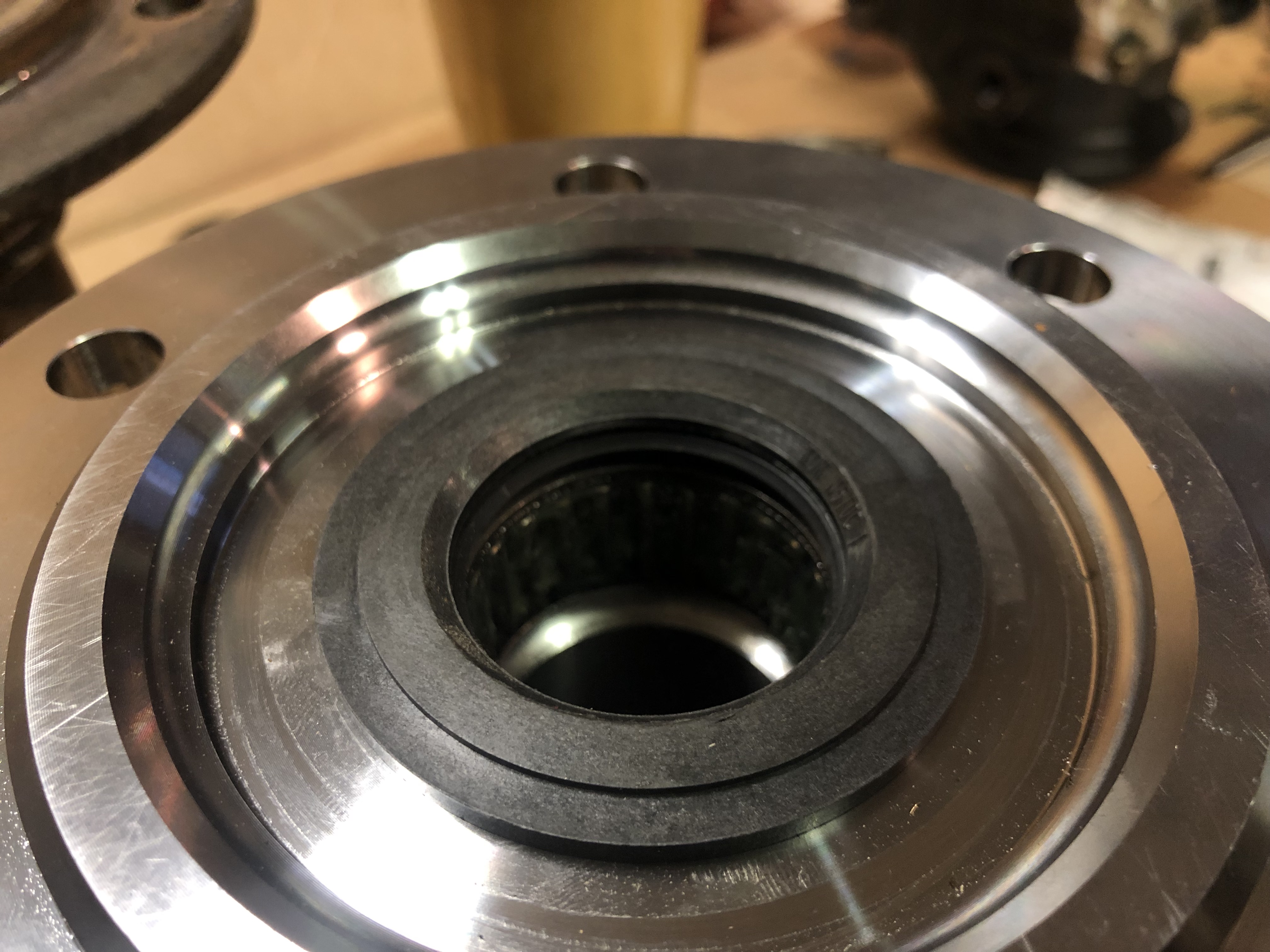

Parts Mike sold me on a new spindle seal kit that's available. Apparently this was an old spicer product they brought back and he said they seal well on his personal rig. You can see how the seal presses into the spindle housing. And then the stub shaft seal replaces the sheetmetal piece and the bronze spacer.

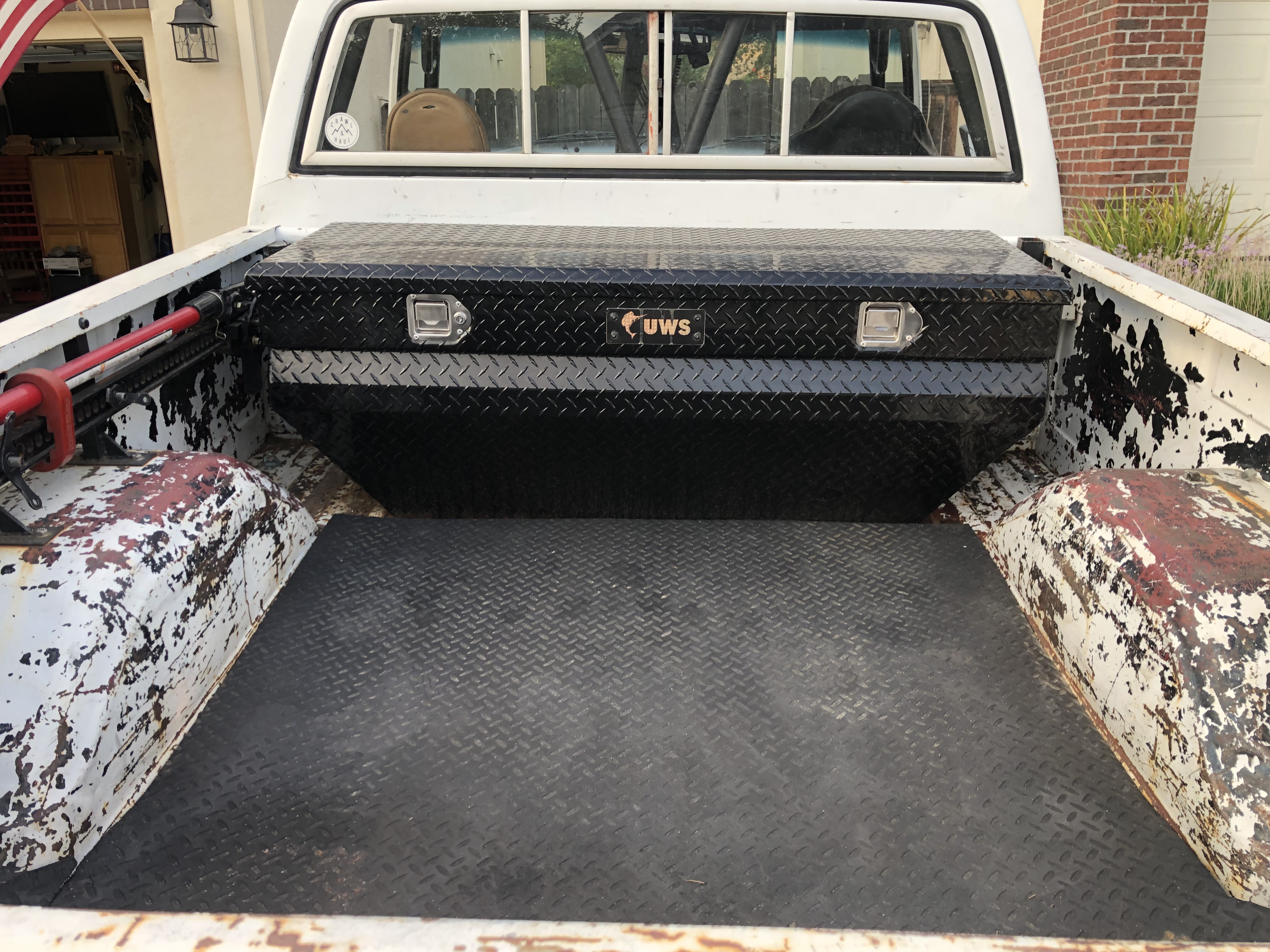

Also mounted the tool box. I need to spend a couple days building partitions and mounting my ARB compressor but that can wait. Time to go wheeling.
