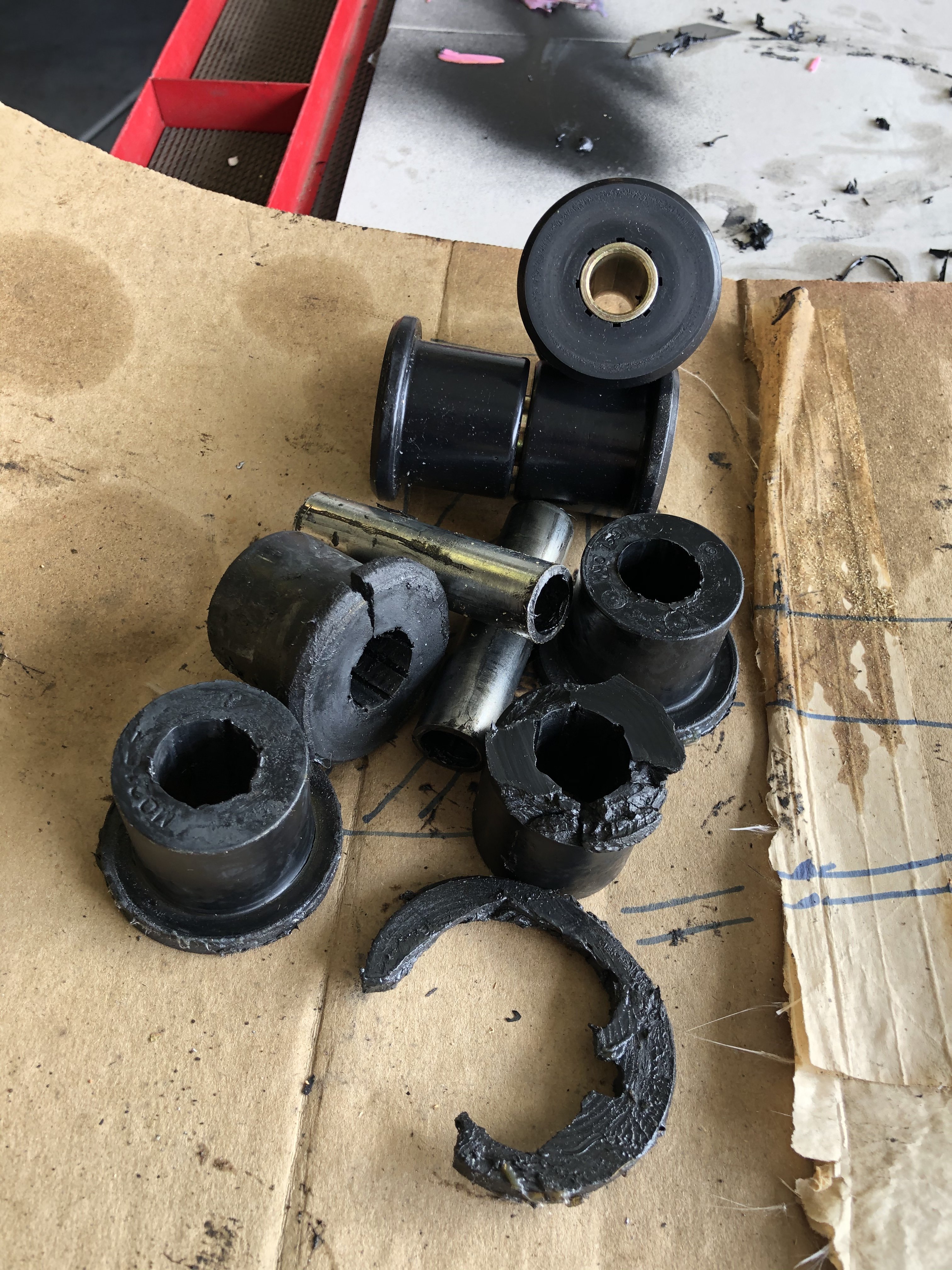

Last September I replaced the FUSH bushings and for whatever reason they were destroyed already. I’m pretty sure I used whatever bushings I had laying around (maybe ruffstuff) so I ordered some freshies from DIY4X. Below you can see the new bushings on top and what’s left of the old bushings after one or two wheeling trips.

My bushings wear pretty quick. I think it's pretty common and why ORD is trying the kevlar impregnated stuff.
Yeah the amount of flex you get is beyond any material.
You need heims or similar parts when you have that kind of movement constantly.
Rubber and poly are good for occasional flex.
The bushings are a maintenance item as far as I'm concerned and are usually replaced annually. However this last pair of FUSH bushings deteriorated VERY quickly so they must have been some type of inferior material.

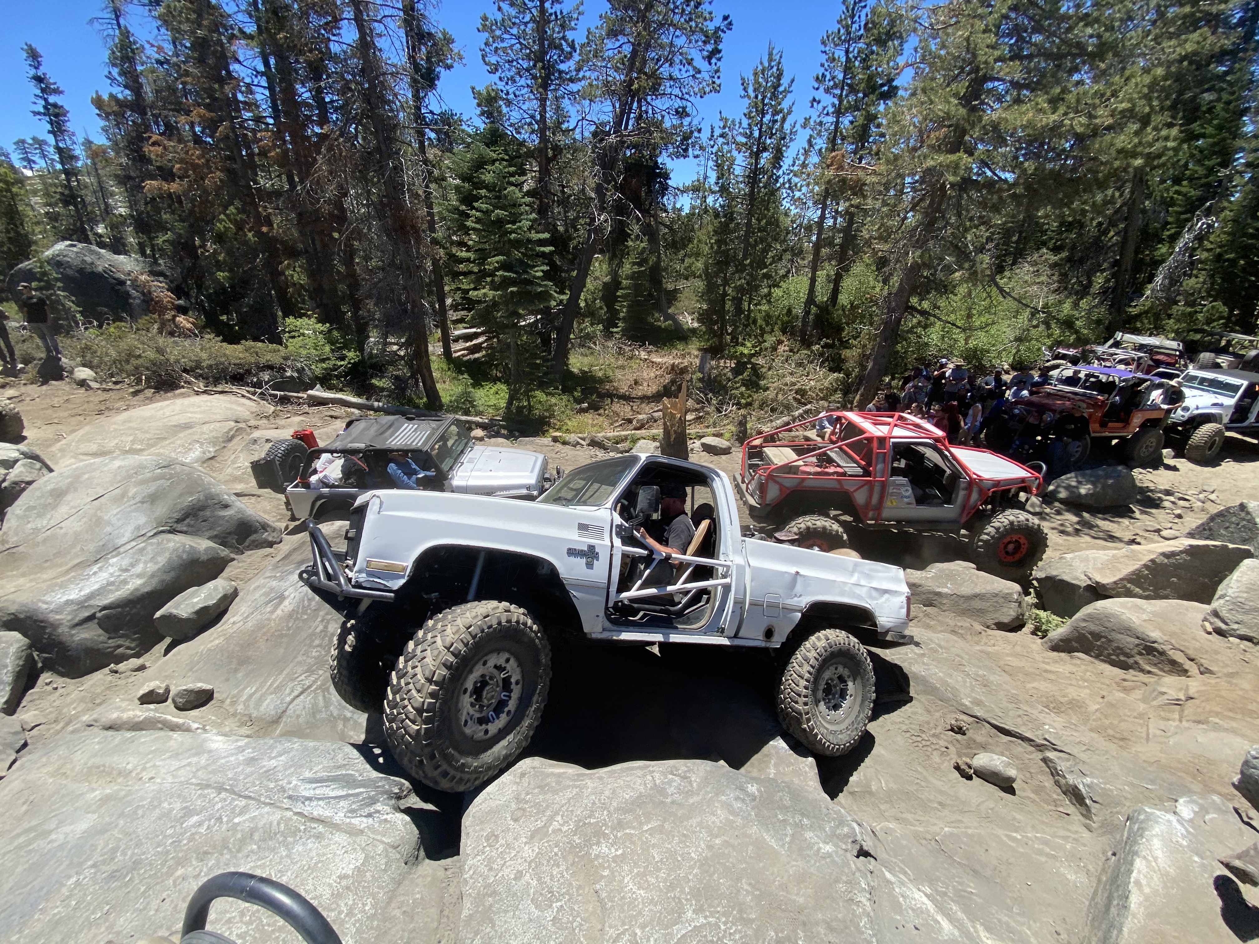

We packed up in the morning and hit the trail heading back to Loon Lake and within the first 150' from the campsite we encountered a traffic jam and within that mess was a pair of trail tampons. One of these idiots left his rig and took the keys so I followed Dean up around the obstruction on a off camber granite slab. As I turned on the granite slab with the drivetrain bound up I heard a loud pop. I figured the front output popped out again however I was wrong. Shortly thereafter I tried to climb a small ledge and heard another odd noise and it was obvious the front driver tire was not spinning.

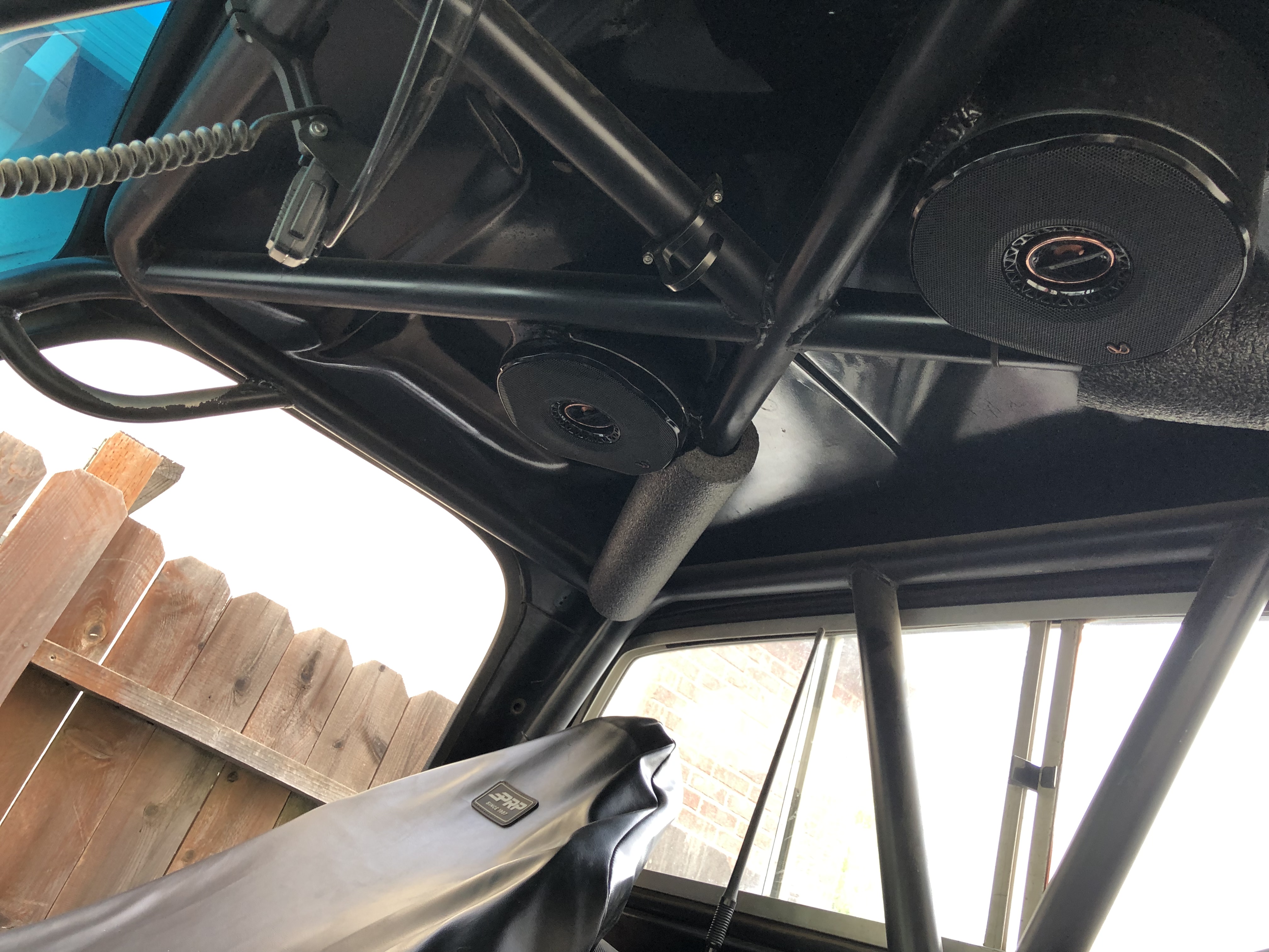

Pretty sure I'd knock my noggin right on those handles.
if that's the case you must hit your head on a lot of stuff :rotfl:
I always grabbed the halo when I got in and out of the truck but these handles are a lot easier. Most people aren't tall enough to grab the halo so the new handles help them get in and out.
