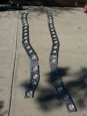

I saw someone on Facebook boxing the frame with steel that had 4" holesaw cuts in it every foot or so.
Then you could run everything inside the frame, and still access it?
Martin
Martin
There's a guy who sells a kit like that for $500
I'm not going for a completely boxed/sealed frame rails so I'm not opposed to some speed holes either.
