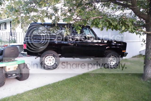

Well here's some pics with the top off, sittin on some blocks 18" high with the sway bar still hooked up. Could not get the tires to rub :dunno:. Enjoy :popcorn:

they'll be more likely to rub when its turned farther. Find a ditch to drive it down in, or a small wall around town. If you misjudge and fall off those blocks you might be doing body work anyway:whistle::D
AHHHH YEAH!!!! That looks awesome man!!!:thumb:
I feel much better now by the way lol.
You've given me the motivation to try and find a spot to flex out tomorrow... thank you sir :D
